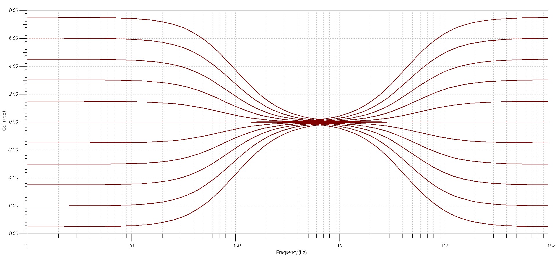

First, the range of adjustment is limited to +/- 7.5dB using 1.5dB switched steps, I can't think of any reason why anyone would need the 15 to 20 dB boost or cut that most controls provide. Using rotary switches instead of pots also avoids the inter-channel variation thing, and allows using a center position to ground to completely disable the tone control action when it's not needed.
Second, instead of the usual 1kHz center point, I've put this one around the mid-600Hz range, which is actually the middle of the audible range of the Human ear.
Third, the slopes are shallower, which makes the adjustments much more subtle but still effective, and also causes less phase shift. There's also a provision for adjusting the turnover frequencies if desired. The final result is a tone control that is usable and won't cause more problems than it solves.

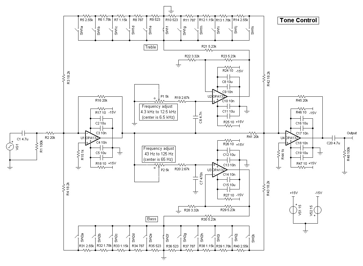

Below are the frequency response plots, schematic and bill of materials.

Woops, I just noticed that I put R1 on the wrong side of C1. Oh well, can't be perfect all the time.

Looks pretty nice but is the step size a little coarse?
G²
Stratus46, the main reason I went with 1.5 dB steps was because I found that it seemed like the best compromise with the shallow slope filters. No reason one couldn't use more steps if desired.

OK, here we go... I built this several years ago, and I'm writing about it from memory, but it's all good, nothing at all difficult about building one. I put the dual OpAmps and surrounding circuitry consisting of the power supply decoupling components, the main signal path resistors and the first order high-pass and low-pass filters on two small PCBs, one for each channel. The two switches are single pole, eleven position, make before break (to prevent switching noises), dual deck rotary type with the cut/boost resistors mounted directly on the terminals. When I built the first prototype I just used a bunch of cheap slide switches I had on hand in place of the rotary switches for testing purposes. Not much else to tell really, like I said before, it's a pretty simple circuit and a relativly easy build. Just use good circuit layout and construction techniques, and decent quality components and you'll end up with a good sounding, usable tone control.

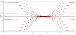

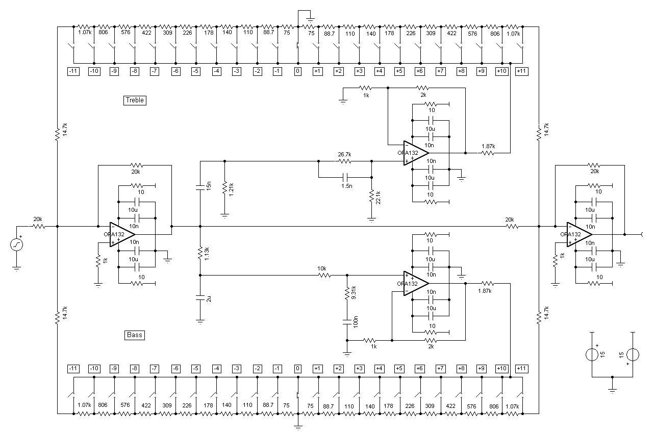

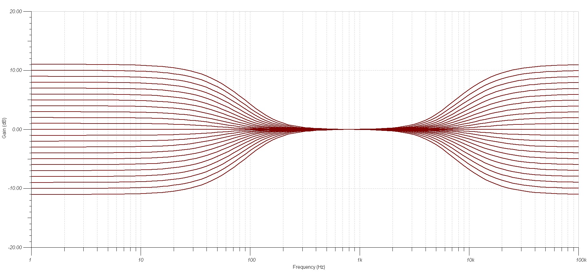

I've done some tweeking to the circuit since my last post. It now has a cut / boost range of 11dB in 1dB steps. But what's even better in the new and improved version is that it now has accelerated slope filters based on the work of Dennis Bohn at Rane Corp (Here: http://rane.com/pdf/acceler.pdf.) That type of filter will allow bass and treble adjustment while leaving the mid-band untouched, and it also produces very little phase shift while doing it's thing. Attached below are the schematic, frequency response curves, and a working model in a zipped TI Tina file.

Michael, that looks a very useful circuit!
Your timing is perfect too; I've just come here looking for a way to add an automatic loudness control to the preamp I am designing. I listen at low volume most of the time due to marriage.
Long story short: My 25yo Technics amp is beyond recovery, I'm a digital guy mostly and I'm trying to build a replacement amplifier using parts in my spares boxes if possible (I've no money, due to marriage!). Despite the amp's humble beginnings, I'm now thinking of using a microcontroller to control it all digitally.
Looking at your circuit, I think that I could replace the boost side of the base and treble sections with two 20KΩ digital potentiometers, with the wipers paralleled to ground with 5KΩ resistors. Since I only need to boost for a loudness control, the other side of the resistor chains could be replaced with a 4KΩ resistors.
That way, I would have about the same range of adjustment on the boost side as your circuit, with the 10-bit digipot scaled appropriately in software. The idea then is for the MCU to automatically control the amount of boost based on the volume level.
Do you think this is a reasonable idea?
