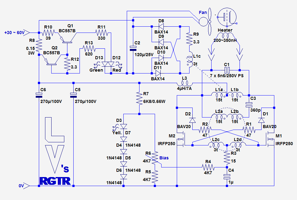

Since I have a large stock of used tubes in various conditions, from NOS in the original box to (very!) well used, I felt the need to equip myself with a stable and reliable device for regettering: some of my samples have a bad need for such a treatment, and although I managed to get results by cobbling together an improvised oscillator, it was neither safe nor practical.
Here is a description of the low-cost machine I devised.
It is essentially a Royer oscillator, but with a number of refinements making it universal: the coil head is interchangeable, making it compatible with all sizes and geometries of common tubes.
The electrical output parameters can also be varied in a wide measure, making it practically universal.
I also made an attempt at an aperiodic power driver, essentially a half-bridge driven at HF, and it worked, but the burden on the active elements was immense, due to the fact that the load is mostly reactive, due to the poor coupling between the heating coil and the getter ring.
In the end, I opted for the sensible solution: in a Royer, most of the reactive part of the load is taken care of by the tuning capacitor, easing the burden on active elements.
A regular Royer requires a coil with 5 or 6 connection, which is not practical.
I therefore modified the initial circuit to arrive at 2 connections, which is obviously the minimum possible..
The resulting circuit is significantly more complicated, but it remains manageable, and it is completely safe, deterministic and reliable.
It is possible to make a 2 terminal Royer oscillator much more simply, but it is neither safe nor reliable: relying on direct cross drive from drains for feedback is a recipe for disaster if the oscillator stalls.
With inductive feedback and controlled bias, there is no such risk.
Here is the base schematic:

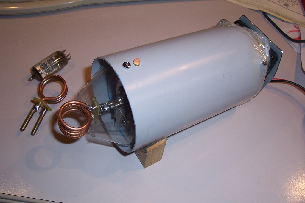

Here is the outlook of the finished instrument:

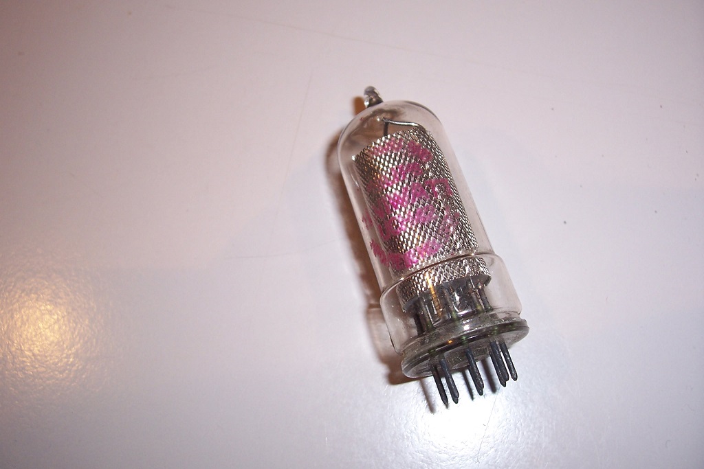

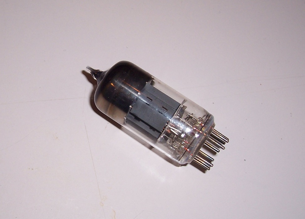

Here is an example of an UCH42 having initially its getter completely spent:

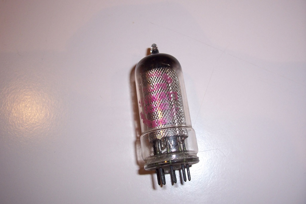

Here is the same valve after treatment:

This treated getter will works how long?
It will last no longer or shorter than the original. Of course, since the initial one has been depleted, it means that gas can find its way into the envelope, and the new layer will continue to react in the same way.
The amount of "green" getter material initially introduced within the getter structure is vast compared to the tube needs: even a µg or two would be large, considering the high level of vacuum inside the tube.

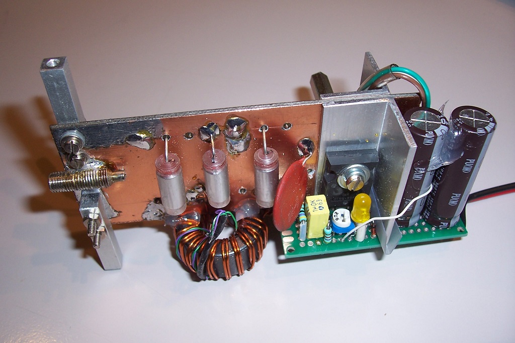

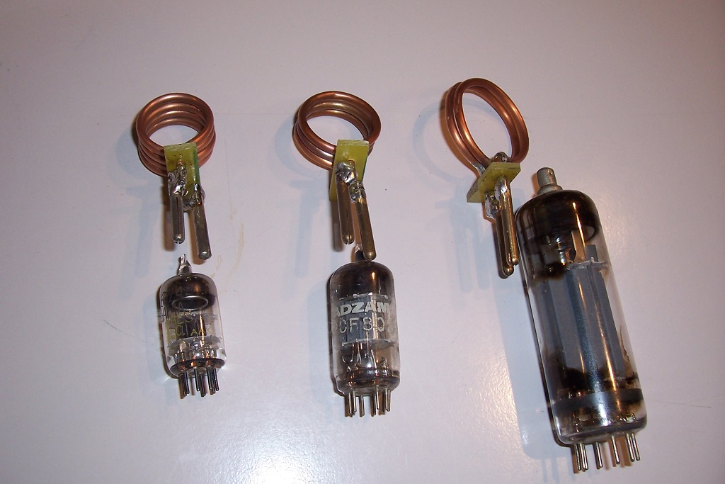

So far, I have built three coil heads, corresponding to the most common sizes of tubes:
attachment.php

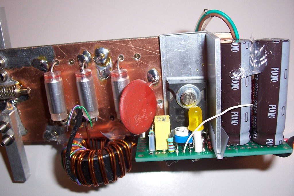

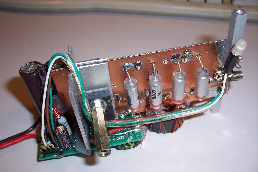

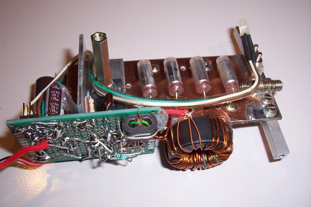

Here are some pics of the innards:
attachment.php
attachment.php
attachment.php
attachment.php

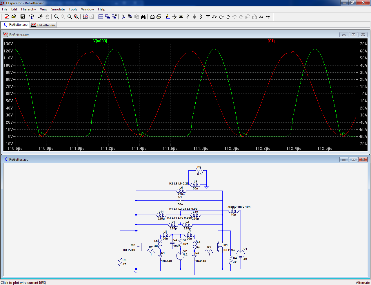

What frequency does it run at?
Around 1.5MHz, very approximately

Here is an approximate sim of what's going on in the oscillator. The real circuit performs better, fortunately.
L6 is the heater coil, coupled to the getter ring L9, symbolised by a turn shorted by a resistor, L11 L10 is the feeding/symetrising autoformer, and L1 L2 L4 L5 is the gate drive transformer.
Initially, the gate windings were taken directly from the power autoformer (as can still be seen on the pics above), but the leakage inductance was excessive: the circuit is extremely dependent on a minimal gate inductance, and I had to add a specific low-power transformer, built on a two-hole VHF ferrite core.
The three secondary turns are embedded in the middle of the primary winding, and a series capacitor of 360pF (not present in the sim) compensates for the residual leakage.
