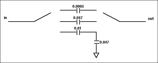

A rotary 3 position 3 pole switch. In one pole, through a cap out the other pole, no bleeding from one cap to the other.

See the drawing for the tone switch... I'm still working on the bass boost. The one there is still a bit bright.
Lastly: No one has answered the question...
A yes or no answer would be sufficient. If yes, a link or a drawing to back it up. If no, well, that's what I am presuming by asking the question that way...
It should not make a difference what type of amp it's for. Tone is a control that does one thing, adjust tone for any type of amplification. And since this is in the Instruments and Amps category, one should assume it is for an instrument amp. Bass, guitar, keyboard, or PA, they are all the same when it comes to adjusting the tone.

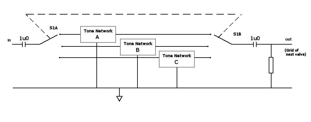

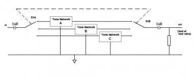

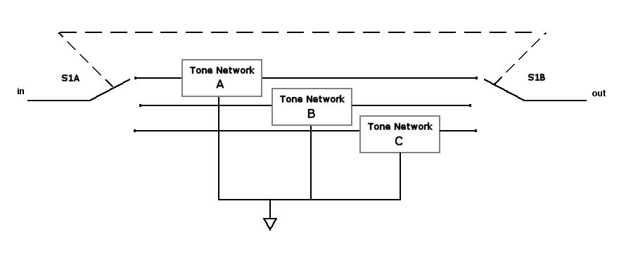

I've looked at your 2 pole three way switch circuit, it won't do what you want I'm afraid.
However, if you think of three completely separate circuits, with your 2 pole three way switch selecting from three possible inputs and three possible outputs, things start looking much brighter.
Like this:
So what you've got is three tone shaping networks, only one of which is in circuit at a time. What you need to do now is to work out what you want those networks to be.
There are two VERY IMPORTANT provisos:
Don't let DC level enter your switch at least on the left hand side (or switching will be something unforgettably ear-splitting)
Make sure that the valve you're connecting the output on the right hand side to has a constant value DC path to ground.
So what you end up with is actually more like this:
The cap on the input will will need a high voltage rating, the one on the output not very much.
Let me know what you think of this - it gives you opportunity to think about the tone networks independently - once you've got one working the way you want, the others can follow on later.
You're onto something that I think is a nice idea to get your amp working the way you want. Don't electrocute yourself.
