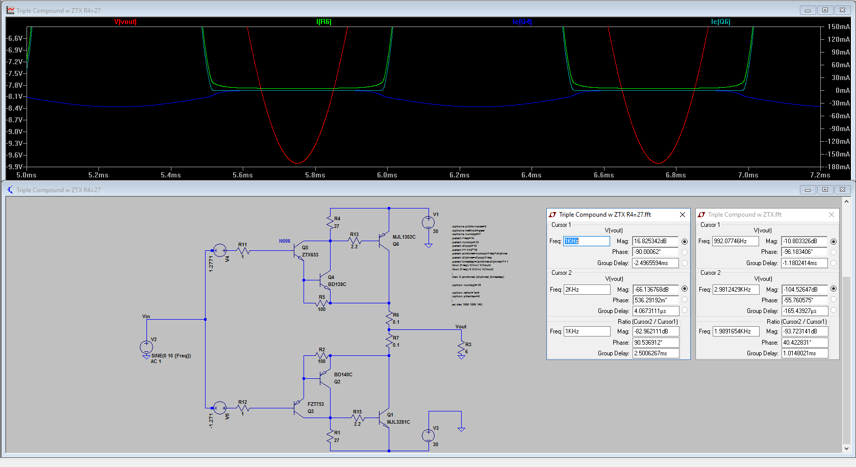

I have changed the model and someone might like to point out its flaws, but it was quick and easy. The bandwidth has gone way back up (to 94MHz) but I also fear there's a flaw in the BD139/140 models. I don't know the parameter or how it works (XTF) but the value seems odd. I have got some other BD models and may standardise on the LT_Wiki standard.bjt.
I can post the circuit and the crossover behaviour as it is currently (and on that if you lower the driver current the period of flatness more than halves, rounding off at the sides.). The driver current also looks that much less nimble. Incidentally the driver current is actually positive, though this way up separates them out better. So driver + output current does equal Re current.

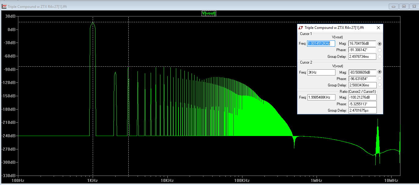

Pictures and asc as interim.
Sorry, forgot to press Upload.

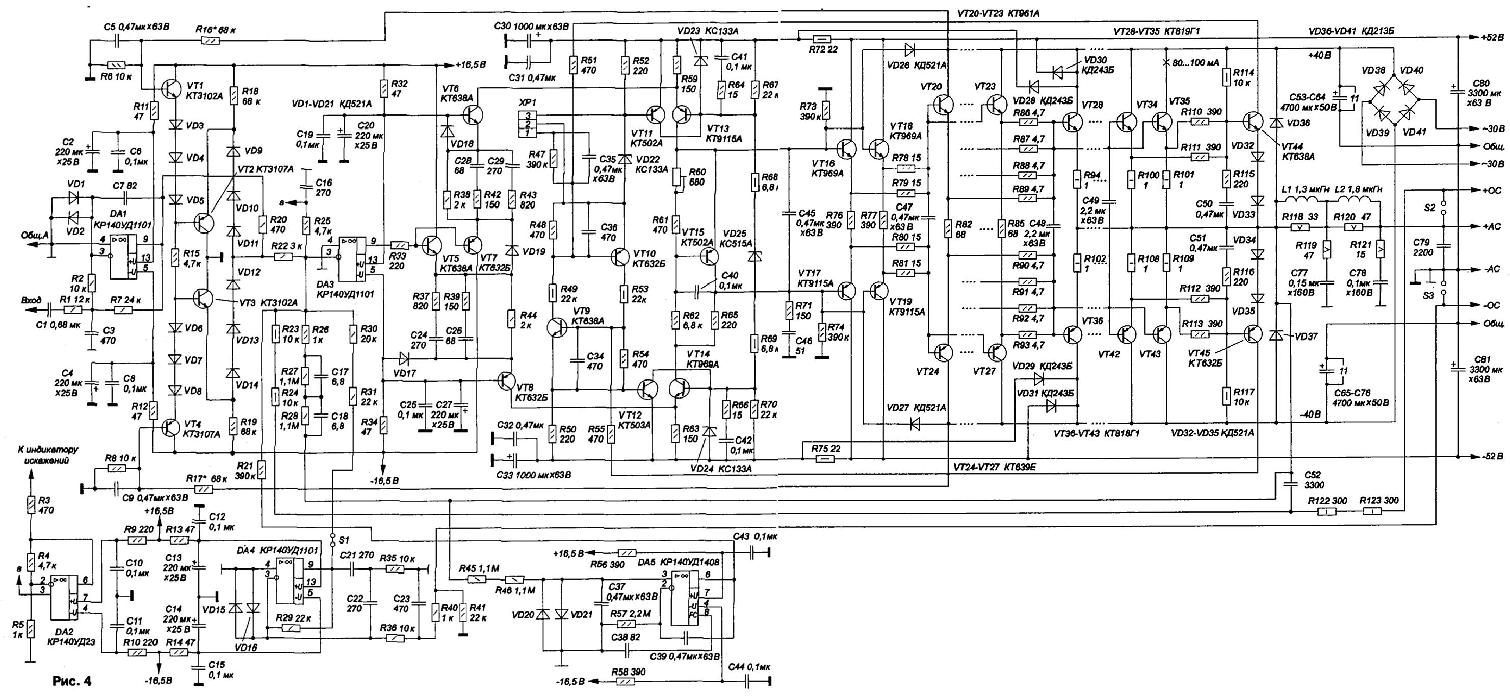

Hi!I would like to see a modern output stage which does something against the typical problems: beta droop at higher current, gm-doubling, early effect, SOAR limitations at higher voltages, non-linear C_CB capacitance in the driver and bias current temperature dependency.
Here is a diagram of the amplifier, where it is all taken into account and taken measures to avoid these effects. This amplifier was built 1999 year our specialist on measurements in nuclear physics.
The first stage of the follower has 2 transistors on the shoulder - VT16, VT18. The second stage (the driver) has 4 transistors in the shoulder: VT20 - VT23. The output stage follower contains 8 transistors.

You will have to get other advice about the sim files for BD139/140 that is not my thing, however the bandwidth of the complete amplifier will be limited by that of the output devices and changes in phase due to time delays caused by stored charges in the base regions of the output devices. These persist after the signal voltage has been removed.

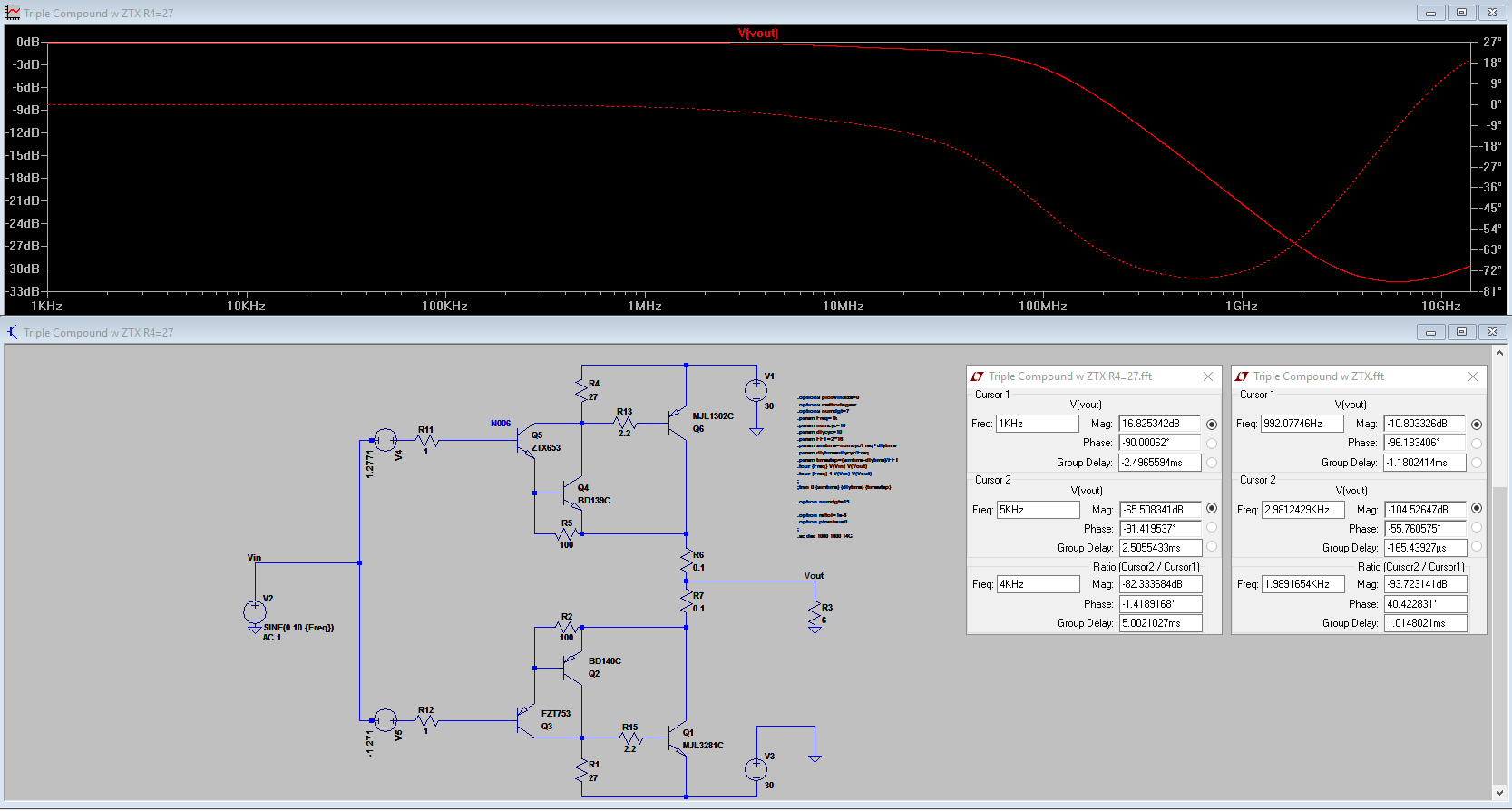

As a general rule the frequency response of the voltage amplification stage has to be rolled off well below the frequencies you have been looking at. Pushing the bandwidth of the drivers I see as barking up the wrong tree.
You should be looking at current available from Q6 to charge/discharge the base of the power transistor - Cordell gives a formula to calculate that requirement - there is an article on his website entitled "Another View of TIM" giving the details.
When you have sorted out this detail then you can see what value resistance you might need for R4.

I see what you were getting at. I had changed the circuit to get a low impedance source and to get rid of the 47k resistors and that possible path. It was just a quick thing so I could get a proper look at the input (which is just about on 0dB, bar some capacitance) and keep the output stage in isolation. You can see it on page 9.

I have a problem with the SPICE I downloaded - I have been meaning to get my IT worker brother to look at this.
The stored charge issue relates to Q6 - PNP transistors present a little more difficulty than NPN - you can look up this point on the net.
Re changing the emitter resistors to 0.1 ohms and reducing the standing current below 50 m.a. - I see that as a move in the wrong direction.
Re bandwidth limiting - the inverting input where the feedback connects provides a path for signals to re-enter the amplification process. A speaker is a electro-motor.
If the closed loop of the amplifier has a gain of one at any frequency that is positive in phase it will oscillate even with no signal input or load connected.
The phase changes from positive to negative at 180 degrees but some safety margin is needed to guarantee stability. A rule of thumb is to reduce the gain to less than one at a frequency of 135 degrees.
The only effective way to achieve this is to by "compensating" the main voltage amplification stage.
Greater closed loop bandwidth comes at the cost of some compromise with stability.
If you push the closed loop bandwidth there will be an increasing risk of instability beyond 100 kHZ. This is due to the relative sluggishness of power transistors.
As long as your driver stage behaves within the chosen closed loop bandwidth that is all you should need to worry about.

If the closed loop of the amplifier has a gain of one at any frequency that is positive in phase it will oscillate even with no signal input or load connected. The phase changes from positive to negative at 180 degrees but some safety margin is needed to guarantee stability. A rule of thumb is to reduce the gain to less than one at a frequency of 135 degrees.
Yes, I am aware of the basics of feedback. Have you looked at how little phase shift this circuit is managing - albeit in simulation? What appears to be happening is that rather than showing up as inductive impedances at the output and being a cascade of 3 separate poles, they aren't even managing the shift of a single pole. I will get to the bottom of this, but what one doesn't have is that sharp phase shift at the beginning of rolloff. I suspect that there are capacitative routes to the too of the emitter resistors and these actually send the phase back towards zero.
I disagree. From work that I have done on regulators a Miller cap is death to actual regulation. The same holds true in an ordinary amplifier. There are all sorts of places that movement in the rails finds its way onto the signal, from the Early effect simply dropping it there 70dB down, to PN junctions which will do it 0.6V down. And, no, a current source does not stop a voltage change on the rails appearing in the signal. One needs to maintain the same loop gain right across the band of interest. Then, since you were talking about it, the signal fed to it should be at a level such that the loop gain available to it is maintained or bettered even while the amplifier is losing its OLG.
Well these aren't 2MHz devices. They are at least a decade out beyond that. The hope of using a CFP in this or the sandwiched arrangement is that the geometric mean effect on the ft means that they will behave as a single device that outperforms the relatively sluggish power transistors.

Yeah, I did. I don't do this all day every day so I can be a little less than precise. (In all fields, as it happens. ) In fact I haven't looked at circuits as in depth as this in a couple of years.
I replaced the BD139/140 model with a model of the Fairchild version from the LTWiki standard.bjt. It seems to perform fine though I couldn't make it identical because that bjt file didn't have the ZTXs that I was using earlier. So I did an upgrade to FMMT624/723. They look a cracking pair of transistors. Bandwidth goes soaring out to 160MHz and everything still very well behaved. Of course one of the jobs will be to try and upset it again and the first stop will be the MJE243/253.
But so far, for the little work done today, it's looking promising. With a lower standing current of 15mA in the the main transistors and the 10R reinstated, we have the rather odd position of 50mA going through the drivers while 15mA goes through the output, but it's giving -100dB as the worst of all the distortion components. (There are a few of those and a few 10dB, or a third, below but it's still two zeros.) Since no one will believe me I enclose the FFT.
