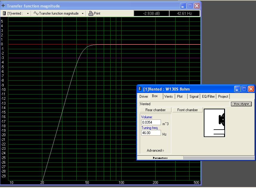

PS - the woofer I have chosen is the Visaton W130S 8ohm, which would give me an f3 of 42Hz in a 35L cab (for both speakers), and I'll mount them push-push. Frequency response attached.

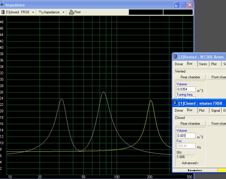

I might have a bit of an impedance problem.
The peak furthest right is the FR driver, and the large spike around 150Hz could cause trouble (an octave down on XO frequency). What might be done to sort this - I'd prefer to use a sealed box, but I'd be open to an MTL if this would help significantly.
Am I right in thinking that the two peaks furthest right (the woofer) will be OK for a LP filter at 300Hz?
I don't know a huge amount about crossovers
Thanks in advance
Chris
It is actually more complex than that. You have to design with consideration of the impedance within a couple octaves of the XO point.

I've been thinking and talking to Dad about this - he has 3 options - new XO point, flatten impedance electronically, or just ignore the peak and hope it sounds good.
Revisions to the crossover can been made - the new XO will be around 400Hz, 2nd order for the woofer, 3rd order for the FR driver.
I checked the dispertion etc of the woofer, which is fine to 1kHz (2pi dispertion).
I've also considered an MTL system to sort out the impedance peak, but this would be a last resort really...
Any other ideas?
Chris

At the start of the thread, you suggested a MTL to flatten the impedance - would that help here? I noticed the impedance spike isn't as bad as with your driver, which goes past 80 ohms.
attachment.php
The red curve is unbaffled. The blue curve is in the aperiodic TL. Much flatter. I'm sure it could be flattened more, but we haven't taken the effort yet because we were bi-amping.
