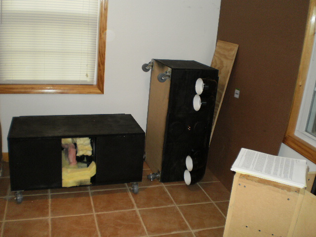

I am finished and not very happy with the results. Granted, I did not follow any published design. Mine turned out to have a sonic signature of which I can not live with. Sort of like a thud thud thud quality. I can only speculate as to the reason(s). I think my plenum is too wide. IE the drivers are too far apart. Plus, I used 12" woofers, and I think most before me had used 15 inchers. The reason my woofer mounting boards are so far apart, is, because
I wanted the exit area to equal the SD of the drivers. Might have been a mistake. Worked on these bastards alll summer, and all that work is for naught. One pic is up close, and the other, of them finished and parked out of the way.

Yes, the bass reflex aspect was followed to the letter. Most ppsl's you see are of a taller cabinet, a smaller plenum, use 15 inch woofers, and have rectangular ducted ports of who knows what depth at the bottom of said cabinet. It's also a shared volume. Mine were independent back enclosures.

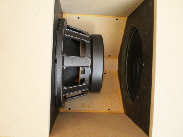

The actual structure can be salvaged: My first thought was to simply front
mount the 12's. But further research has led to the suspicion of 12's qualifying as a decent woofer size (?) If I take and dissect the very center of the cabinet where the plenum is now, and add another thickness of 3/4" stock over the front panel,
I could barley, just barely, fit in my 15" pro woofers. I need to mention these were supposed to be for mid bass operation. 60-380 Hz. Somewhere else in the forum I read where one poster said 2x15" per side gives very effective mid-bass. (I'm using one 15 per side now, in a sealed box) It's very smooth, very musical, bit lacks the last word in an ultimate "punch" quality.

Boscoe Is that a small slot port or no?
I hope it was something simple Scott. I have alot of hope for this design so hopefully yours works out or DJK can tell you what it was.
Yes two either side.

scott, did you ever crunch the numbers of what those 12's would do in either a sealed or ported box ? Those magnets look very beefy for a 12" (not much low bass). The width of the plenum is fine to me. 2 x 12" = around an 18" driver.
If you list the manufactorer's qts, Fs, and Vas, we could get you some box sizes.
I think you said it was ported, to what frequency ? You did wire the drivers out of phase (the push pull), right ?

The back volumes are 1.8 ft^3 per driver, tuned to 50Hz. I get response way down to 36 Hz, and from what i have learned, it's because the plenum front loading of the drivers throws off the otherwise standard Thiel/Small calculations.
I should indeed try front mounting those (built like a tank) 12 inchers, just to see what they sound like in a conventional box.
To all others: note the large bump just above 200 Hz in Boscoe's simulation.

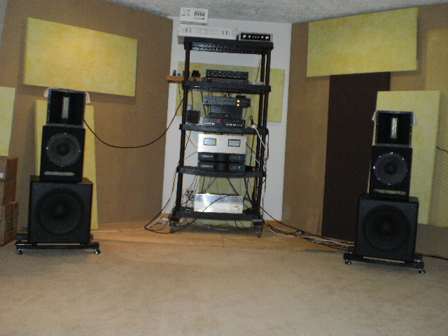

Do you have any more pics of this build or atleast the bigger pictures showing the whole cabinet?
perhaps here is some inspiration.
Yes, those are 18's with a 12" diameter port.
It is worth it.
Norman
I'm not sure what else you want to see............
I have no pics of the build (like 6 years ago), but I could get more pics (they are next door to me). If I remember, they were 48" wide x 36" deep x 22" tall. Again if I remember, it was either 16 or 18ft3 tuned to 27hz. The drivers were not in seperate enclosures, they shared the giant box.
Actually, in the pic, I can see the mdf splitting... oh well...........
