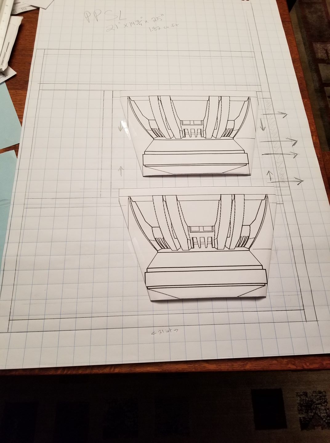

How about this design?
(the "spine" is would not be blocked as the drawing appears)

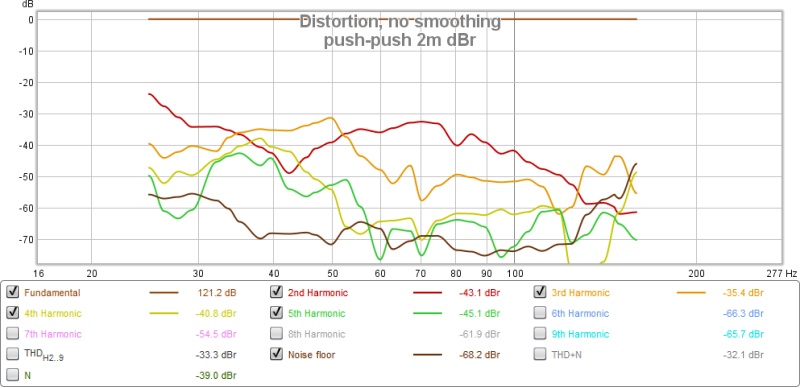

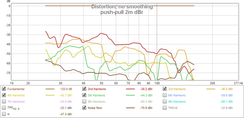

Since the whole idea of push-pull is 2nd order harmonic distortion reduction,
I decided to test push-pull inverted, vs push-push (clamshell).
I mean, why not just make a direct comparison using the same box, right ?!
I used REW's stepped-sine harmonic distortion routine.
First plot is push-pull.
Second is push-push.
Both were at 2 meters, so add 6dB to SPL.
I don't see a clear distortion case for either.................??
And I haven't really heard anything in listening tests either.
However, the suspension and coil vent noise below 35Hz, was much louder with the pull driver exposed in the plenum, than when the driver rests in the cabinet as a push driver.
So, I'm going with push-push.
This gives the vibration reduction that I'm primarily after, and allows for a very easy periodic rotation of drivers to get over the horizontal sag stuff.

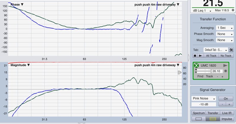

Having decided on push-push, I put together some processing.
Last plot is raw and then processed, mag and phase,
Raw is dark green. Processed is blue.
I was hoping to hear something substantially cleaner than I'm used to, from the PPSL. But just wasn't the case. Both sound very, very clean. Still very happy to have built this, if only for vibration reduction...
