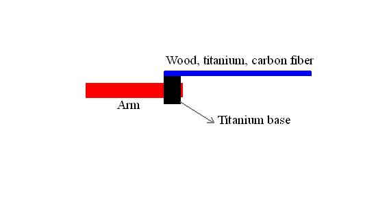

I have bad experience with the graphite pipe. When I drill in to easily crack.
So I must buy carbon fibre tube and aluminium (arrow shaft), titanium I have.
I imagine to do my head shell these way
I will get 6.1mm x 20mm titanium strip, I use that as a base, I can drill that (the arm hole) and screw holes.
For the top where I mount the cartridge I can test wood, carbon fibre, titanium, aluminium etc.
I made a sketch so you can see it.

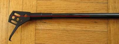

These how look the Linn head shell on these graphite tube.
Thank you
Greetings Gabor

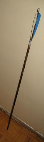

Today I got a aluminium arrow shaft. Easton brand 34" long.
Probably will be enough for two arm a longer and a shorter arm.
I have to find out how I can remove that 3 plastic from the end with out scratching or damaging the tube.
I want to insert a brass tube from the suspension until the counter weight end.
Can you let me know how long yours that part of the arm please.
If I build a suspension like yours I want that "needle" which hold the arm to go into the brass tube. Also the counter weight not to damage the aluminium pipe.
The brass is heavy but I have to use something. For that reason I need to know how long brass I cut and that will be glued in to the end of the tube.
I'll buy carbon fibre tube, I do not suffer with the graphite golf club shaft.
To heavy and to make it lighter I drill into. That crack sometimes the tube. Also that dust es itchy, toxic.
I would like to get a light arm, what I get from the golf club still to heavy I think compare to the aluminium tube or the titanium tube.
