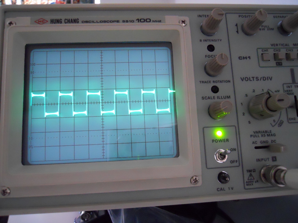

Maybe this will help folks understand about the levels...

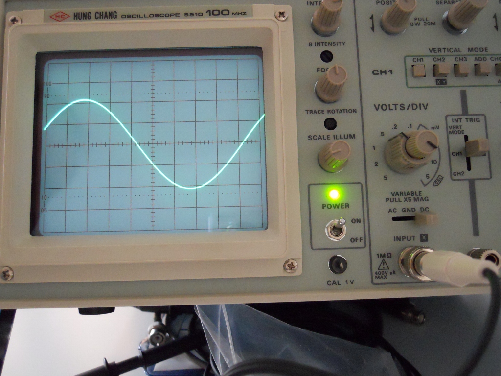

I ran a couple of tests earlier as I have a Philips Audio Test Disc that contains precisely recorded material at various levels. A similar Denon test disc was also available. Of particular interest is the text in the piccy below on "average" music levels off disc.
Measuring 0db off disc (the player was a portable if you wonder why levels are low) gave a reading of 0.765 volts RMS for both test discs.

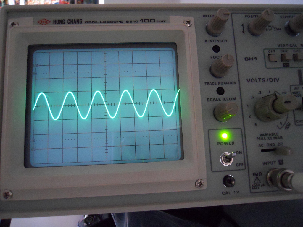

The -12 db Philips tracks were then played and was at 0.191 volts RMS. Calculator out and that came to -12.05db.

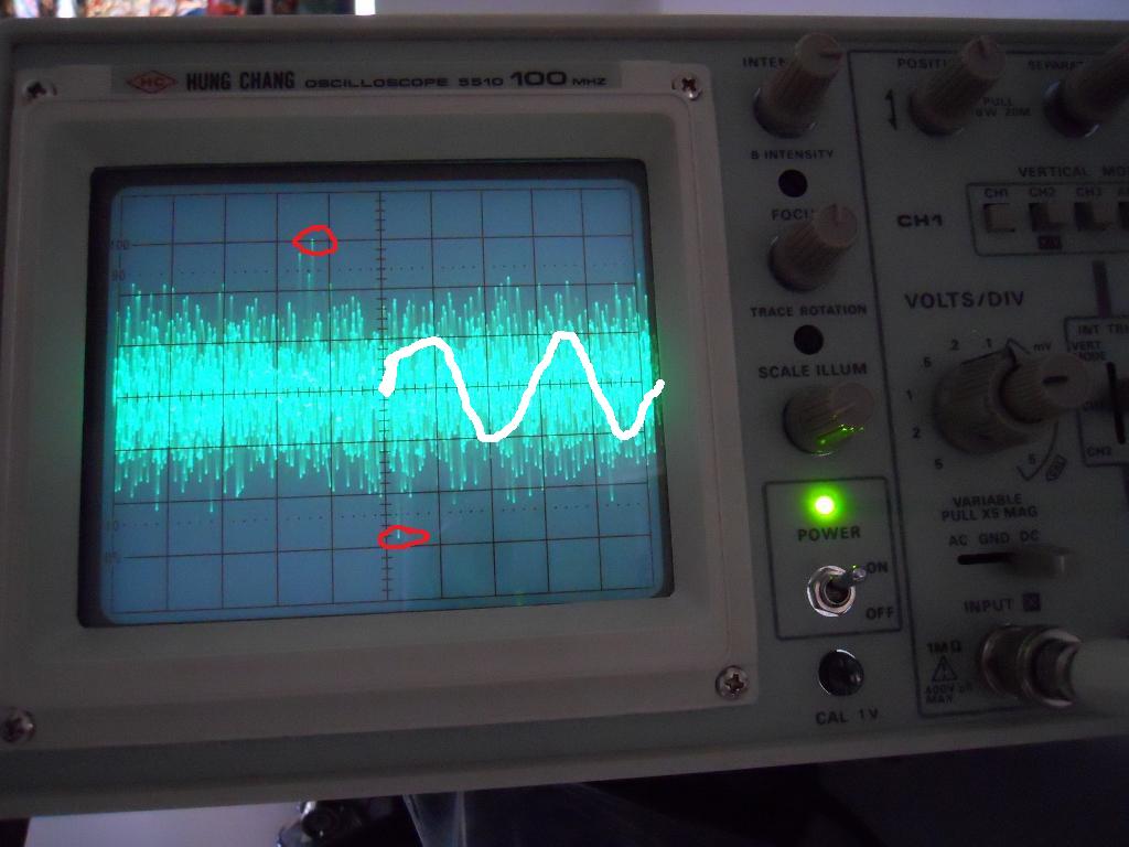

I then played Pano's tracks and they came out at 0.271 volts RMS which calculates out to -9db relative to the test disc 0db reference.
Lets try and explain that...
The scope shot shows 0db level on a sine wave.
The white noise test shows the level going "over" the 0db point. This is where Pano says,

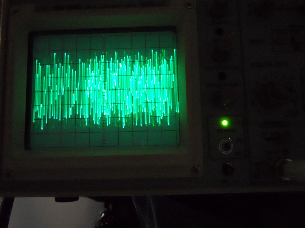

And to show graphically the difference in amplitudes between three differing test waveforms we have shots of sine, square and white noise ALL at -12 db The last scope shot has the 0db sine wave drawn in.
[*]The test signal is recorded at -12dBFS (12dB RMS below Full Scale)
[*]The highest a sine wave can be recorded without clipping is -3dB RMS[/list]
