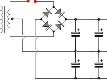

With my lack of knowledge I want to be careful with voltages. For a start I will connect series bulb on primary again then remove the amp module and place some load(?) after PS rectification and filter ? A small value fuse on secondary wires ? Just to check if current can be measured. If OK then will again connect amp modules. Dont know.
Also I was thinking about earlier varying current measurements, I guess probably since Wires were wrapped around multimeter probe with crocodile pin. I think loose contact there or at PS may be causing fluctuation.

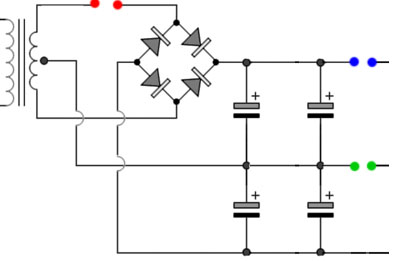

Got little impatient and measured right away. So far no smoke, bangs or bursts. Amp is working fine. Power supply is as picture attached. 18-0-18V to 6A4 Rectifier to four 4700uf Capacitors. Series test bulb in place.
Volume adjusted to get 1V of Test Signal at speaker terminal on all measurements.
1) at Green dots centertap after rectification and filter I am getting 11.72A on multimeter dial at 20A AC setting . Probes on mA Setting.
2) at Blue dots +Ve rail after rectification and filter I am getting 9.4A on multimeter dial at 20A DC setting. Probes on mA Setting.
3) At 18V wire of secondary shown in Red dots. I am getting 9A on 20A MM AC setting. No current on DC setting even after switching MM probes .
What if my un branded speakers (Only 8ohms20W written onit) are actually low ohms. And because of that it is showing these currents ?
Your readings seem odd tbh. I don't understand the bit about 'probe on milliamps setting'.
There is something strange with your readings. You can not be pulling those kind of currents , the numbers and what is happening don't compute. 18 volt winding, that gives 25 volt rails. 11 A at those kind of voltages is much heat and destruction and that obviously isn't happening. The bulb could not support those powers in any case.

Tested at Red dots of the picture. Test signal adjusted to get 1V at speaker terminal which I normally listen to. As you can see in the video Red multimeter Probe is on mA and Selection knob(dial) on 200mA setting. When no singal it showed around 38 (?) and with signal started it showed 68 (mA?)

Yes thats what i did; but at mA settings.If your multimeter is set to 20A, the probes should be on the A or 20A setting, not mA. Most multimeters differentiate the low and high current because of the fuse.

here are more (probably useless) measurements. I measured test signal at 1v, 2v, 3v,4v. At Transformer Secondary (18v) lead as shown in previous picture.
1v=66mA
2v=100mA
3v=140mA
4v=184mA
4V is insane volume level considering I was happy at 1V. But Shall I draw conclusion that 3A rectifier discrete 4 diodes or a bridge rectifier package will be suffecient ? I am reluctant to use fast switching diodes. Any recommendations of normal soft recovery diodes/Bridge rectifier like KBPC type ? (Because my PS supply board has KBPC type holes.)
One more measurement for Actual Music. I played Direstraits (Calling Elvis) same volume setting level (4V) on test speaker and current draw at same points of secondary transformer flctuated from 60mA (normal passages) to around 150/160mA on loud drums. I guess MM cant show such quick transients so on safe side I will presume current draw on loud passage can be double.
