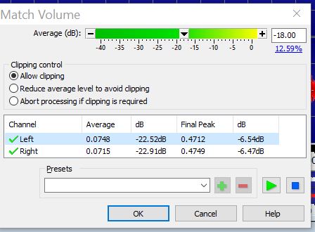

That's a handy one. But for some reason it does not list the RMS value of the track. For that you need to go to EFFECTS|MATCH VOLUME. It will scan the track or selections and give you the RMS value. Do NOT hit apply, you don't want to change anything, just look at it. If you do change the levels, just EDIT|UNDO or Control Z. No harm.
The icon for this tool is a little blue speaker with the = after it.
Gotcha. So the Average dB reading is RMS? Very cool :)

From here you can calculate how much voltage RMS is going to your speakers in a song.
Once you've done the 120Hz sine test posted in the beginning of the thread, you can calculate voltage of your song. Normally it will be 3-6dB lower than the test tone. And now you have the tools to check that more closely.
