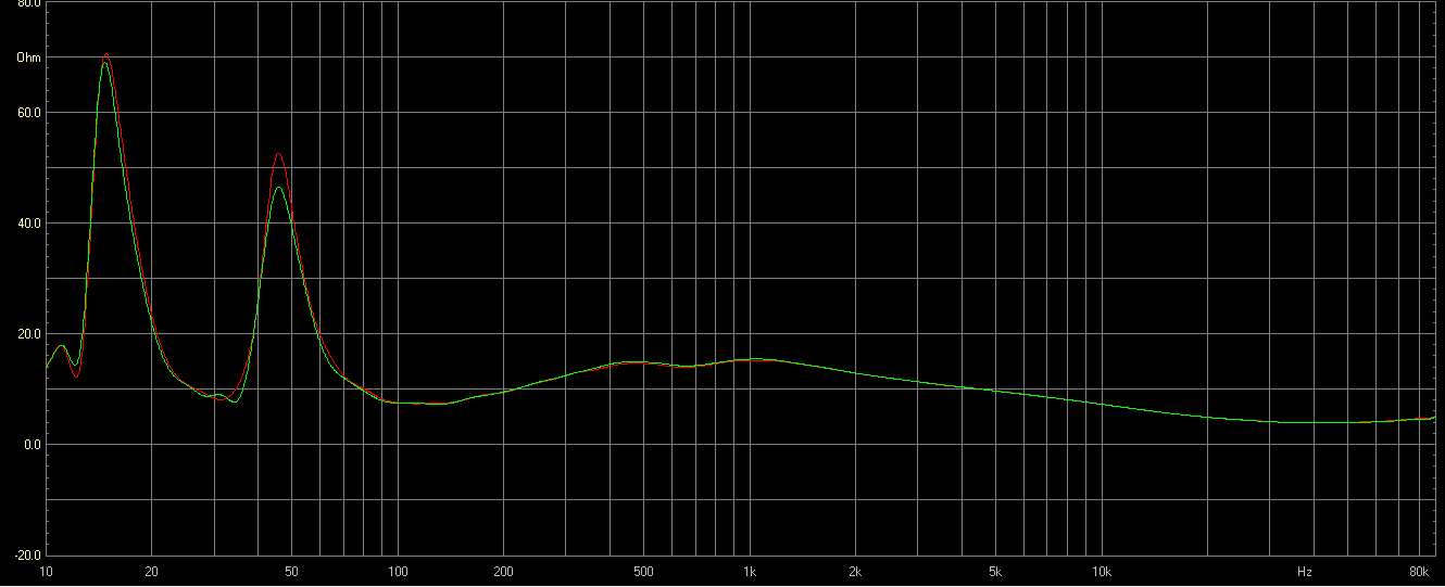

OK, I measured again. Measurement this time is 1.6Vrms.
I could go for a little higher than 2 o'clock (Zero's at 6) on the dial but the only time I've ever taken it higher is on low level YouTube videos so not sure why I'd do it here.

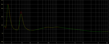

The impedance is , well, I don't know what to call it. What would you say? (Red stands for port speaker, green is starboard. ; )
