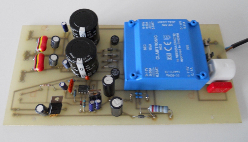

That's a great idea. I would think any normal amp (or chip amp ?) on a variable PSU would be adequate. If you have a variac it's even easier. Maybe just check with a scope to ensure it clips where expected.
You'd be amazed just how little you can get away with. This little PSU with it's 15-0-15 / 18va transformer (yes 18va) and 6800uF caps is one of my most useful test rigs... inherently SC proof up to a point... it will drive a stereo amp far louder than you might think. Great for initial design and development.
