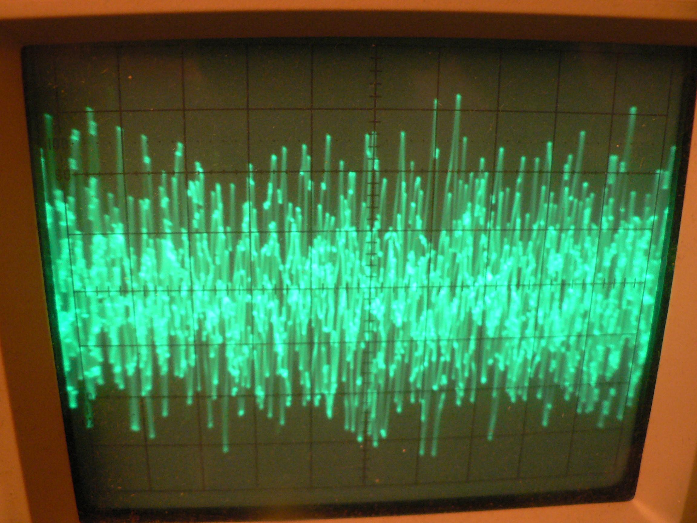

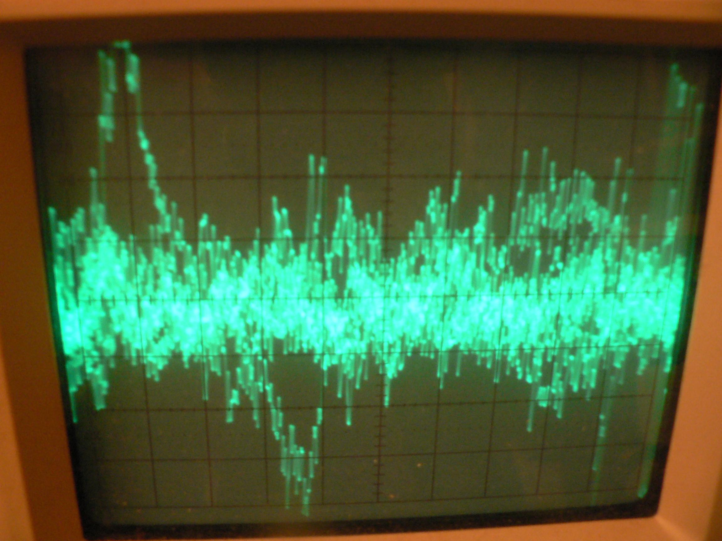

pic5 shows average @ -8.80
Setting the volume attenuator for these two quite different tracks will result in a 19.18dB difference in the predicted maximum voltage needed to be supplied to the speakers.
for example: if one attenuator setting shows 1.2Vac of 120Hz test tone, the other will show 12Vac of 120Hz test tone.
That's a 100:1 difference in required power prediction for just these two examples.
Don't let Pano and others delude you in to thinking that average levels do not matter.
The argument that this 0dBfs is a fixed hard ceiling voltage level allows power predictions is flawed, even restricting it to digital only signals.
I wonder what the average to peak ratios look like in well recorded 192kb/s & 24bit resolution?

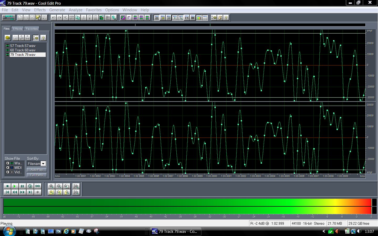

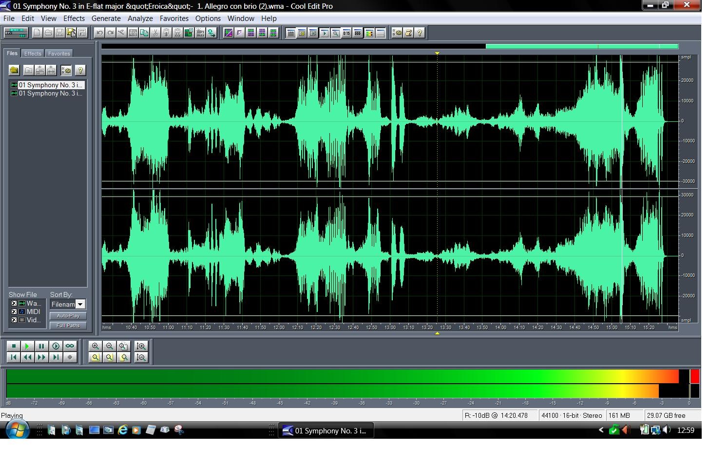

Transfer the file to a computer and open it with some thing like Cool edit that can analyze the data in the digital form or try the orban VU meter and see what it says.
Not sure about white noise, the kind used for testing in RF had more like a 10dB peak to average ratio. If any of your circuitry were limiting, you may see a different peak to average ratio when the average level is lowered.

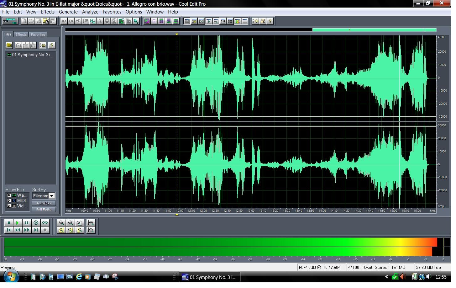

Here is the Denon 0db test track in Cool Edit Pro. It shows as exactly 0db on the screen.
Two shots of some dynamic music. Hard to capture to the exact microsecond to show the peaks. It's Beethoven and the Eroica symphony. First is a ripped WAV lossless file, the second a 64K WMA file. That one actually shows as clipping in Cool Edit. The lossless does not. Double checked a couple of times and the lossless never clipped.
I also tried various tones on the test disc at different levels and all showed as spot on.

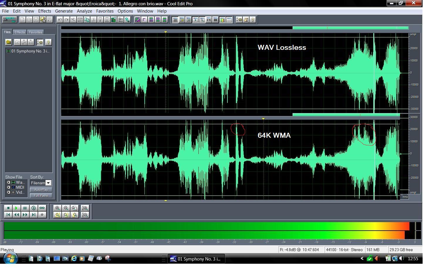

Maybe not as different as you might think. This is WAV lossless and 64Kb WMA file compared. I have copy and pasted the left channel 64K image into where the right channel WAV Lossless was so it's easy to compare.
Both tracks play for 15 minutes.
WAV = 157mB
WMA = 7.23mB (look at red highlighted parts)

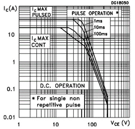

I also am interested in the power requirement question and am enjoying that discussion. It appears to be not as straight forward as avoiding clipping in under the conditions given.
Indeed this isn't anywhere near as straightforward. As Mooly mentioned loudspeakers have reactive components to their electrical characteristics which can make an amplifiers job much harder then it needs to be. The reactive nature causes the current to fall out of sync with the voltage and this is frequency dependent, so whether or not the reactive loudspeaker would cause your amplifier to clip is heavily dependent on the spectral content of your music.

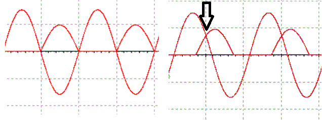

Below is an image of the voltage draw vs the current draw of an amplifiers output stage when first, driving a resistive load, then second, when driving a reactive load.
First of all I shall point out that the red sinusoid with the larger amplitude represents the voltage output on the amplifier and that the red sinusoid with the lower amplitude represents the current draw from the negative side of the amplifier, this is why the current is inverted vs the signal. You will notice that in the first graph the small sinusoid reaches its maximum value when the large sinusoid reaches it's minimum. Here the current and voltage are in phase with one another. When the reactive load is connected however the current draw falls out of phase with the voltage.
In the first instance lets say the resistive load is 8 ohms and that the voltage maximum = 25 volts and the current maximum therefore = 3.125amps, we're pulling 78.85 watts peak out of the amplifier. The voltage rails however = 30 volts, so only 5 volts peak is dropped across the output device so it only dissipates 5*3.125 = 15.625 watts.
In the second case however we've now got a reactive load connected, the impedance seen is still 8 ohms, but it's now got a reactive component. Lets look at the black arrow. Here we can see that the voltage on the output of the amplifier is positive, but the current being drawn is actually being delivered by the negative side of the amplifier.
In the first instance, where the current was in phase with the voltage, all of the current delivered from the negative side of the amplifier coincided with a negative going output voltage.
This means that when the output of the amplifier = zero volts, that both the negative and positive sides of the amplifier are delivering zero amps.
Now into a resistive load, when the output of the amplifier = zero volts, the output devices are dropping the maximum voltage they will ever see. That is say the rail voltage =30 volts, the power rail is connected to one pin of an output device. Another pin of the same output device is connected to the output of the amplifier and the output = zero volts. So as there is 30 volts on one side of the output device and there is 0 volts on the other side of the output device, that device has 30 volts dropped across it. As no current is flowing no power is dissipated and the amplifier remains cool and has to do no work.
Now look at the reactive load again, when the output voltage = zero there is a large amount of current being delivered from the negative side of the amplifier. In this case 30 volts is being dropped across the output device (because the output = zero) but now we've got a current flowing, say its 2.8amps. Now we've got work being done and the output device is going to have to work hard to deliver it, in other words the amplifier now heats up. 30x2.8 = 84 watts. (I am not completely clear on reactive loads, but does this mean, that because the output of the amplifier = zero volts, that the power delivered here to the loudspeaker actually = zero and that the output device is called upon to dissipate it all?)
But lets look at the black arrow again, here we see that the output voltage is going positive where the current is negative. In this case the negative side of the amplifier is delivering the current, but this time the output of the amplifier isn't at zero volts it's at something like +12.5volts. This now means that the negative output device of the amplifier has 30 + 12.5 volts dropped across it which = 42.5 volts. The current has fallen a little down to 2.1 amps, but the total power increases again up to 89.25 watts.
Now the worst possible case is when the current is completely out of phase with the voltage. This means that when the positive going voltage reaches its maximum so does the negative going current. Now the heavily reactive load would still = 8 ohms, so the current maximum would = 3.125amps. However now the negative output device is having to drop 30+25 volts = 55 volts total for 3.125amps = 172 watts.
As you can see reactive loading places heavier demands on the output transistors, this is especially so with very demanding loudspeakers and this graph will help to show why.
This graph shows the safe operating area of a high power transistor specifically designed for high power audio amplifiers.
Vce at the bottom of the graph represents the voltage dropped across the transistor in an amplifier application. At low voltages the transistor is capable of delivering large amounts of current, but you'll notice that the current starts to fall quickly as Vce increases. High power amplifiers run from voltage rails of around 45V+, so under the worst possible case scenario the output transistor would see 80+ volts. You can see quite easily that the output transistor can only deliver a very small amount of current @ 80 volts compared to say 40volts.
This is why a reactive loudspeaker will cause your amplifiers protection circuitry to kick in. For all of this extra amplifier dissipation the reactive loudspeaker doesn't do anything extra either, its all simply waste. BOO for reactive loads.
If I've got any of that wrong I am sure someone will tell me. The numbers used above are mostly made up rather then calculated.

Below crappy scope-pictures are taken while playing
'Private Dancer', scope-setting was 5v/div.
I'm afraid the camera-tripod experienced some serious vibrations
Note: these pictures don't correlate with my previous
posted rms-values taking Pano's test.
I simply cranked up the volume to the maximum level i was
comfortable with, woofer-excursion was moderate while levels were
'party loud'.
Power-amplifier used was a Krell ksa-50, no current-limiting except for a 8A mains fuse.
I guess it's safe to say that a 2x10watt amplifier that can't fight it's way out
of a wet paper bag is not sufficient at these levels.
'party loud'.

Interesting scope shots. Did you mark the volume control level? If you did, then you could try the -12dB test tone(s) in comparison and take scope shots of those. That way we can see where the -12dB sine falls in comparison to what you have shown.Below crappy scope-pictures are taken while playing
I don't understand the huge peaks in the seconds shot, but I also don't know what part of the track this is. Do you know what the giant jumps were?
