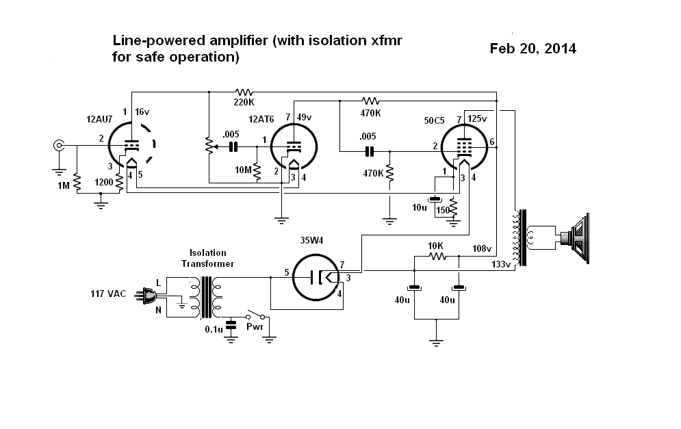

I moved my posting to the Inst & Amps forum, including the attached schematic to assure all I am playing safely.....(thanks Mooly). Adding the 12AU7 stage to the original intercom amp (a Masco ST-1) gave me more gain than I wanted (even with only 19 volts on the plate!). As you can see, I don't have much B+ to play with, but turns out boosting it (running both preamp tubes from the 50C5 plate not screen) made for terrible farting. Am digging into tube data plate graphs, but drawing a load line from 127 plate volts to 0.6 mA is barely on it!. Still, my goal is to predict, from a given tube mu, known input signal and B+ available: what my output voltage swing will be, if any of it will be limited (clipped), and what to change to produce/minimize grid clipping and/or plate clipping. Was directed to a "split-load" paper by Steve Ahola, is VERY informative. One tool I can use. I want to "ration" available line voltage to optimize its use/need. I have Magantz's book and the P1-eX (AX84) dissertation. Lots to digest!

The low plate voltages of this circuit is exasperating me! A B+ of 108VDC and plate current of 108/470K= 0.11 mA is barely even on the plate graph for a 12AT6.... How does this tube even work?? Has anyone written anything about this realm of tube application?

See the other thread, you need to change the B+ voltage drop resistor to a much smaller value (plus a bypass capacitor say 20uF) , and add a plate resistor.
The 12AT6 was in the intercom originally.....I'd hook you up with the original designer, but he's probably dead (RIP)....I added a 12AU7 (low mu), but have a 12BH7A, with a Mu of 16.5... may try it instead. Don't have many other 7pin tubes (other than a matched pair of 6V6 clone 6AQ5A's that I'm dying to push-pull for 10 watts, but that's a future project!).
