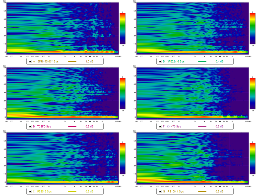

Here is 6 panel view of tested drivers. I omitted RS100P-4 due to similarity to RS100-4, also making a fairly clear single overview. Assuming speakers where measured at same place in room, with same microphone placement, the spectrogram views reveal both frequency response differences, and directivity differences between the 6 drivers.
If measurement assumptions are correct, let me know and I can produce normalized amplitude response spectograms revealing more detail of directivity differences between drivers.

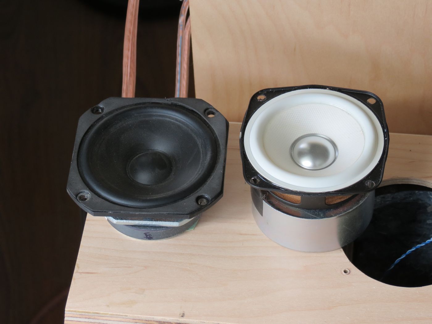

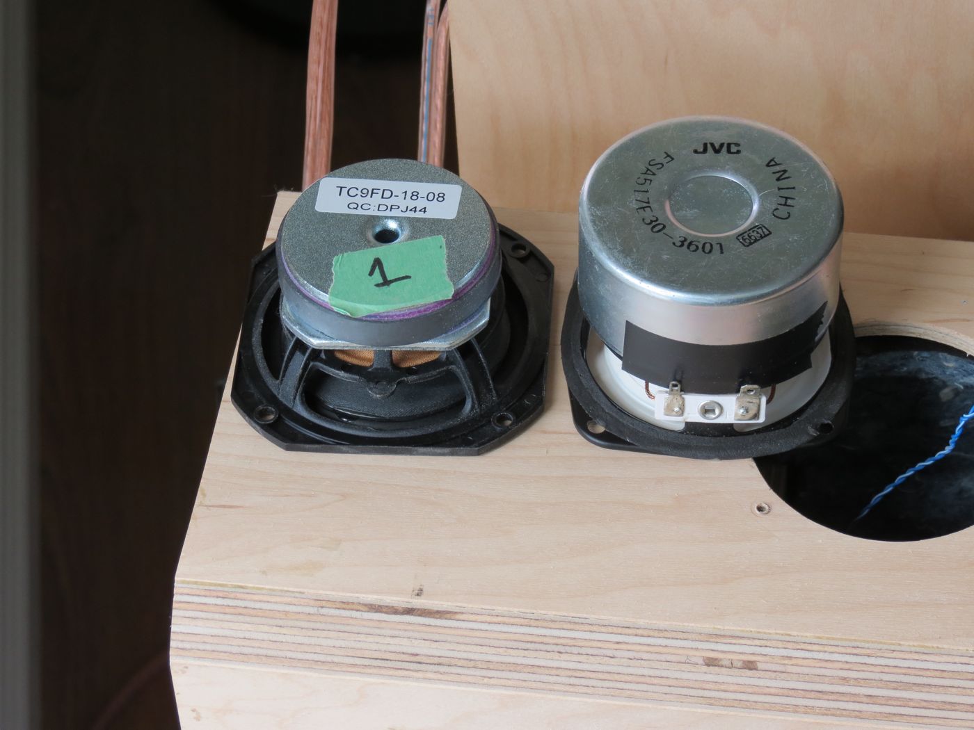

I finally got to hear the Vifa TC9FD 18-08. Not quite the same as the Vifas tested but I am hoping they are close enough to evaluate. They are in a sealed 6 litre box with no filters. I played a test disc I use to evaluate.
So I'm listening to song after song thinking something must be wrong with my ears. These drivers are well respected. Inexpensive, yes, but drivers that won a listening contest. OK, so what's wrong?
There was little bass, that's to be expected.
The mids were in your face, no perceived depth or soundstage.
The highs, especially cymbals sounds like plastic similar to those 99 cent mylar tweeters.
Hmmm... guess I'll turn it off and try later. On second thought I have some salvaged JVC drivers on hand that I know sound really good, I'll just pop them in to compare.
A different world. The music returned. There was at least a little bass, the mids had depth and the cymbals sounded like cymbals.
Swap them back and all that went away. Now don't be mad, I'm not here to bad mouth the drivers or use ambiguous terms that may or may not be relevant, I am here to say that the JVC drivers, which were satellites in an HT system are leaps and bounds ahead. There's no comparison. So that begs the question what is it about the Vifas and the test that made them win? I know everyone's ears are different but this is not something you hum and haw over, this is night and day. I'm just curious, not here to beat my chest, what it was about the way they were presented that made them win?
I wish more than that, that some of you could come on over and have a listen.
2 cents.
