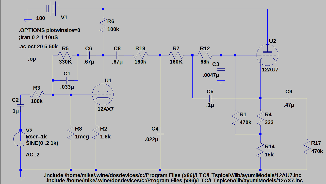

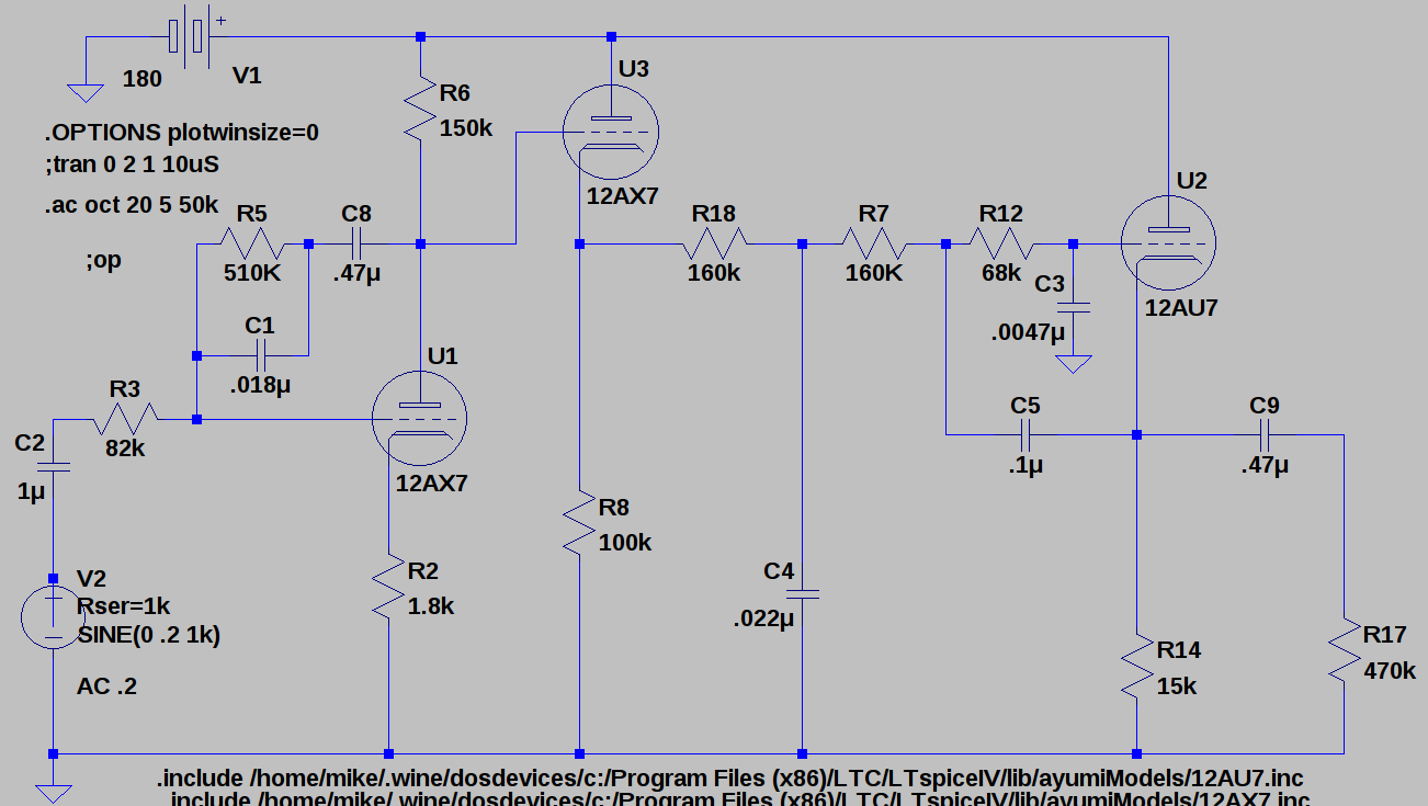

a sub crossover idea
final slope 24dB 1st order boost in the pass band to counter driver roll off.

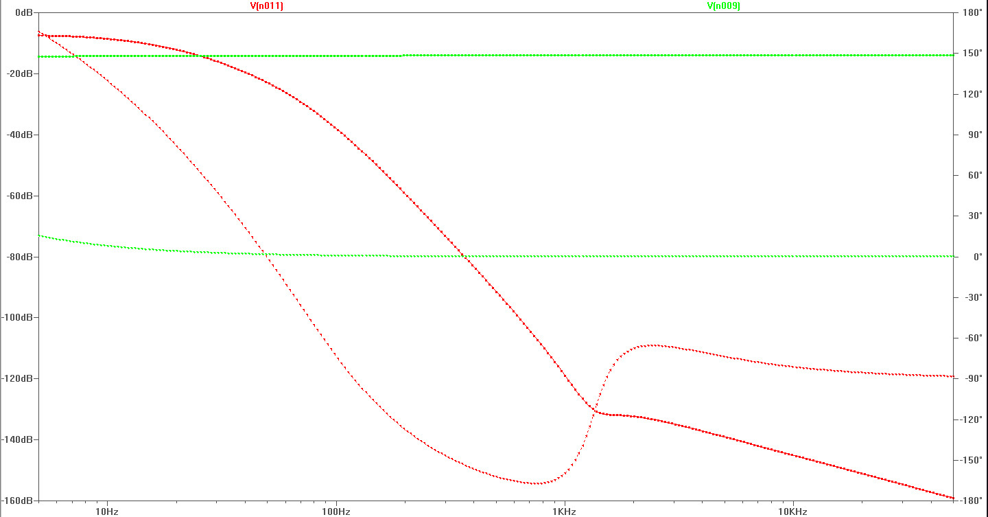

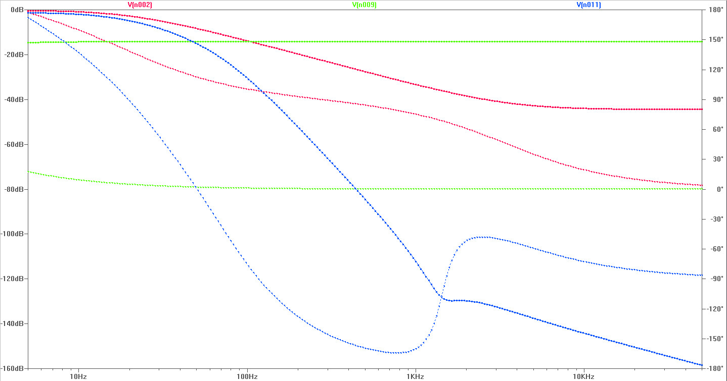

I wonder how much of the phase and slope change above 1.2kHz is real and how much it matters given we are down well over 100dB at that point. Green trace is input Red trace is output.
