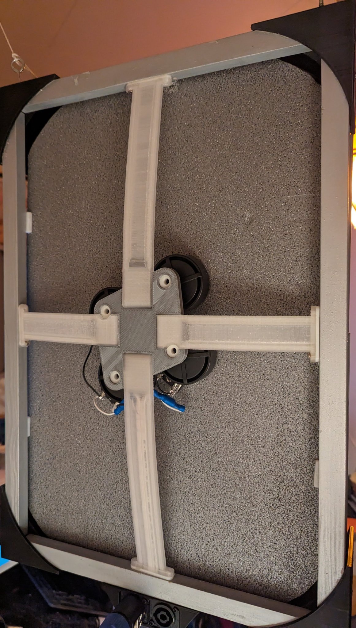

I could print out
For the plate I'm testing with Xcites, I'm using the same brace construction as I used before, but only to help with cable management and to offer som protection against bumping the exciters. You cannot really see in the picture, but there is around 10mm space between the brace and exciters.
I could easily add some printed TPU spacers that holds up the exciters, but I'm still not really convinced it would be a good idea. It seems logical, and is what I did with my Daytons, but they still developed issues and makes things much more complicated and sensitive to the tiniest misalignments.
Probably what I should do is run a low frequency sine for extended time, same as when preconditioning woofers. That should soften up the suspension and make them sag...if there is an issue with the Xcites as well.
I can pint out a holder that fits in the pattern on the back of the Xcite to keep the exciter in place with very good precision, or use some kind of putty as you suggest. But it is not that easy to ensure that there is no stress in any direction, especially if you want to keep as much as possible of the back of the exciter open to avoid overheating. The screw holes on the Daytons makes it easier, but even then it was a bit tricky. With the Xcite it is even harder.Hi Leob

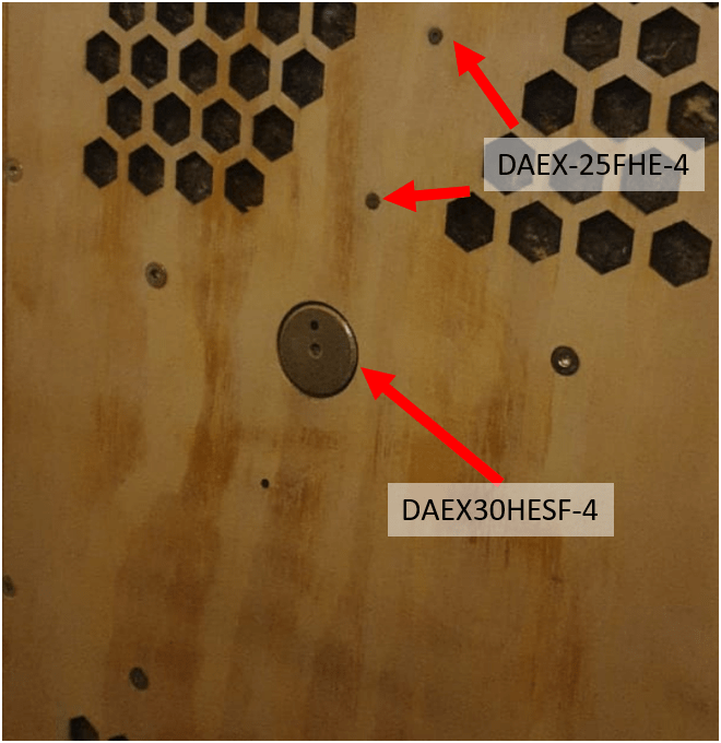

Hi Leob,You have any good ideas how to mount the motor magnet to the back plate?
The back of the Xite is not even, and seems very easy to get some slight misalignment, especially when trying to mount a cluster of 4 exciters.
This is how I mounted the 30HESF-4 to my back plates. I strip the adhesive tape off the front of the driver and mount it to the front panel with epoxy, The motor magnet is not a tight fit in the hole in the backplate, and I run a bead of silicon all around it to keep it snug. This means that I can centre everything perfectly without alignment problems while the adhesives cure overnight.
Yes, the sticker is removed off the magnet.
I'm using the back plate as a damper/attenuator for the rear wave on stage (so it's not so loud for the musos), and also just to improve the looks for an installation. The other smaller drivers (25FHE's) are mounted via their threaded holes on the inside of the back plate, and you can see only their mounting screws. The 25FHE's are about 6mm shallower than the 30HESF's, and that's another reason that I use adhesives that will cure relatively slowly: The HESF is free to find its own level relative to the height of the 25FHE's which determine the distance from the backplate to the front panel.
Using this method it should be easy to mount the Xciters irrespective the shape of their plastic shrouds. I suspect that epoxy might not adhere to those shrouds (I don't know what material it is) and it might be difficult to mount them directly to a flat brace given their uneven shape.
No I did not address this. When I get my Xciters I'll assess them properly. But I think the above method is a universal solution irrespective the shape and adhesion characteristics of the device.Have you discussed sagging and bracing with Xcite? I did reach out to them on Facebook but never got a reply there, so I should probably mail them instead.
Hmmm... A cluster like that makes individual hangers impractical...Personally, I'd try and opt for a printed support plate that encompassed all 4 exciters, and fitted over them so the plane of the plate lies on the centre of gravity of the exciter. That plate could in turn be supported from your bracing arrangement. A tad complicated but worth a try. Similar concept to Andre's but without a full backing plateI could easily add some printed TPU spacers that holds up the exciters, but I'm still not really convinced it would be a good idea. It seems logical, and is what I did with my Daytons, but they still developed issues and makes things much more complicated and sensitive to the tiniest misalignments.
