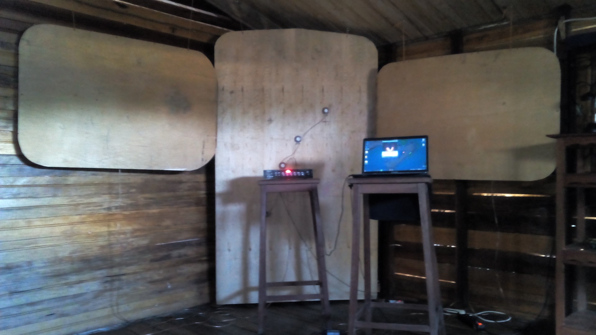

Good to see this thread get revived in past few days. Pol_bct, do you have some photos of your setup?
was a previous try, I'm waiting for new panels, bigger , better, bader...
as usual by me, it's a three panels config:
left hi-mid, center lo-mid, right hi-mid.
(search my others posts)
