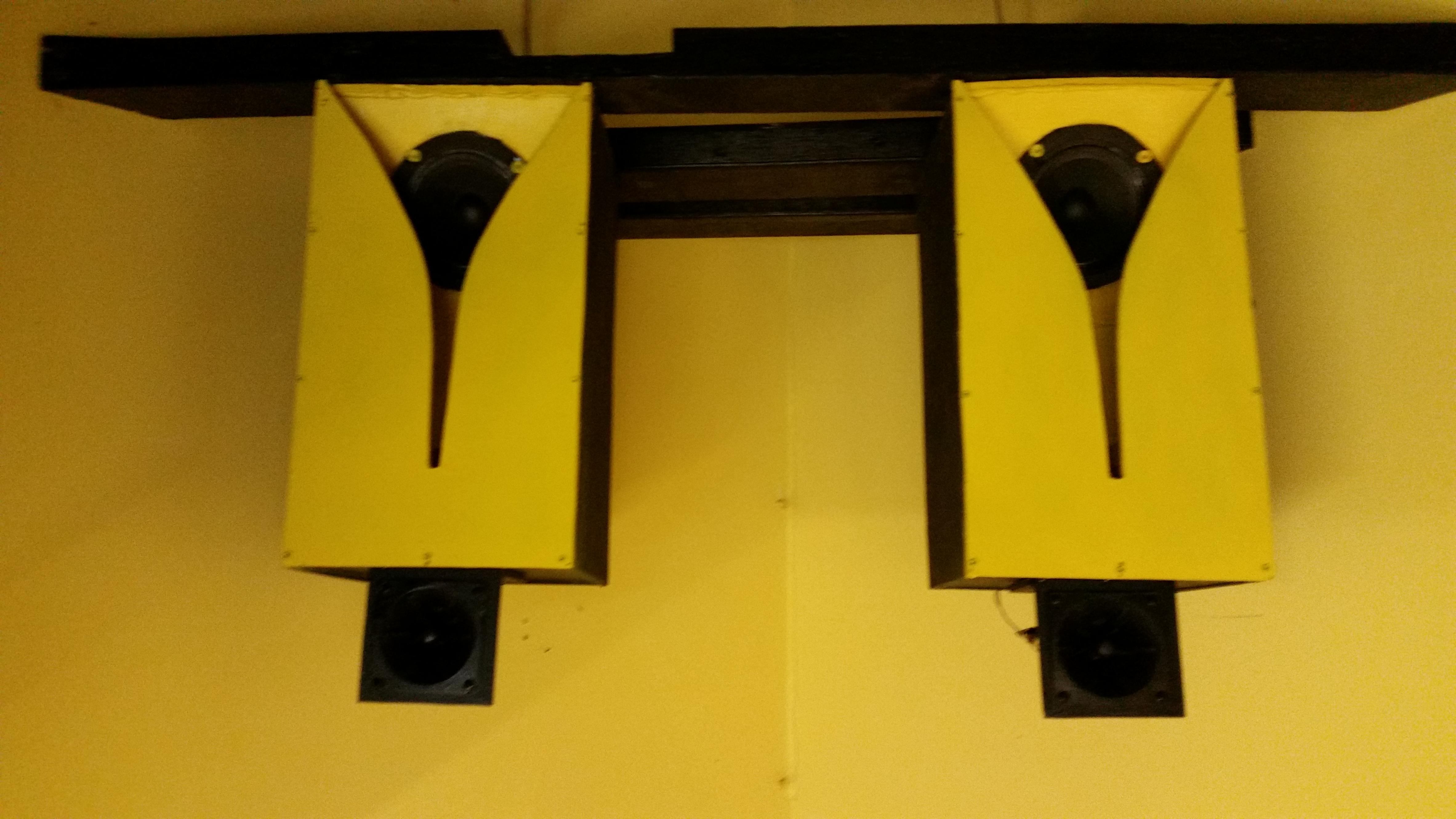

X, when you get your Akabak back, could you simulate a Karlsonator for twin PA130-8's.
I bought 4 more and want to parallel them for 4 ohms.
I'm running my PA130, 0.53 Karlsonators with piezos on top that have 50 ohm resistors and 0.2uF caps.
They sound really good. In a past post you commented that doubles would be around 0.75 scale. I'd love to build a pair.
thanks
Paul

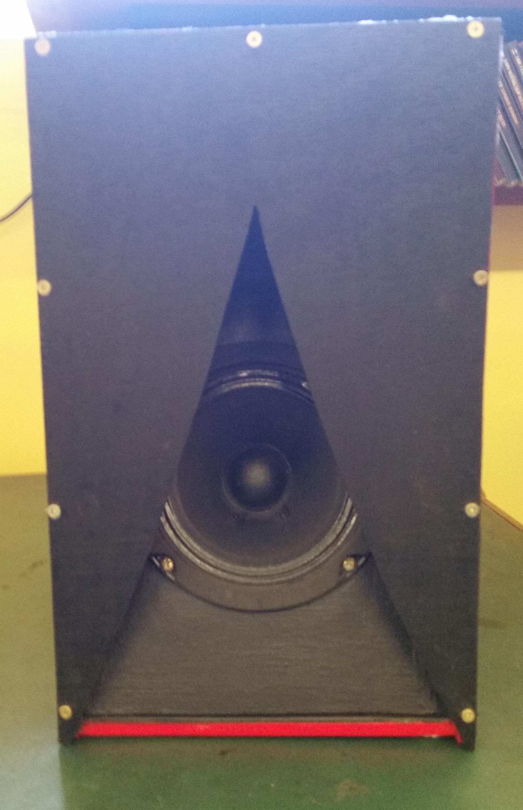

X, I have built the Karlsonator 0.53, and the XKi with the PA130-8. The XKi sounds very good and bassey, but I think the Karlsonator is much better.
Having two each side at 4ohms driven by a 7598 2x100W amp should really make the blues rock (pun).
Freddi the piezos are vertical as I thought the K slot is vertical. They are they are sitting back above the centre of the woofer.
I don't know why the 1st pic is upside down.
thanks
paul

I've been trying to find out how to record these speakers to let you hear how good they are.
I intend to make full size Karlsonators with Betta 10CX and to make 15" Karlsons.
My expensive speaker builds have to wait for spare money.
I also need a table saw. My woodworking ability needs vast improvement.
But X's designs are the best sounding and best value for money.
I'm listening to the 0.53, PA130's now, and am wiped out by how good they sound.
With the piezos you can hear the cymbals; they sparkle; bass on the right track is physical. This is with 7598 amp, 350W meanwell PSU and Asus DG soundcard with Unity drivers.
thanks for your interest
paul
