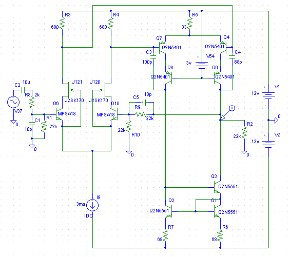

Do you really believe that openloop linearity got increased by factor 1000 ? I had closely checked, openloop linearity and gain barely changed by the cascode, the problem is simply that the signal at the base of the + input is already distorted, the amp amplified what he got. The feedback signal was the same way distorted. As ilimzn pointed out, you could try to balance the impedances.
The effect was exaggerated in this circuit by low supply voltage and having the cascode close to the input swing.
Try this circuit in sims ! The errorvoltage says that there are no distortions (distortions canceled out at fb node). That's no hint whatsoever, naked measurings.
Mike

Hi !
To show what i try to tell i attached fft-plots. The upper is the wrong cascoded (showing the effect), the lower the functional one.
Red = output
Blue = input (voltage at base of +input)
Green = feedback (voltage at base of -input)
Observe on the upper one that feedback and input shows the same signal, creating "no" error voltage. The input signal already contains the distortions, and the feedbacksignal shows the same distortions, yielding in openloop distortions + the distortions at input. The feedback is not functional here.
The lower one still has this effect, but reduced by -60db, and the feedback does its job giving thd of ~-130db.
It's likely that real world devices behave even worse.
The concept of feedback is still valid, but can be easily knocked out, especially for higher freqs.
I tried a lot to find flaws in the concept of feedback, except the mechanism of distorted distortions through the feedbackloop giving high order harmonics all i found was that feedback works if used correctly.

Hi lumanauw, if you look closely you see identical voltagedividers in feedback network and bias for the cascodes. These cascodes swing with the inputvoltage, so the result is identical to my cascode shown, but does not put any load to the emitters of the LTP.

Hi lumanauw, principally a nice idea, but, you throw away completely any CMRR. The circuit would seize to act as diffamp (only amplifying the difference between its inputs). Instead you get the difference plus the input, rendering the feedback unfunctional.
Remember, the diffamp ideally only puts out the difference, independent of the voltage at point B.
Also, point B sees large amounts of 2nd harmonics, you would amplify these.
If you want to use feedback, keep the ccs.

@MikeB, looking at the schematics on the first page, C3 is rather superfluous as the collector of the conncted transistor sees nearly no voltage swing.
Hi ilimzn, the swing seems big enough to have effect, without c3 the circuit would oscillate. C3 is not a real miller cap, but does a good job in reducing phasehift.

Mike,
Beg to disagree. This is simply a case where the open loop linearity is much improved by the bootstrapping. So, the HD is much smaller to begin with, and then again the fb decreases it. There is no hint whatsoever that nfb doesn't educe this distortion or any other distortion existing within the loop enclosed by the nfb.
