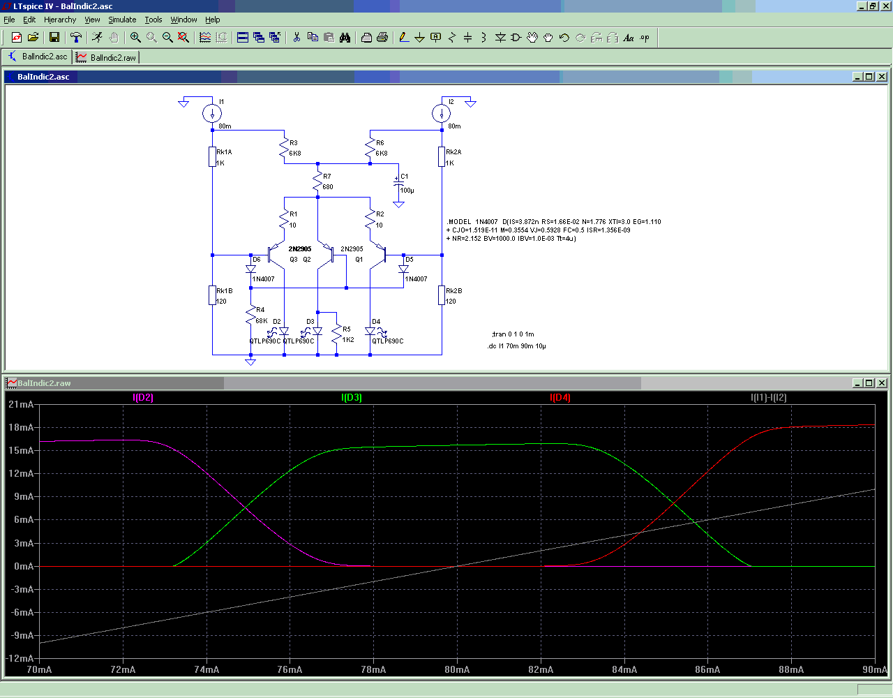

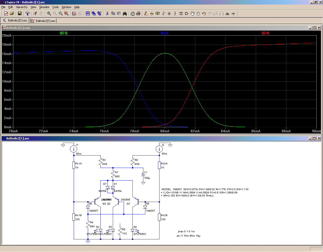

Here is the circuit adapted to feed from the cathodes with minimal audio interference, and a modified BOM (2N2905 ~= 2N2904).
At a nominal 80mA cathode current, the green (center) LED is lit from ~75mA to 85mA.
The percentage would remain similar at other currents

I have one more question:
If I get a hold of a Schottky diode,
can I just drop it in where it was before in this new circuit, and get tighter response,
or are there necessary adjustments that have to be made?
Without the schottky, the total "green band" is 10.6mA.
With a 1N5818, it becomes 6.5mA.
With a smaller schottky, like a BAT-something, it is under 5mA.
You can experiment with various diodes and emitter resistors to find the behavior that suits you

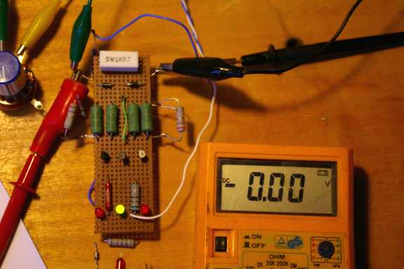

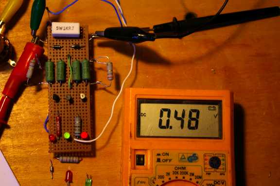

Back again!

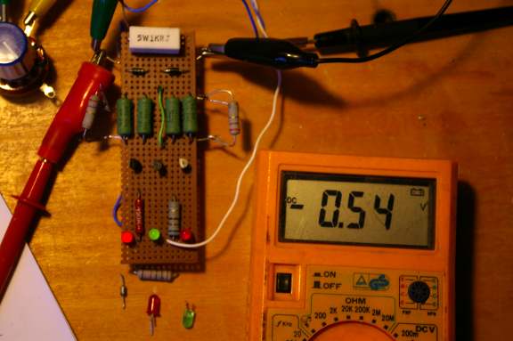

I built a prototype version.
After trying 290volts, and a 12K as a PS feed resistor, that quickly overheated (4watts thru a 2 watt resistor oops).
It seemed to work but two LEDs fried.
More cautiously, I tried a 5w 1k resistor and a 30 volt supply,
after replacing two LEDs.
It seemed to work, except the middle Green LED didn't come on.
I tried substituting the schottky diode in for the 30v zener I had, but it had no effect.
I tried bypassing the diode in my diagram, and just connecting straight through, and voila! the Green LED lit up.
I had mocked up 4.4 R for each of the reds by putting 2.2Rs in series on each side (green 5 watt resistors).
These were supposed to be 5.8 so I inserted another 2 ohm resistor, which seemed to bring the reds closer to the middle.
In the end I left it at 6.4 ohms each side.

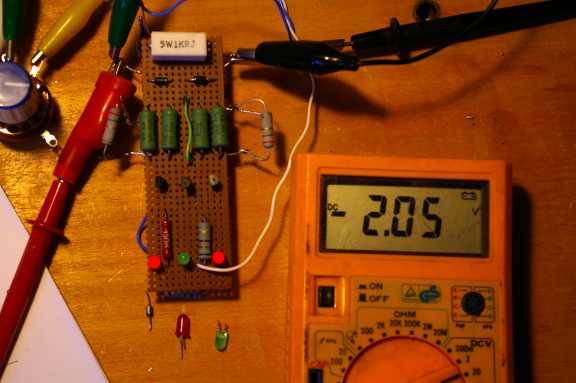

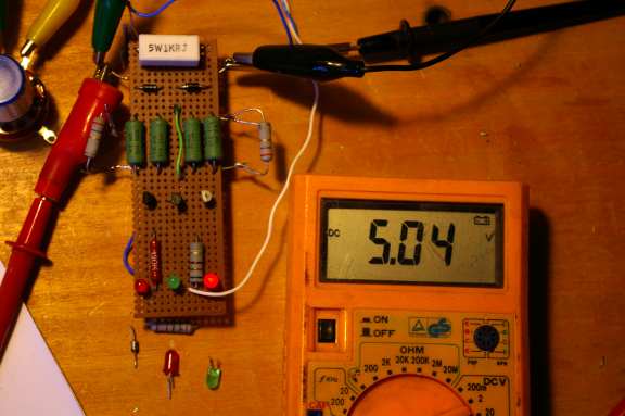

The sensitivity is as follows:
Red lights dim out at about +- .2volts difference (spread of .4v).
Green light comes on nicely, and the overlap is such that:
Green and one Red come on equally bright around +- .5 volts.
(see photos).
Trying my hand with a volume pot wired between a +- 5v supply and the tap and ground used as left and right comparison (-5 to +5 v spread).
I was able to dial in within 0.2 volts using the lights alone.
The basic problem is that the Reds are out and the green is on, for from about -0.2v to +0.2v. And you could land anywhere in there and think the voltages (and currents) were balanced.

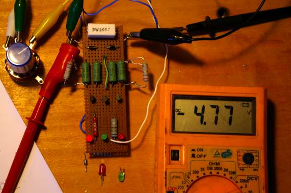

Still, there are some disturbing side-effects for the circuit:
There are points where I turn the offset voltage imbalance,
and strange things happen, like all three tubes light up at slightly less than half-brightness!.
Its not as though one would mistakenly mis-bias the tubes,
because the bright Green light keeps you in the zone,
if you are paying attention.
Still the circuit seems a bit jerky in its responses and the behaviour of the three LEDs.
Do you have any comments?

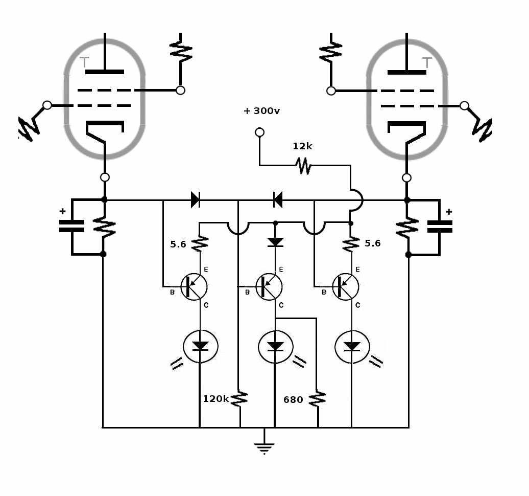

The test circuit looks more or less like this:
only substitute a 30v supply and a 1k (5w) resistor to power it.
Also take out the diode above the middle transistor and sub in a straight wire.
The 5.6 ohm resistors are now about 6.4, for no reason other than thats what I had on hand to slap together.
What happened was I failed to use the latest circuit posted by Elvee,
and didn't notice until after I had soldered it...Doh!
That shoud not be possible, since the current is inherently limited to 290/12=24mA, too small to fry any LED.
Something must have been wrong, or the LEDs reverse-connected.

Also, if the difference voltage exceeds the Vbe breakdown voltage (~7V), the behavior could become erratic.
I breadboarded the circuit to make sure there were no unforeseen issues, and it worked as expected, which comes as no surprise, since it is very simple and highly simulable.

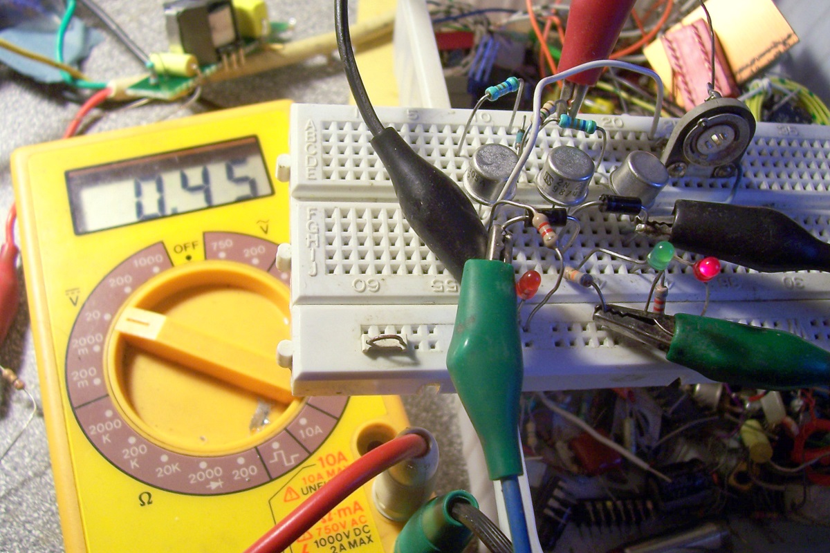

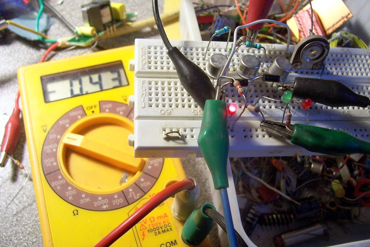

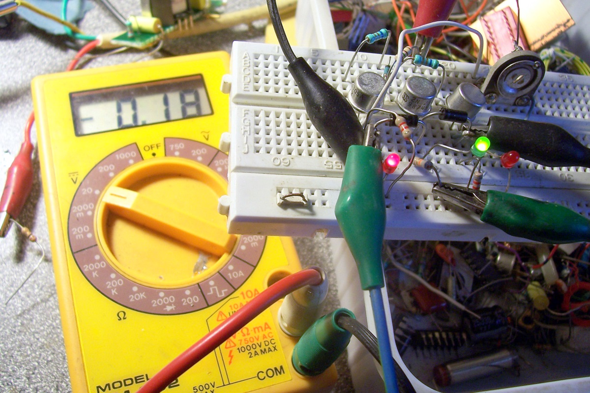

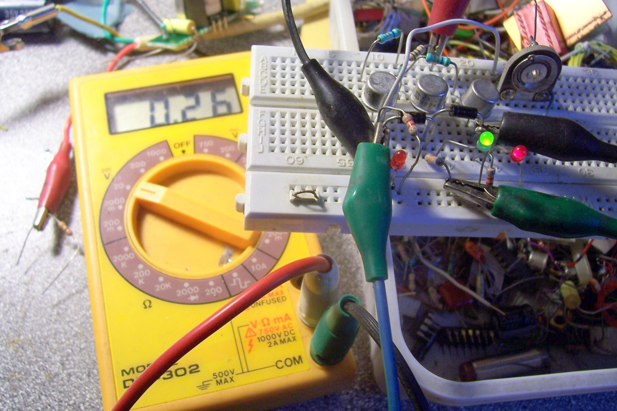

See pics for various ΔVin conditions.
Tail current=10mA, schottky=BAT43, emitter resistors=5.6Ω diodes=1N4007, transistors=2N2905
If the transistor breakdown is a problem, diodes can be added in series with the bases of all three transistors

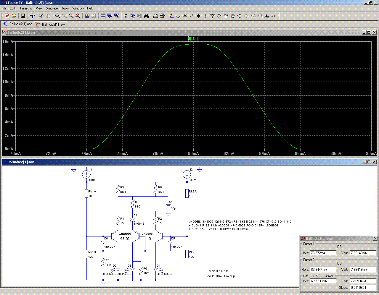

Also what changes would tighten up the on/off of the diodes,
and narrow the Green-light signal to +- 0.1v instead of +- 0.2v like I have now?
Removing the emitter resistors will sharpen the transitions.
Using a smaller size schottky will narrow the green band, but if it is too small, the current will also decrease.
In this example, I removed the resistors and placed two BAT's in parallel.
With a single BAT, it is even narrower, but we loose some mA current.
You can try to play with various resistors and diodes, but if you want something narrower and sharper than that, the sensible option is to use an IC.
