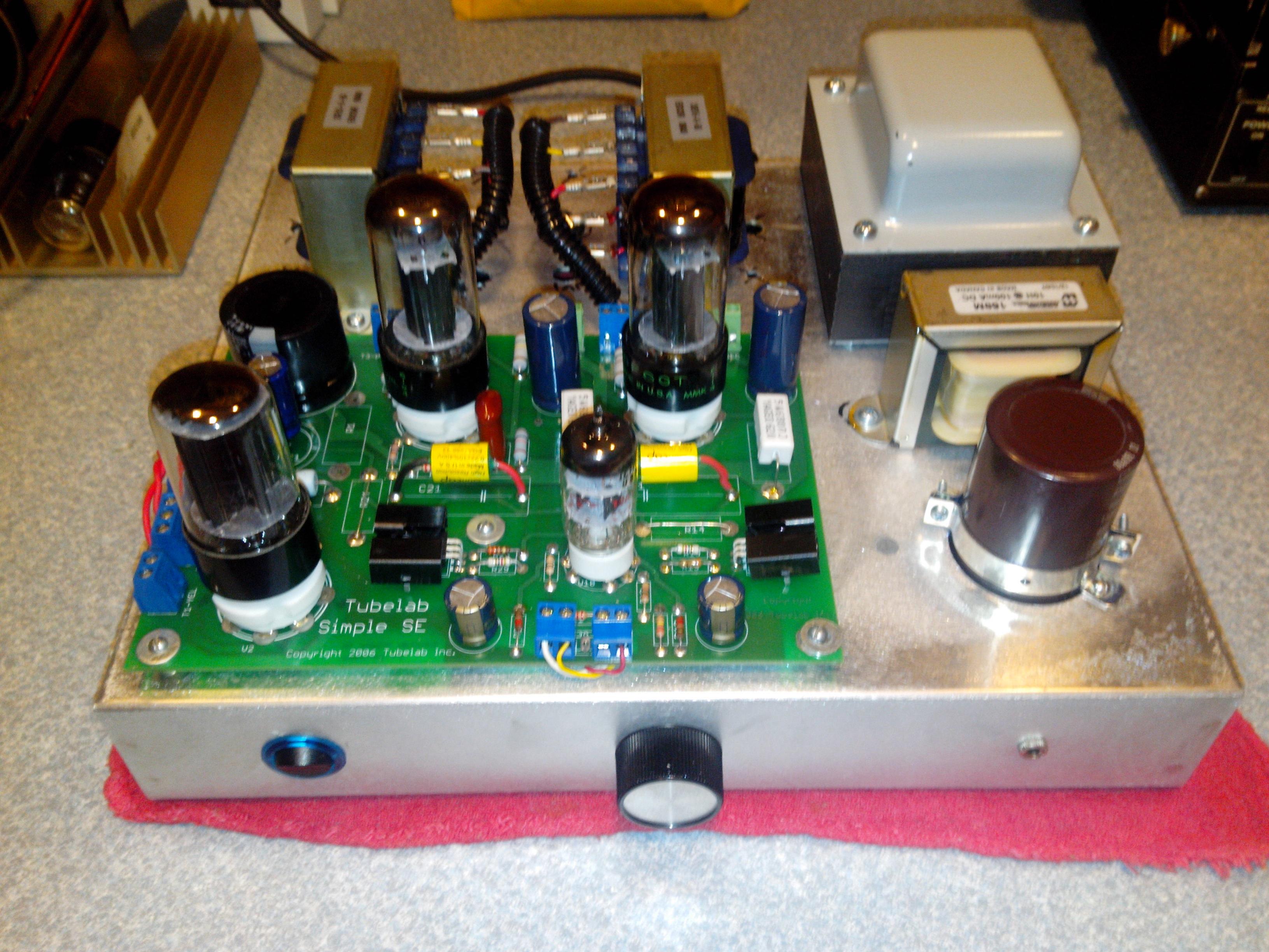

A Simple Child Resistant SSE
It's been about two years since I made any contribution to the Tubelab forum. For some time I've wanted to make a low power 6V6 SSE. The birth of our third child (almost three decades since the last :eek: ), and the arrival of his toddling and exploratory time, made a child resistant SSE mandatory. The want and the need converged, and the result is a child resistant, low power, SSE, shown here.

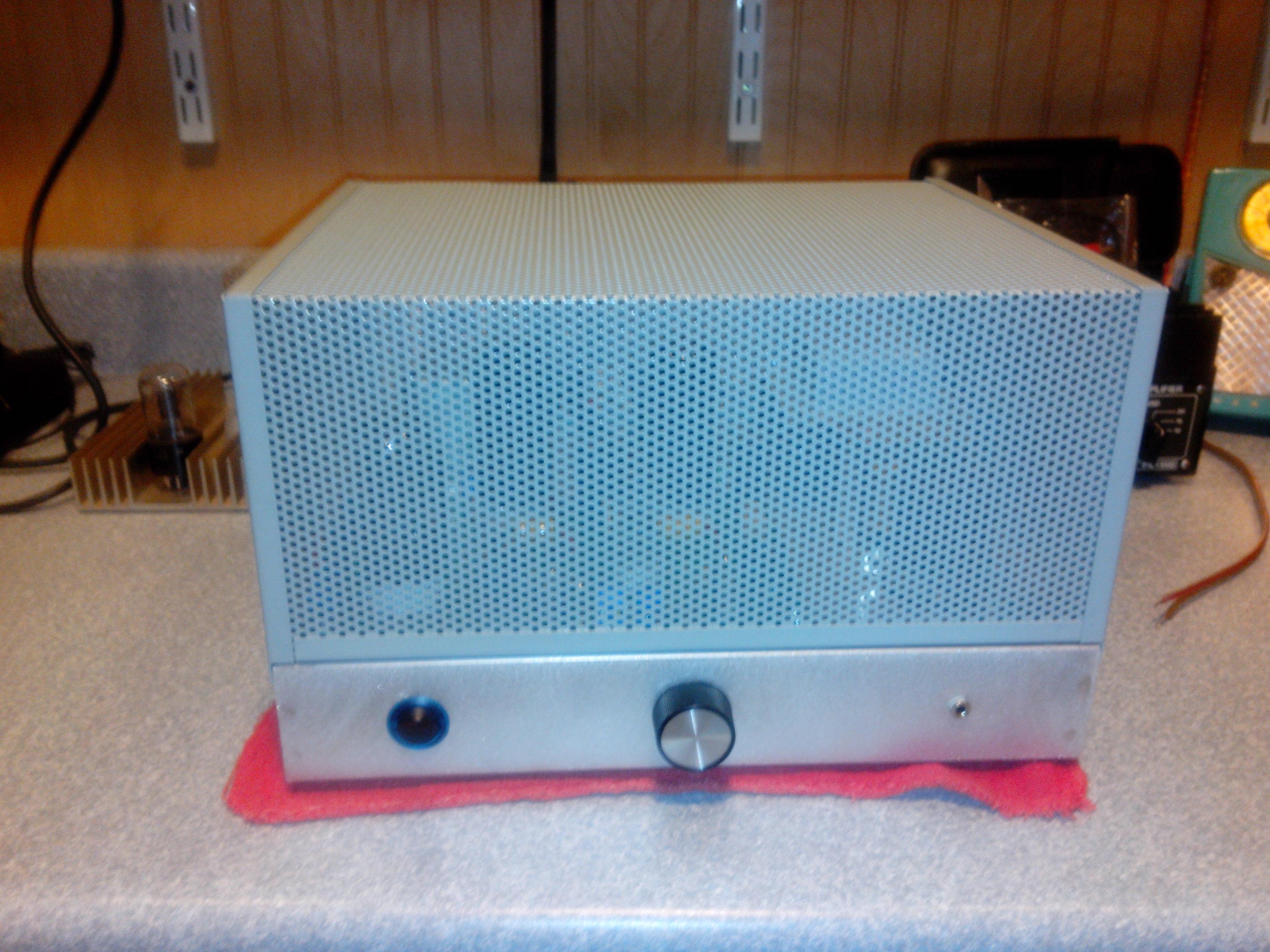

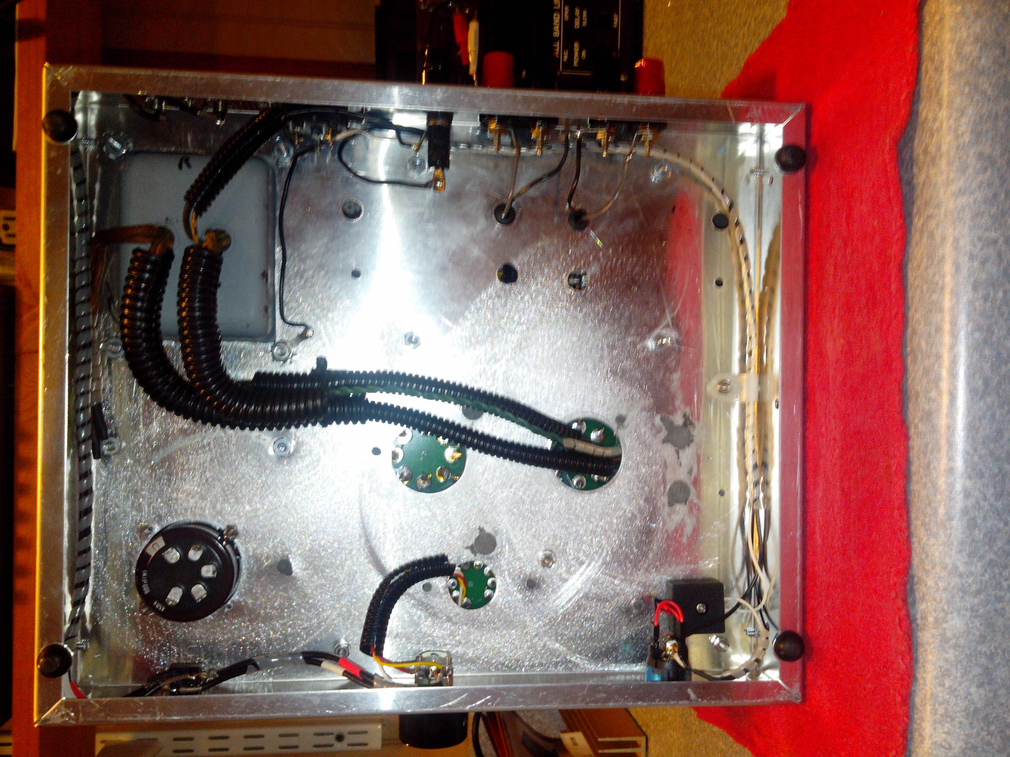

Kid protection is done the old fashioned way - an old school, perforated steel cage. These are an off the shelf item available from Hammond, in several sizes and finishes, including 12" x 10", a chassis size I already had on hand, mostly cut and drilled, the remnant of a 45 / 2A3 Tubelab SE, now dismantled. This made construction fast and easy. A few unneeded holes were filled on the donor chassis, the power transformer, a flat mount Utah of unknown vintage, was reinstalled. It is well suited for a low power SSE; it is heavy, loaded B+ output is 320 ish with a CLC circuit, and 275 ish with an LC circuit. It does not have screen voltage secondaries. Output transformers are the small Edcor XSE-15-8K, replacing the Transcendars that were used with the Tubelab SE.
A new SSE board was assembled almost in the usual manner; the dropping resistors in the CCS circuit were omitted because of the low B+ voltage. All components are top mounted for quick access for future modifications.The board is installed on top of the chassis, under the cage.
To keep heat down, initially I elected to use solid state rectification, and put a couple of silicon rectifier diodes on the board. An additional benefit of this was that the 5 volt secondary became available for other uses, including a low voltage supply for possible future solid state circuitry, or for a screen grid supply voltage. The former can be achieved by rectifying the output and running it into a voltage doubler or tripler for a solid state circuit, and the latter by combination with a second, small, filament transformer, thus:
120 : 5 = 5 : 120
and then rectifying and filtering the 120 volt AC output in the usual manner for screen voltage. Having done this previously in other projects, this yields output in the 170 - 180 volt range, suitable for small tubes like 2E26, 6BQ6, 6W6 and 6Y6 that require a low screen voltage when used as pentodes.
Later, I did decide to install a tube rectifier. To keep the 5 volt secondary free, I chose a 6AX5GT. This was selected as it can be fitted on the SSE board with no destructive modifications, needing only a few jumpers on the socket traces to rearrange the pins, and 6 volt filament power ran to pins 2 and 7 on the socket. This tube has low noise operation, and power output comparable to the 5Y3. The 6X5 can also be used without further modification, however, it has only about 65% of the power output of the 6AX5. Both of these tubes are plentiful and inexpensive.
Another oddball feature is the 3.5mm stereo phone jack on the front panel as a secondary audio input. This is wired in parallel with the rear panel inputs, a dubious practice from a technical standpoint, but one that works well in actual practice, and is quite convenient.
Presently, the power supply uses a 4.7uF first capacitor and a 10H inductor. B+ is 320 ish, depending on the power tubes. The cathode resistors are 680 Ohms. THe feedback at the output tubes is ultralinear. Cathode feedback is not (yet) enabled. This puts 6F6 at about 11 watts, 6V6 at about 10 watts, and 6K6 at about 11 watts (6K6 is an 8 watt tube). I have not tried 6G6 yet, or 6W6 and 6Y6, as the latter two require a low screen voltage and pentode wiring, or triode wiring. 6L6, 6L6GA, 6L6GB, and 5881 could also be used.
A few pictures are attached. It is rough looking, being hastily thrown together out of materials on hand, the cage being the only part I had to acquire. The large, off board, filter cap is not presently connected. It fills a hole where a meter resided in the Tubelab SE. I had intended to use it, but the amp is stone cold silent on 96db ish speakers without it, so it remains unconnected. Paint is a possibility, if the demands on my time relent at some point.
This is a nice sounding amp; the 6V6 is one of the finest sounding audio tubes, imho. It has been in service a couple of months without issue.

As you note, if it's too hot to touch, it's not suitable to be around kids.
Two KT-88's, plus a 5AR4, and a 12AT7 - probably a couple of hundred watts in heat right there, before you even get to the heat generated by the power transformer. If it's undersized, it just makes things worse. An exhaust fan might help you, but it still may be too much heat, in too small a space, even with a fan.
That's why mine is sized the way it is. Two twelve watt tubes, a 12AT7, and a 6AX5, maybe sixty five watts total heat from the tubes, and quite a bit of empty space between the top of the tubes and the cage. The power transformer is oversized, so it runs cool to the touch, and it's a flat mount - much of the minimal heat it generates is sinked to the chassis and spread around, rather than cooking a spot on top of it.
My cage runs at about room temp, even after many, many, hours of use. Cool enough that I could probably go up to the 19 watt class of tubes, like 6L6 and 5881. That's probably about the limit of the 6AX5 rectifier, although I have diodes on the board, if need be.
When I was first pondering this, I considered using an LMB Heeger CO-6 ( 9 x 11 x 6 ) cabinet. The advantage of this was that I had one on the shelf*. The disadvantage was that heat management looked dicey, at best, and I would have to use an upright power transformer, or an undersized flat mount, and the output transformers would have to go on the back of the cabinet, under a sub cabinet. It would have been do-able, probably, with a small exhaust fan, but for long term reliability and simplicity, I just went with the cage. It's working out very well.
If I were going to do it with a "big" amp, I would start with the biggest chassis and cage Hammond makes ( 17 x 10 ?) and make provisions in advance for an exhaust fan, in the event chassis size alone was not sufficient to dissipate the heat.

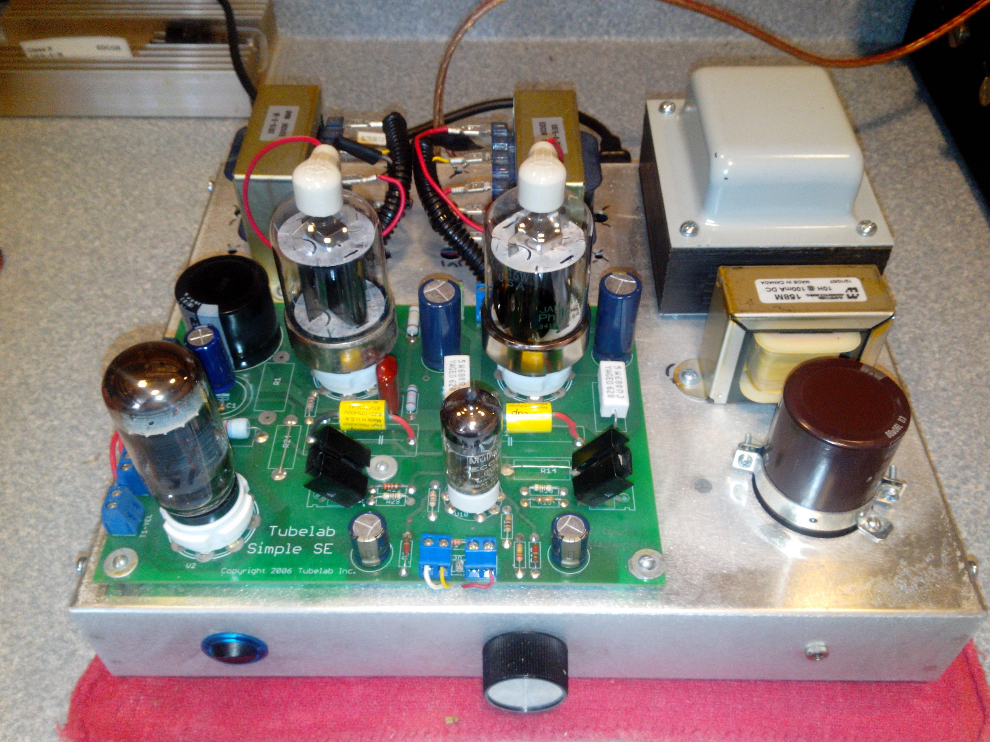

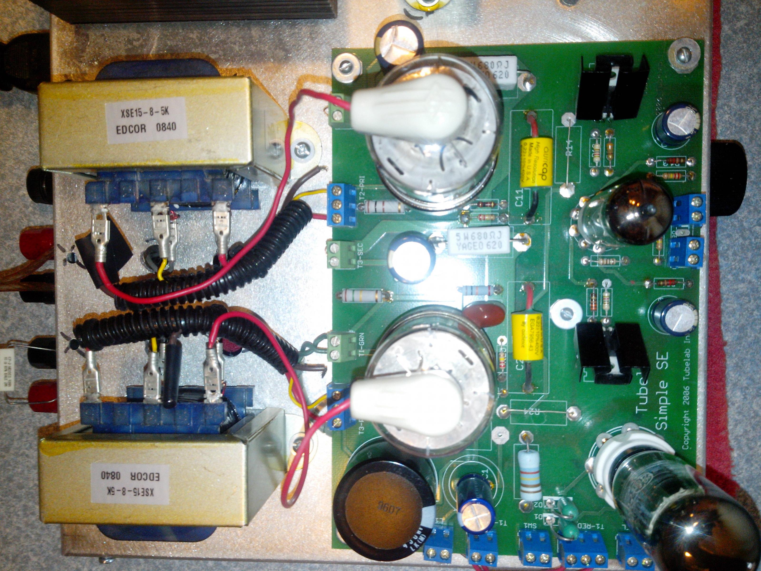

2E26 and 6146 in the Child Resistant SSE
Transmitting tubes 2E26 and its higher powered follow on, 6146, are easily adapted to the SSE board. Details can be found in an earlier thread in this subforum; briefly plate voltage must be sent to the anode cap, screen voltage must be applied to pin 3 of the power tubes, and pin 4 of the power tubes must be left open as it is internally connected to the cathode in these types. Because of the unique configuration of the SSE board, making these changes is trivial.
2E26 in the child resistant SSE:
The 2E26 has an 800 ma heater current. This is almost double the current drain of the 6V6. Data is taken from the 1947 RCA data sheet.
Ultra linear configuration:
Anode 320 spec 300
Screen 323 spec 200
Cathode 28
Rk = 680 ohms.
(28/680) = .041 (.041)(292) = 12 watts. The specification for continuous duty (CCS) service is 10 watts maximum.
I continue to be impressed at how adaptable the 2E26 is to audio amplifier service. They always seem stable, tolerant of reasonable out of spec operation, and just sound good.
6146B in the child resistant SSE:
The 6146 has an 1250 ma heater current. This is almost triple the current drain of the 6V6. Data is taken from the 1964 RCA data sheet.
Anode 275 spec 600 (CCS)
Screen 279 spec 250 (CCS)
Cathode 44
Rk = 680
(44/680) = .064 (231)(.064) = 14.75 watts. The plate dissipation spec for continuous duty (CCS) is twenty watts. It is well within all specifications. It works well and sounds very good in this configuration. RCA deemed it a compact powerhouse and it is an apt description.
Several things are apparent: First, the high perveance characteristic of 6146 - it's happily sucking down almost 65 milliamps cathode current at a mere 231 volts across the tube. It's a sweep tube and needs to be treated as such.
Second, the extreme voltage sag of the 6AX5 rectifier - when it runs past its current spec, the output voltage just falls off a cliff.
Third, 2E26 is typically portrayed as just a low power 6146, but it really doesn't behave much like the 6146. In all configurations, 2E26 behaves more like an ordinary audio tube. It has a low screen voltage rating, but it doesn't act much like a sweep tube, whereas 6146 is very much a sweep tube.
Win W5JAG

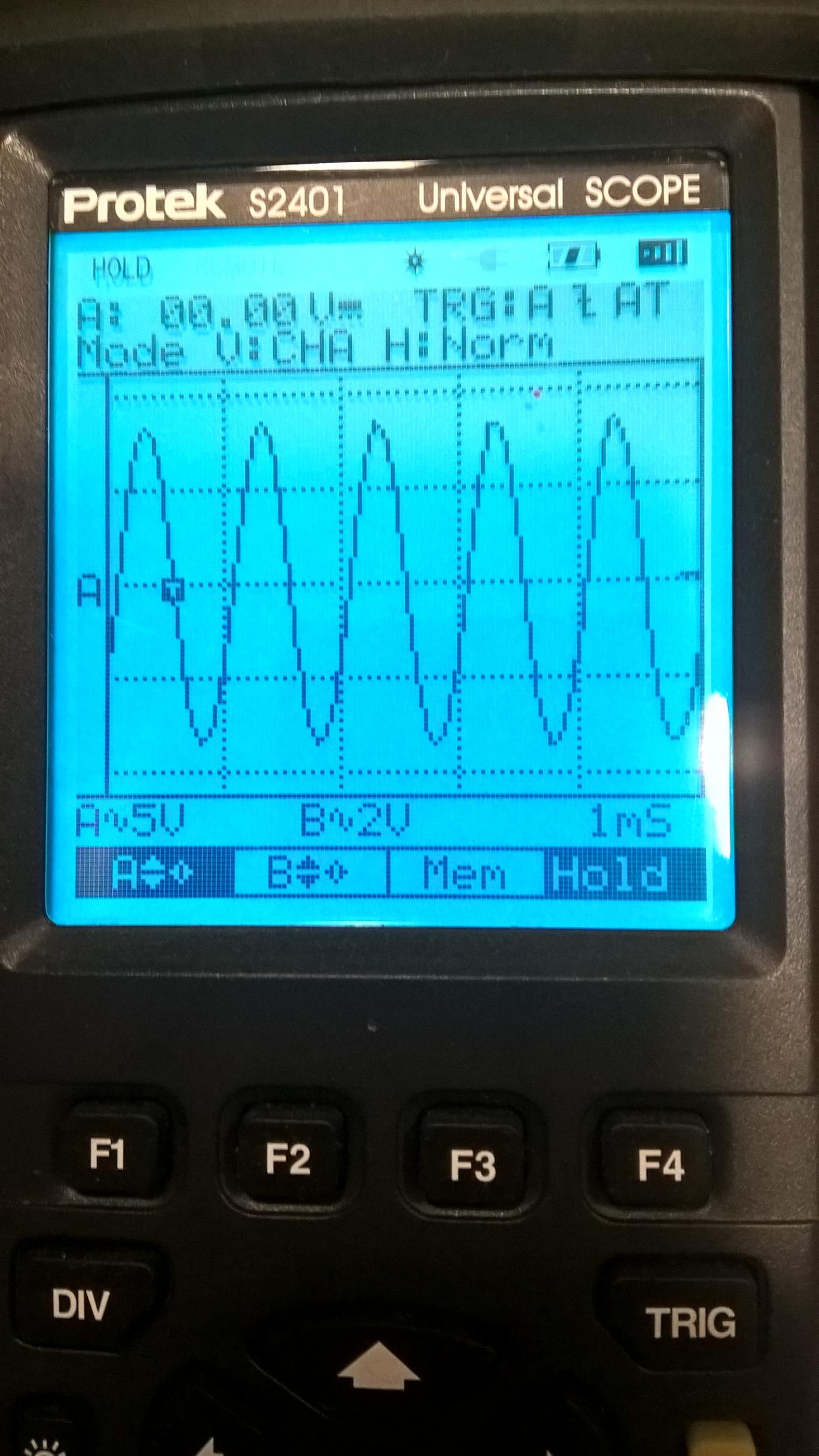

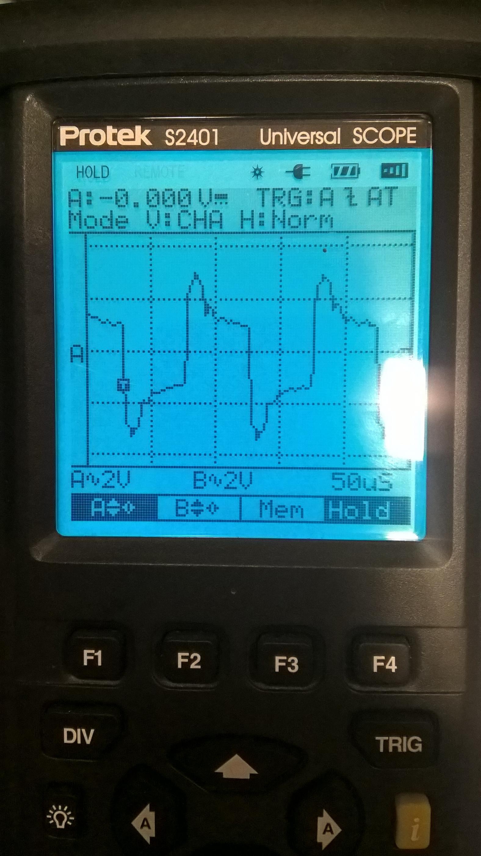

an unlikely tube comes to the rescue
Here is a tube that works really well, without any changes other than adding a solid state rectifer in place of the 6AX5.
At a plate voltage of 341 volts; screen voltage of 346 volts; the cathode voltage was 55 volts and cathode current was 80 ma. Power was 23 watts. This is in ultra linear with cathode feedback.
Look familiar? It's the tube widely thought to be useless for single ended audio.
The 6146B.
Here are the IMD numbers it put up at the above points:
At 2 watts output, IMD was 15%; At 1 watt output, IMD was 8%; At 0.5 watt output, IMD was 5%; and at 0.1 watt, it did 2.4%. Clean sine wave output was 15 volts p-p, or 3.5 watts.
That performance rivals the TSE 801, when it is running at 40 mils. Indeed, the cathode feedback cuts about 2dB of power, without that 6146B would equal the power output of the 801 amp.
It's entirely possible these numbers can be improved on. I haven't done a thing to try to optimize it.

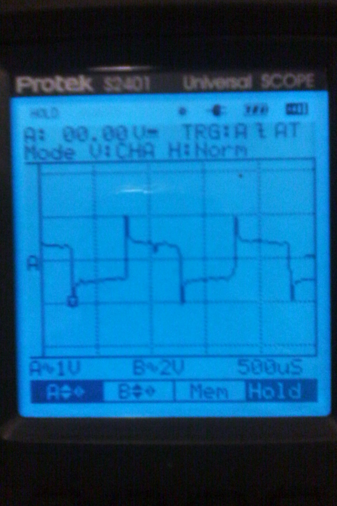

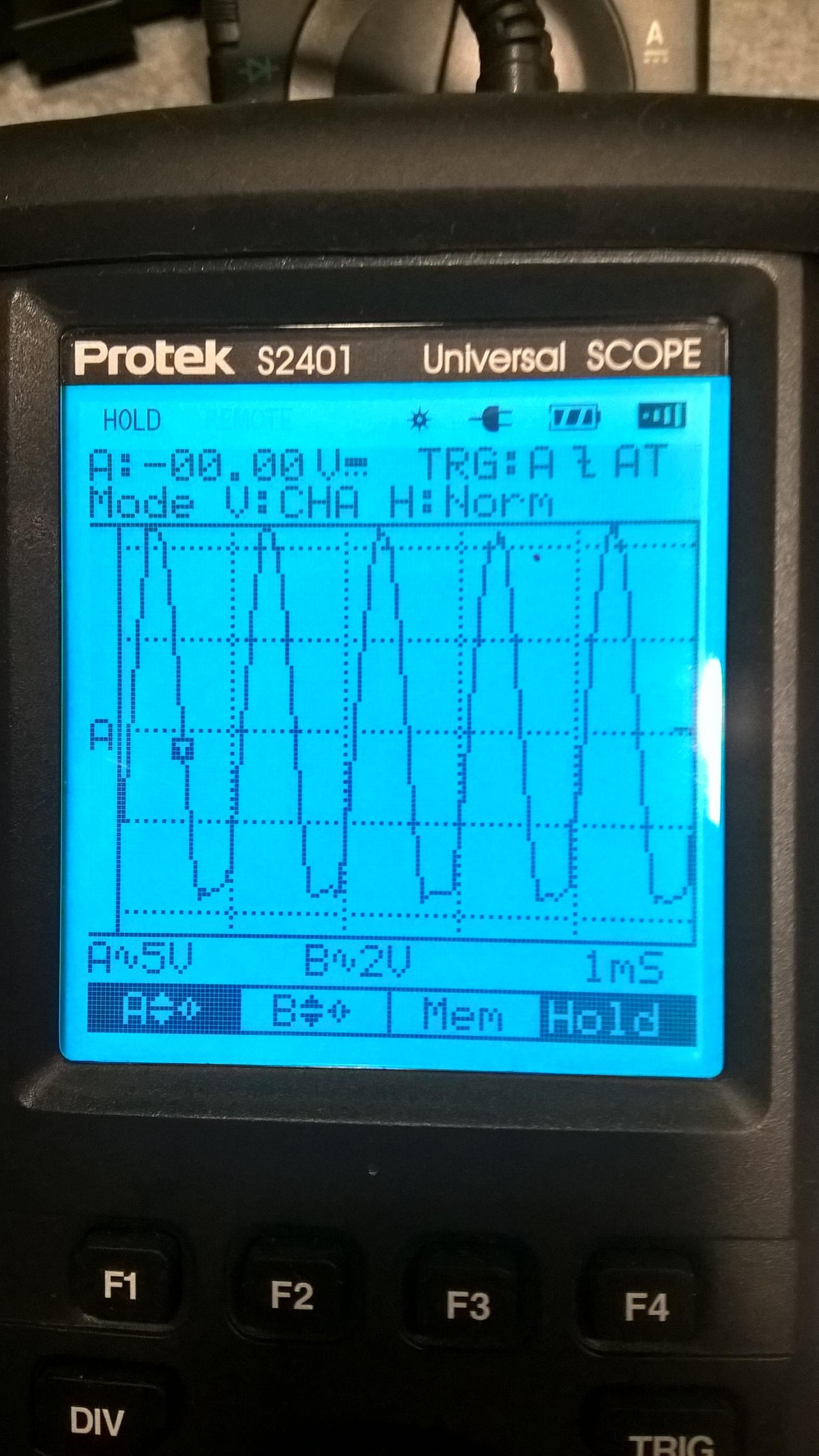

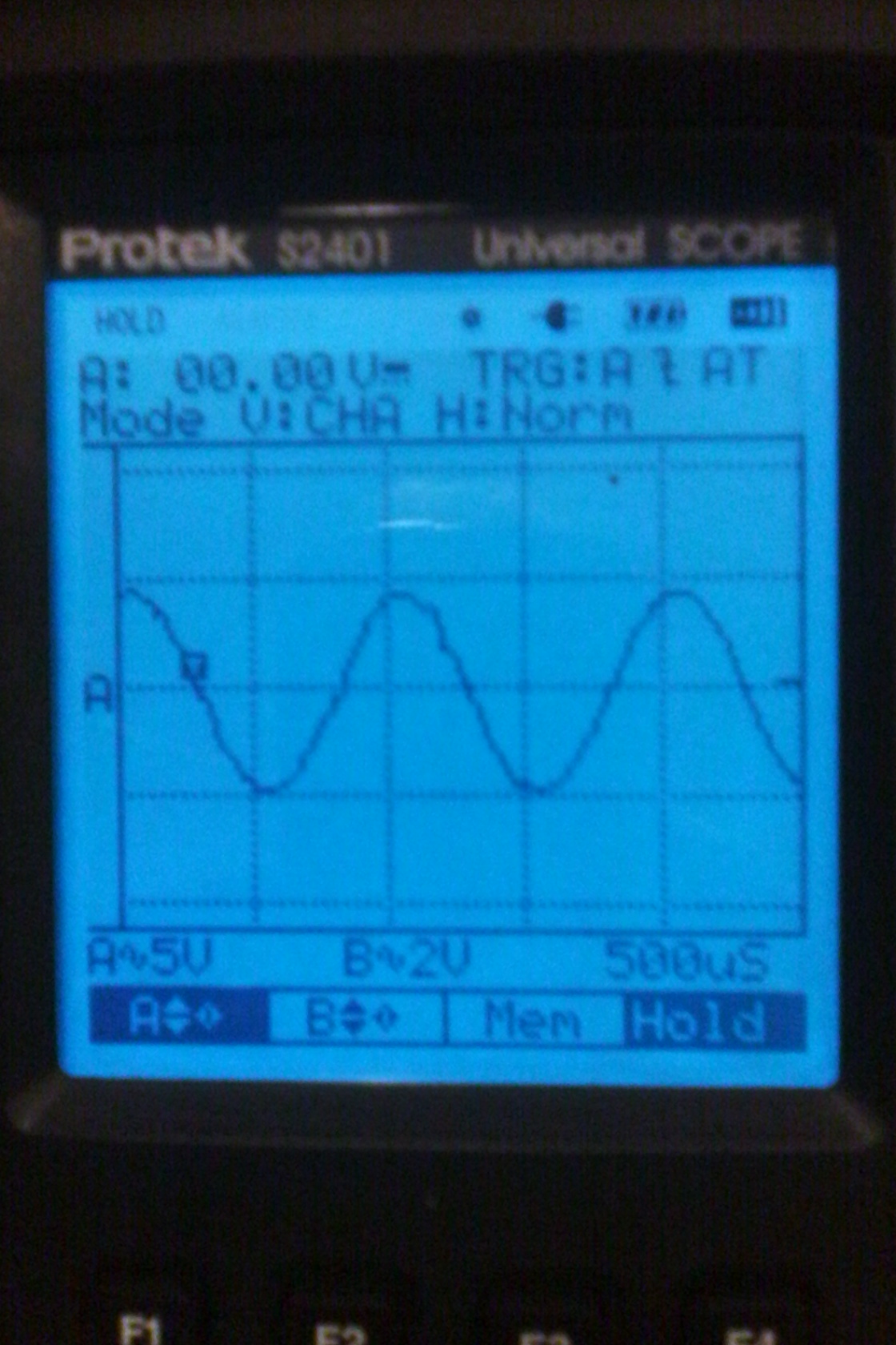

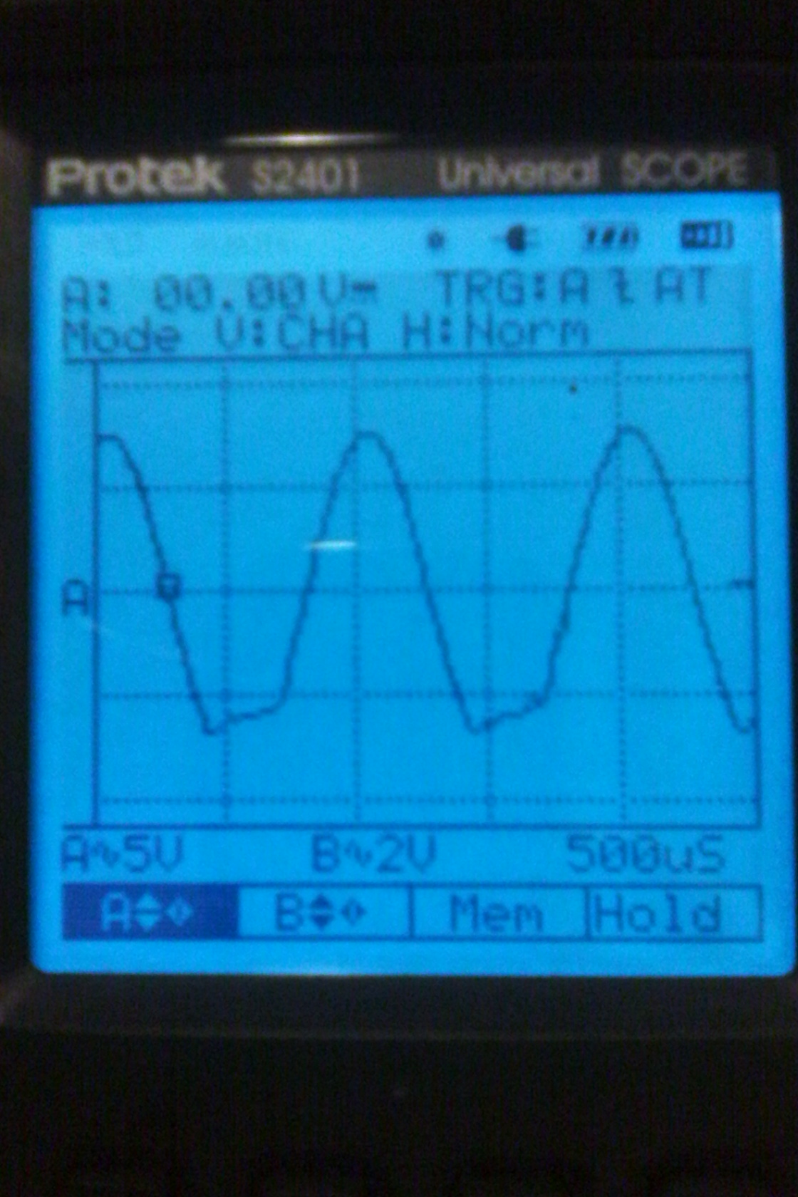

Below are a few scope shots. It clips assymetrically on the bottom. The 10Khz square wave performance of the Edcor XSE 5K transformer is terrible. I have seen this same pattern with every tube I have looked at. It is not unique to 6146.
Win W5JAG

At 1 watt output, IMD was 17%; At 0.5 watt output, IMD was 11%; at 0.1 watt output, IMD was 4.1% and at 0.05 watt, it did 3%. I did not test it for power output.
It's entirely possible these numbers can be improved on. I haven't done anything yet to try to optimize them.
I ran the 6146B for the last several weeks, and have had the Shield 6BQ6 in it for the last week.
Win W5JAG
I swapped the Hammond 10 H 100 ma choke for a Hammond 5H 150 ma choke and re ran the Shield 6BQ6. The improvement was significant
This is still in ultra linear with cathode feedback.
Plate voltage of 293 volts; screen voltage of 299 volts; cathode voltage was 40 volts and cathode current was 59 ma. Power was 15 watts.
Here are the new IMD numbers it put up:
At 1 watt output, IMD was 10%; At 0.5 watt output, IMD was 6.2%; at 0.1 watt, IMD was 2.4% and at 0.05 watt, it did 1.7%.
Undistorted single tone output was 1.6 watts. They still clip assymetrically. The sine wave is 1KHz. The "square" wave is 10KHz.
So, that was an easy change that drove things in the right direction. I haven't had time to look at anything other than the one 6BQ6 since doing the swap. Sorry the pics suck - cheap cell phone was all I had on me at the time.
