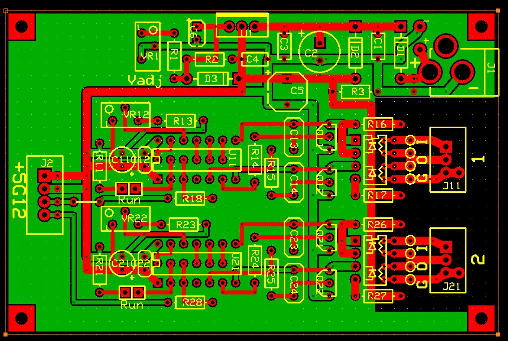

OK, this board is going to press, I can't see how I can make it any better with what I know right now.
Received some parts a few days ago that allowed me to actually test some perceived needed changes:
1) changed Vadj from single turn to multi-turn, and reference voltage is now very solid at 4.999~5.000 volts.
2) changed half of Vref voltage divider for each PIC from a fixed resistor to a multi-turn pot. This pot will allow me to set max ADC count to exactly the maximum resistance I want from the shunt LDR in a given LDR pair configuration. That will give me maximum ADC counts available within the useful range at the low current (high LDR resistance) end of the range.
3) changed the resistor driving the mosfet gates from 1 meg to 3 meg, and control is greatly improved, with much less change in LDR resistance when the mosfet is fed a correction pulse. Thus smaller pulses for finer control.
One remaining change: The current limiting resistor for the series LDR can be much greater than 150 ohms, because the series LDR will never be asked to operate at 40 ohms. I will have to find the appropriate value as the target resistor values become known, but probably will be in the range of 150 ohms for the LDR which should mean several hundred ohms in series with the LED to limit current. Again, this is in aid of ensuring the maximum number of ADC steps are available for control in the useful zone by increasing the available count at the high current (low LDR resistance) end of the range.
Moved IR control chip off the board; it was silly to divide the circuitry for that function between two locations. It'll all fit on one board together with the necessary regulator for the motor.
Now have the software running smoothly, controlling two separate LDRs simultaneously. It's obvious that the LDRs are not consistent because when the mosfets are matched delivering exactly the same current to two LDR devices, the resistance of the LDR is considerably different between devices. This is not new information, but it's interesting for me to see two devices running simultaneously with exactly the same drive current showing such different resistances on the output side.
Time to build the new board and modify the code for the new chips, and see four devices running simultaneously, responding to a single input. Once that's done, it'll be time to start writing the code to first determine the correction required for each device, then figure out how to code that correction into the drive algorithms.

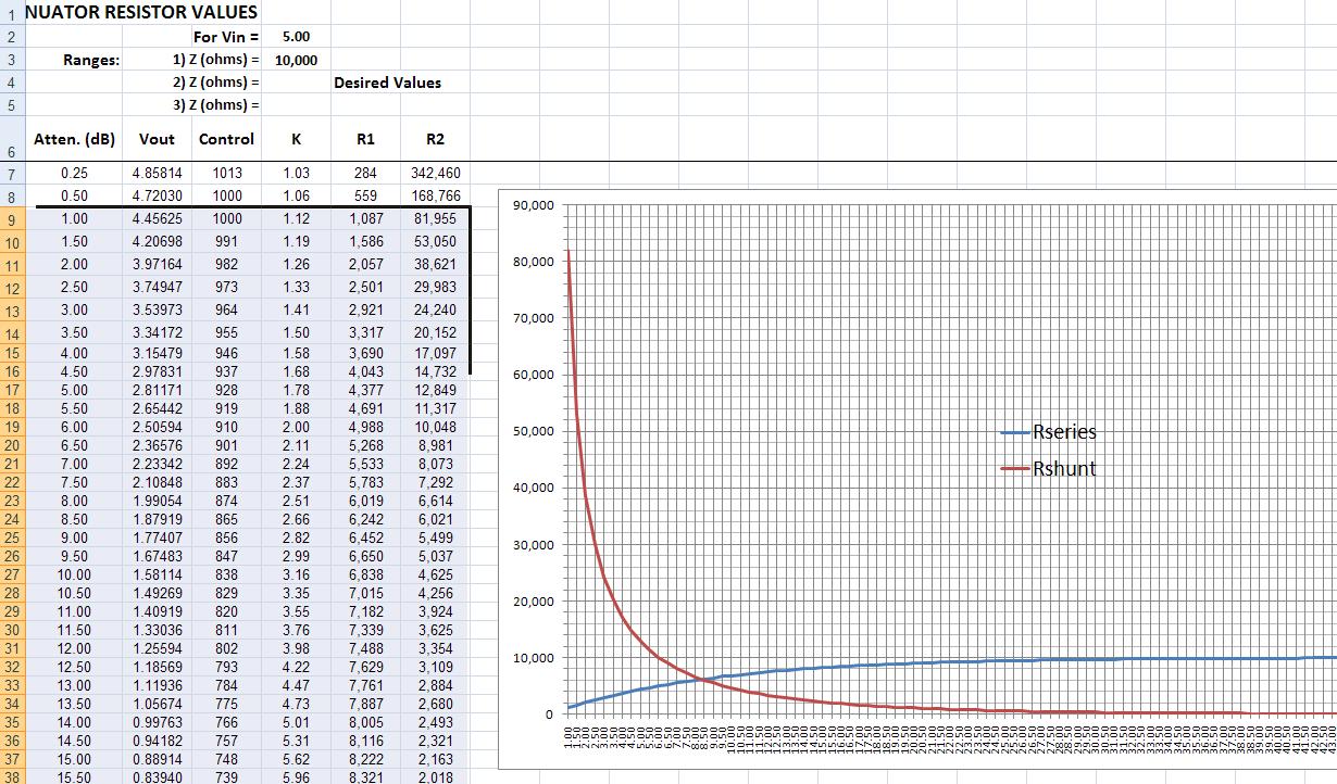

Someone posted the ladder attenuator schematic with resistor values as shown in attachment one. It has a fixed 10K input impedance and, it appears, an output impedance that is suitable to drive a 10K load.
I found the formulas used to compute the resistor values for this ladder, and did a spreadsheet. Attachment two is the resulting graph for a constant 7K input impedance and constant output impedance.
Quesstion is: Is this approach the way to go in designing an LDR volume control, or should I simply do a conventional pot where the total resistance of the top and bottom halves of the pot always equal some desired value, say, 10K?

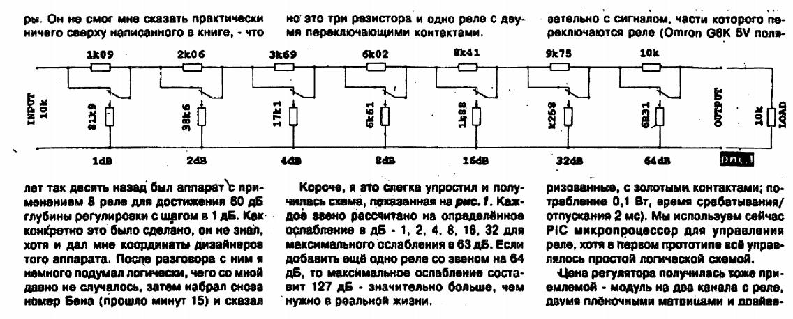

I don't understand what you have done.
Look at the relay schematic.
Discard all to the left of -64dB relay.
You are left with 10k in series, 10k as load and 6r31 as shunt resistor.
This is a T resistor network with 10k input impedance and 10k output impedance.
Now do the same for any single relay. It too presents 10k for both input impedance and output impedance.

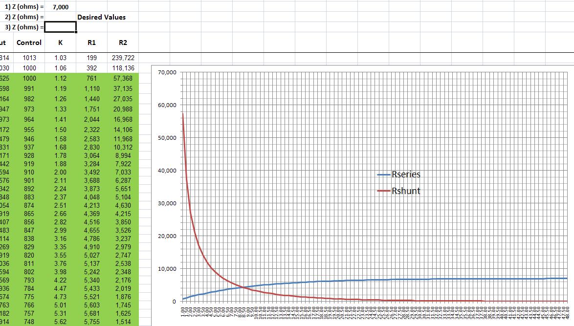

The trailing 10K (load) resistor in the T you describe is the 10K input impedance value of the load amplifier. Thus, the T is completed by the load amplifier.
I should have changed the spreadsheet to match the 10K of the original ladder design before posting it. Look at this version, with Z adjusted to 10K.
My attenuator does not go to -63dB because it is limited by the 40 ohm minimum value of the LDR. Using this design, I can only get into the 40~50 db range without paralleling LDR devices.
Look at the 1dB rung of the ladder schematic, and the 8dB rung. The resistor values are exactly the same as my spreadsheet (rows 9 & 23) and graph. The formulas I used are the same as this (apparently) well-respected attenuator design, and the curves I show are the curves created by that design.

If the 10k is the Rin of the next stage then that receiver stage does not see the 10k as it's Rs.
The receiver sees the remainder of the T without the third reisistor. The attenuator is not constant output impedance.

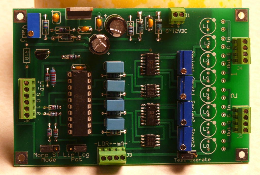

I’m shifting gears. I have found a voltage-to-current converter chip and a precision op-amp which, when paired, appears to resolve all the issues and does it in a very elegant way. Each chip will operate two channels which means one of each chip per audio channel will control the series and shunt resistors nicely.
The attachment is the new board configuration.
The converter chip will deliver up to 15ma of current without a boost transistor and is internally limited at that level. The other end of the current spectrum is set by a single resistor, and if that resistor is a multi-turn trimmer, very fine control of the minimum current is practical. It appears that about 250 ohms will deliver the current required to drive an NSL32 to about 10K ohms of resistance. A 500 ohm multi-turn seems ideal for the job, and ½ watt pots are available so power considerations are met. No other support circuitry is required, just the one resistor per control channel. Full rail input to the converter will drive the converter to full current output, or 15ma out. Slightly above Gnd, say, 10mv, will be ideal to drive the converter to minimum current as set by the variable resistor. I have successfully set the LDR ohmage level to values of 5K, 10K, 20K, and 25K by varying the value of the trimmer. Very elegant solution.
The input of the converter is rather low impedance and therefore must be driven by a very capable circuit. My original mosfet & resistor voltage divider won’t do the job. I’ve found a precision op-amp which is unity-gain stable and will drive to within about 2mv of the rails given the input impedance of the converter. That means that of the 1023 counts available with the PIC’s ADC pins, approximately 1018 counts will be available to control the level of the op-amp which will control the converter. This is the best case scenario that I’ve been able to come up with so far.
Another problem that I’ve run into in trying to control the LDR is that the LDR response is very slow compared to the response of the PIC, and the lag has caused problems in software control. In this new scenario, the PIC will drive an op-amp and converter with near instantaneous response. The LDR’s lagging response will have no impact on the feedback to the PIC, so this problem will go away.
The very high input impedance of the op-amp will be a vanishingly small load on the capacitors controlled by the PIC, so very small and infrequent control adjustments will be adequate to maintain precise control voltage levels to control the op-amp inputs. If the circuit is successful, I will probably replace the .47uF metal-film caps with 1.5uF tantalums or even 15uF tantalums with matching changes in the resistor limiting PIC drive to the capacitor. This should result in fast, accurate adjustment by the PIC followed by very long stable periods when the capacitor does not require adjustment due to the high impedance of the op-amps.
In addition to the changes to the circuit resulting from the added ICs, I’ve added a facility that will allow precision testing of LDRs using the board’s circuitry simply by moving one jumper. This board therefore can be used to evaluate and select LDRs which could then be marked and sorted and selectively installed to the board – a one stop solution. The LDR test facility is always available even after all LDR positions are filled and the board is fully functional as a volume control. If fast, repeatable testing of multiple devices is desired, it would be easy to set up a rotary switch with precision resistors to program current output at multiple levels in any series desired. If this approach is followed, the mA meter could be omitted and replaced by a jumper at the J3 pins 1~2.
I’m switching to two LDRs per position – LEDs wired in series, resistors in parallel. I find that when two LDRs are wired that way, 15 milliamps results in a resistance of about 25 ohms. That means the LEDs will be loafing at 75% of full rated brightness, and the resistance will be very usable. Due to the low maximum current used, once calibrated this configuration should last for a very long time if not forever without degradation of the LED.
The power rails -- +5V and Gnd – are wired in a star-configuration with different parts of the circuit connected directly back to the regulator’s output capacitor. Various sections of the circuit should not interact and voltages should remain very stable. The regulator circuit contains a multi-turn pot for setting the voltage very accurately. In theory 5.000V is desired, and in practice, this circuit varies by .001V only.

I have the chip successfully managing one LDR with fast, accurate control up to 10K ohms, looks like it might go to at least 15K, maybe 25K if anyone wants a pot with that kind of resistance range.
Have just populated the board with the other three LDRs with a view to testing out the control of four devices at once, which is the standard required for stereo. Working on the pseudo-multitasking aspects of the software now.
BTW, the board which I have shown as the latest turned out to have a fatal flaw, am talking about, and currently working with, an older version of the board. If the multi-tasking works out well, I'll build another prototype of the board.
