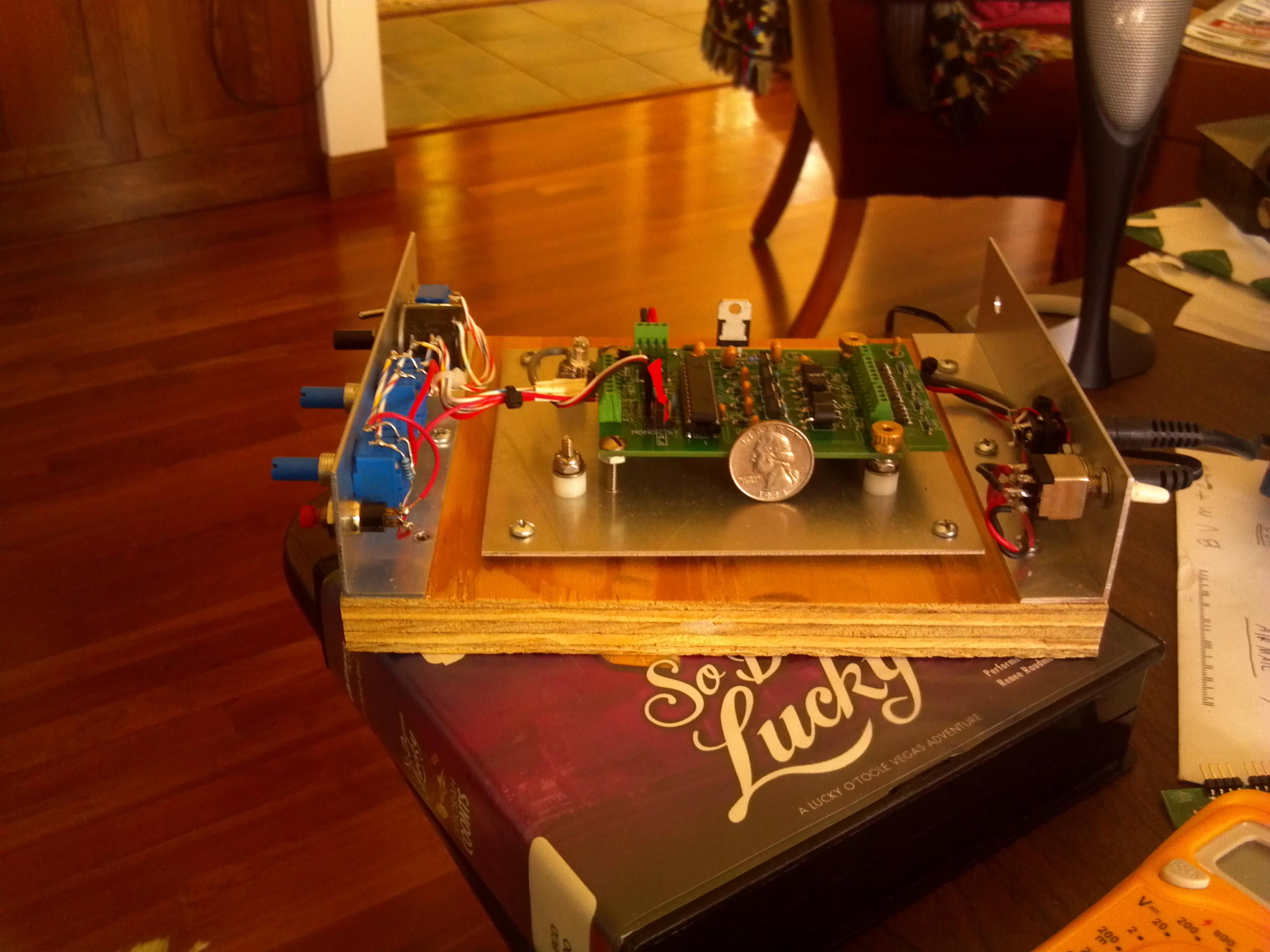

Here is a picture of the prototype that I used to develop the software. The 25-cent piece gives you an idea of the diminutive size of the board, considering it contains all the processing power and precision drive components for a full stereo volume/balance control. The main board is the part between the two sets of mounting hardware, the board to the right of the brass knobs is actually a daughterboard not used during operation.
Two one-turn pots and pushbutton on left panel are for volume, balance, and mute; the third pot is a 10-turn pot which I can switch into the circuit for precisely viewing small changes to data values as the circuit runs.
The very thin (.5 inch wide) board attached to the output side of the main board on the right is the daughterboard that is required to be connected during the calibration cycle.
Calibration time, by the way, has been increased from 7 minutes to about 20 minutes -- this greatly increases confidence in the result of the calibration. This circuit produces virtually no heat and current is limited to about 10ma maximum per device, so aging of the LDRs will be slow if it happens at all. The mute circuit will kill sound with 2ma going through the shunt LDRs and zero current through the series devices, so muting the circuit will not age the LDRs.
The power supply has been extensively modified and in the next iteration won't look as it does in this picture.
All connections are via Euro-style screw terminal that will accept wire or pin connections. The calibration daughterboard and the IR daughterboard (to be attached to the left side) both have in-built pins that exactly match the main board connectors so that there will be no fiddling with individual wires or cables to connect them.

Very nice indeed - complete as a 'stand-alone' item, with the option of additional remote control - complete module, nice and simple - love it!
The input/output plugs just attach where the calibration board is plugged in, as per the right hand connector in the photo, yes?
Does the remote control board use the main power supply, or have it's own regulator, etc,

@James, yes, to switch from calibrate to operate you move one jumper and remove the calibrate daughter board and connect the input/output wiring in its place. Best to use a row of pins and connect i/o wiring to the pins as I have done for the pots and mute in the photograph -- that way you don't have to worry about getting wires in the right order, you just wire the solid block of pins and the wires are automatically correct.
The remote board uses the +5V regulator on the main board for the PIC on the wireless board and the logic part of the driver chip. The motor drive power comes from a separate regulator on the IR board, and that's easy to implement because when the IR daughterboard is attached the DC IN connector moves from the main board to the IR board (all the connectors on the main board are duplicated on the IR board).
That's a neat idea about connecting the in/out plugs - looks like you've just about covered everything
As the calibration is an occasional thing, would it be possible to put a row of blank holes along the front side (in the photo) of the pcb to 'plug it in' (storage) when not in use - I tend to put things like this 'in a safe place' and totally forget where I've put them - maybe other people might have the same problem ...
