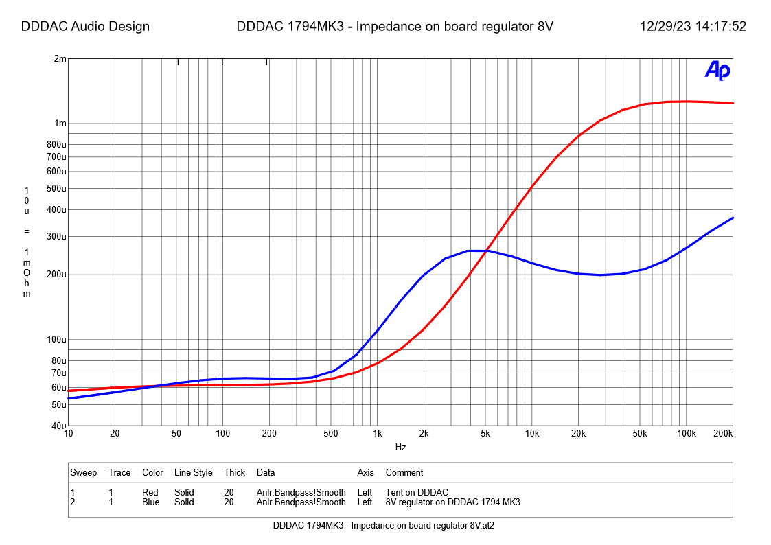

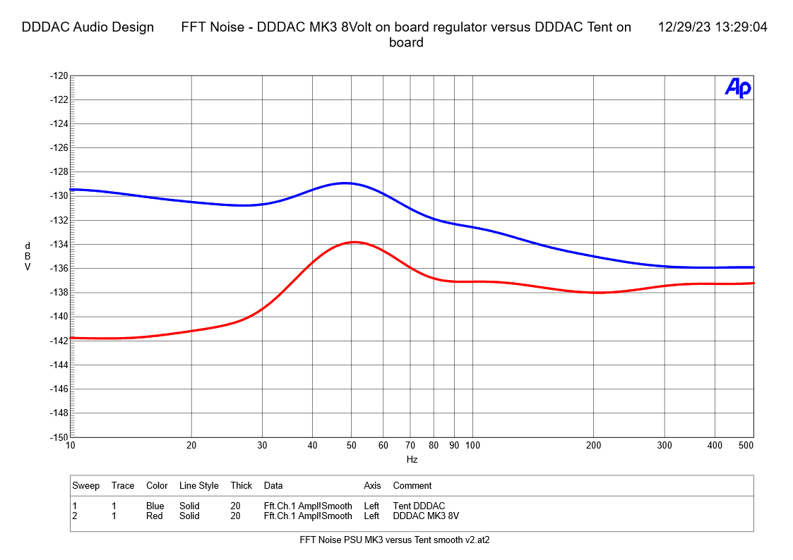

Please see the two measurements I made in terms of improved low frequency noise and output impedance of the on-board regulation solution.
Doede

- For both analog and digital an out of datasheet context implemented linear regulator. Goal: Lower noise in the very low noise frequencies and lower output impedance over a wider frequency range. Based on my long year discussions with some experts, this targets Jitter, digital signal integrity and analog signal handling.
Doede

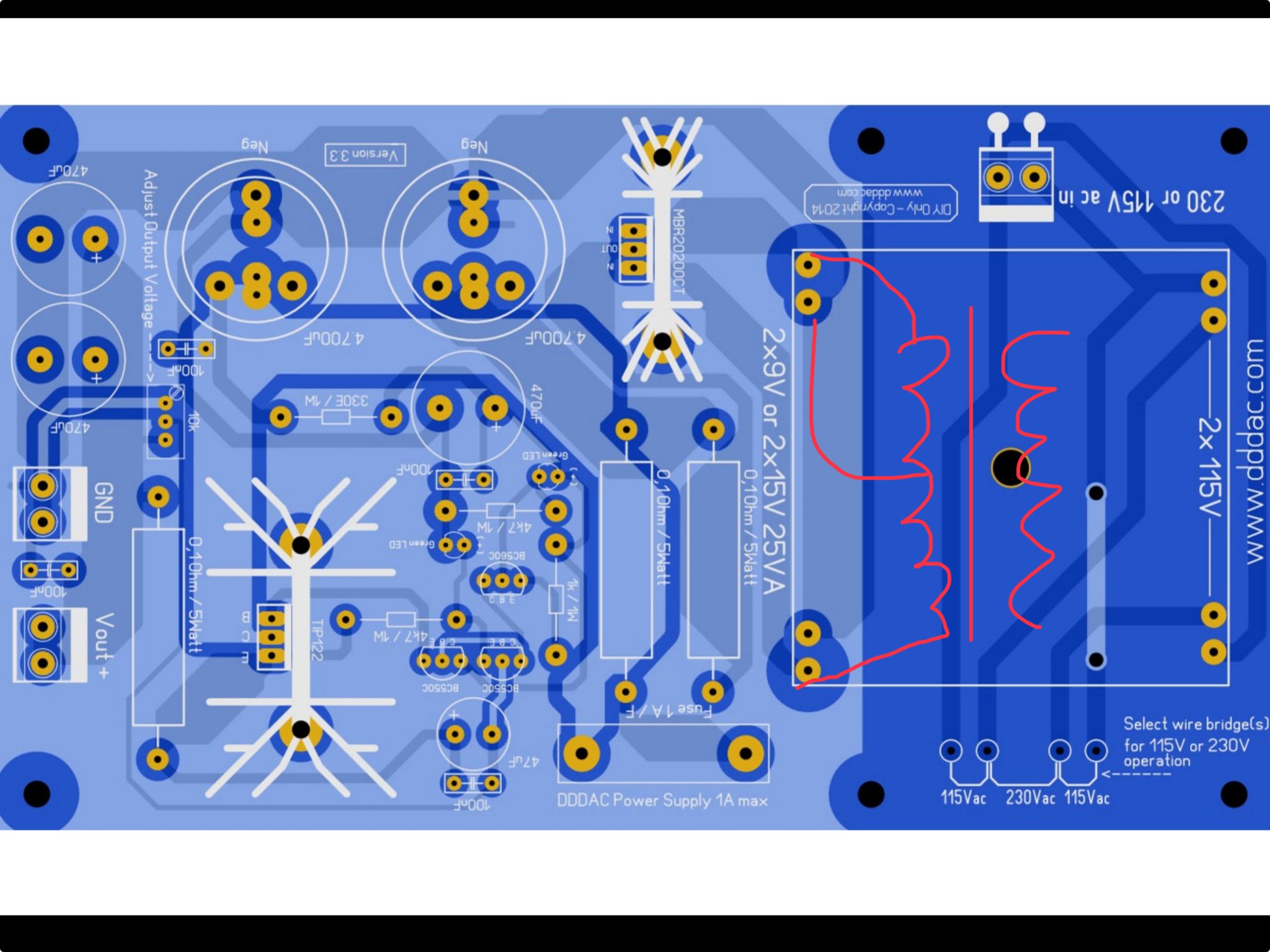

So I managed to find a 0.4R DCR 20mH/3A choke for the PSU. I got the 12V pcb from Audio Creative today and I populated the whole board. I did not go for the Blue Talema transformer and got a custom 15-0-15V transformer made. Here is the picture of my transformer. Can anyone guide me how to wire the secondary of this transformer (15-0-15) to the PSU PCB?
You were close to making a mistake.
15-0-15 is different than 2*15v.
Luckily, Doede's PSU are designed with a full wave bridge with two diodes, so creating a centre tap.
Verify with your DMM that both "centre" holes for the transformer secondaries are connected together. If so, the violet wires go to the outer holes, and the grey to one of the inner
