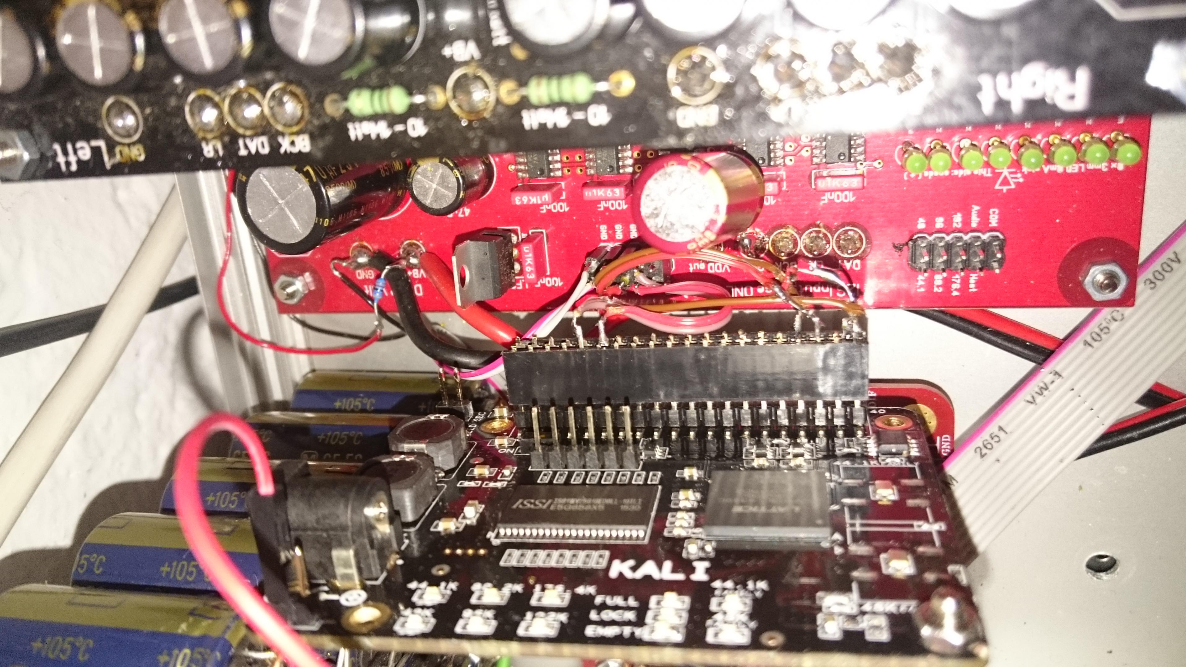

I attached a photo, which essentially shows that I did a pretty messy job. However, I managed to keep the I2S wires short, and with dedicated signal returns for all I2S lines. The Kali pinout is available on the Allo website. I figured out the GND connections on the Kali by checking the pins for a connection to the 0V pin on the Kali. You could also check the pinout on the RPi/Sparky for the I2S and GND pins.

Well... the Kali is promising; I can certainly understand the reports of more "realistic" sound reproduction with the Kali. But something is not yet right. I get a very faint crackle when music is playing. No crackling when music playback is stopped.
I had a very similar crackling when I upgraded my red-board DDDAC with the 1/2-clock delay, but didn't upgrade the Vdd from 3.3 V to 5.0 V. Back then, this was (seemingly) fixed by upping the Vdd to 5.0 V as on the newer blue boards. Mostly, anyway. I did get some crackling out of the blue a few months back, which magically went away after a while...
Since I was stealing the 5 V supply for the Kali from the DDDAC Vdd supply, I suspected I ran into a similar problem with the Vdd supply on the DDDAC. So I added a dedicated 5 V supply for the Kali, leaving the DDDAC Vdd alone. The crackling was still there, no change. If I revert to the standard WaveIO-DDDAC setup without the Kali, the crackling goes away. This might mean something is wrong with the Kali/setup, but I am not totally convinced. Something might be slightly wrong with my DDDAC, since it does have a "crackling history"...
Does anybody have any suggestions where to look and how to debug this?

Hey Mbrennwa - updates from my end. Sparky SBC/Kali setup done with jumper wires going from i2s to DDDAC's i2s. Figured out the connection pins from Allo's website. Used Volumio software for playback. Setup then is:
Sparky Single Board Computer's USB with FLAC music -> Kali ->i2s Connection ->DDDAC.
Observations :
- Getting the same crackling sound that you are getting.
- I use the Red motherboard too but never did the 1/2 clock mod. I already have the 5V regulator in place of the 3.3V original one.
- I also get the crackling sound from one channel, i.e., left channel in my case.
- Kali's Lock LED is absolutely stable.
Conclusion 1: It is not a fault with your DAC motherboard since I am getting the exact same issues as yours.
Now I started to find other possible solutions as in-line resistors did you no good so I dont even want to attempt that solution. Re-reading the posts on this subject, I paid attention to ed linssen's post "mbrenwa

Hmmmm. If I only knew how to get access to my WaveIO and change the settings... how on earth can I do this without a Windows computer?
But then again I am not sure the 24/32 bit setting really is the problem. With my WaveIO connected directly to the DDDAC I get no cracking at all. If I insert the Kali for I2S reclocking, the data stream (bits) should not be changed at all, except that bits are clocked with less jitter. If the WaveIO outputs 32 bits, the Kali will also output 32 bits (and the same for 24 bits). I don't see how changing the format of the WaveIO data output could change anything related to the Kali. Or am I misunderstanding how the Kali works?
Without the 1/2 clock mod, you are essentially driving the I2S output of the Kali into the RC delay circuit (the crude 1/2 clock delay method used on the read boards). Could it be the Kali is a bit more sensitive to the impedance it sees on its output than the WaveIO?
Did you use individual signal returns for all your I2S connections between Kali and DDDAC? How long are the cables? Do you have a photo?
