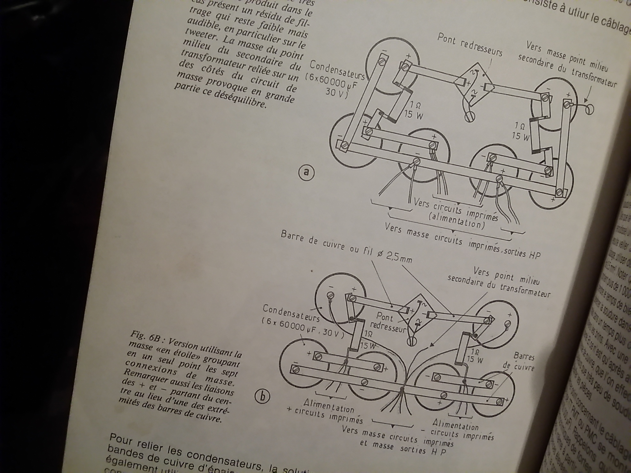

Connecting caps
Hello,
Found the info about how to connect the caps in a power supply.
This is about the hiraga power amp. It is a symmetrical power supply with high current running because it a class A design.
The drawing on top is the original set up.
The one below the modified which gave better results. It is in French but even if you cannot read it it still can be understood.
The caps are back and are interconnected by thick copper bars. The two drawings use the same copper bars. The only difference is the exact location where the circuits are connected and we're the final caps are "" reloaded"" by the first cap after the rectifier.
You see it is not only the "" star ground"" which is important.
Greetings, eduard

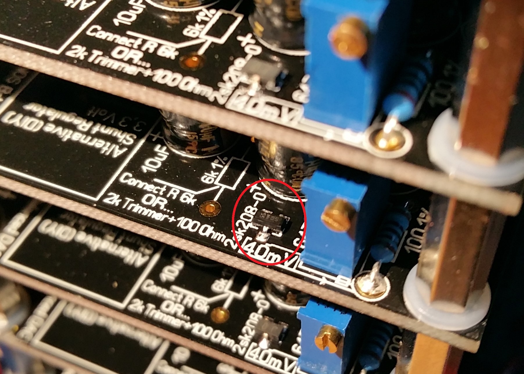

Yes... I noticed. I was afraid something was wrong.
1. Why twice the older DDDAC ? Same DAC, still?
2. Is it the effect of the Tent-shunt ?
3. And the standard 12V DDDAC PSU will not work. I will inform Marco about this, so they can correct the text on the website.
Thanks, Hans
1.Shunts take extra current to make it work as shunt ...
2.It IS a 100% identical Tent Shunt. It is under licence and embedded on the Board
3. It will do for 4 Decks. Any thing else needs a bigger transformer and bigger heatsink. The rest of circuit on the dddac power supply is up to it

Hello Hans,
So strange it is both channels on one deck. Are you the trimmer and the 100 ohm are the right value and that you did not install the 6Kohm resistor.
I hope i will not run into something similar after connecting 4 deck board to the power supply.
Greetings, Eduard
