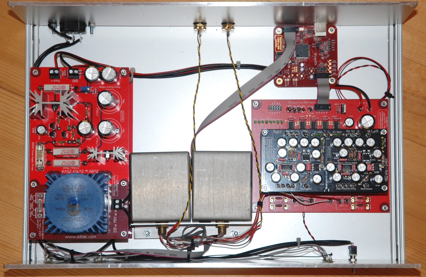

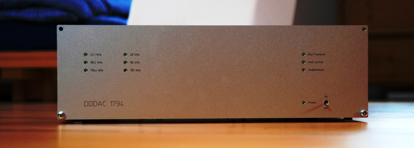

here is a very nice DDDAC "Schaeffer Design" from Switzerland.
DDDAC1794 - 4 Deck
5V DDDAC Power supply
12V DDDAC Power supply
Sowter Outputs Transformers
On the Transformers I got this Feedback :)
Update 11.3.2013: Doede sent me two Sowter 1298 transformers, which he designed as an alternative to the standard coupling capacitor in the analog out line. Apart from avoiding the coupling capacitor in the signal, the transformers also allow using the inverted output of the DAC chips, thus cancelling out even-order distortion. I immediately noticed the sound improvement with the transformers. The music sounded as if the musicians just got a pay increase! The transformers were expensive, but the money was well spent in my case.

I order my case at AE Europe, a very good transformer maker in the Netherlands. It is this one
De transformatoren specialist, transformatoren voor iedere toepassing
Only not with picture, but just look at my build DAC's (2 already). Now both have there mundorf silver/gold/oil cap so soon I can make a real good review between on deck, and 4 decks.
:cool:
The Sowter transformers are on my wish list. :)

Anyone tried the Sowter output transformers or other transformers with the DDDAC?
My Alix/mpdpup is connected to the dddac with two boards.
I use the dddac power supplies 12v and 5v with minor modifications (black gate non polar antiparallel on output, film cap not soldered and elna silmic for the big caps.)
The alix is fed with a tent power supply.
Two extra boards with sowters are on their way to me (hopefully soon).
I also plan to mount tent shunt regulators on the dac boards, I wonder what that will do with the sound?
The sound is already pretty good and is a close match to my cd player/ dac combo but I hope this will improve with the planned modifications to exceed the cd player/dac performance ( I have a feeling that it will :))
