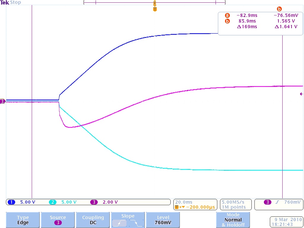

Hi Owen,
I was looking at the circuit and it occurs to me that the time constant for the gate voltage is much longer than the supplies coming up. Therefore, I would suspect that upon power up the voltage at the source of the MOSFETs would start off negative (because the gate starts at ground) and then slowly rise up to the steady state value as the gate capacitor is charged up.
I am using the PCM1794; and I fear that during power on the current output pins of the DAC chip will be "pulled" negative for a short time. The datasheet specifies a maximum of 10mA current on any pin. I plan to run a simulation of this, but I do not have a model for the DAC output.
Preliminary calculations say that if the DAC chip has an internal diode to ground (for ESD protection) the current will exceed MAX ratings. esentially you have a 400 ohm resistor to -18V for some time until the MOSFET turns on and stabilizes.
Just thought I would mention this to you and see if you thought about it any. I don't see an "easy" solution and I will most likely try the circuit anyway. Hopefully the DAC chip can handle this transient without damage; unfortunately, it can last a long time depending on the time constant used to filter the DC bias on the gates.

Jmertz: Very valid concern, and excellent question. I pulled out the scope, and measured the transient at the input during startup. I've attached the screenshot from the scope, which was taken under normal startup with no DAC attached. The input node swings negative to about -2.9V (this is worst case, I tried it about 20 times on different inputs) before it climbs steadily up to 1.65V. I'll have to consult the datasheet for the DAC, but it should be fine. I might try again today with the DAC attached just to see how that looks.

Thanks Owen,
If you get around to powering it up with the DAC chip connected please post the scope shot. Thanks!
Unfortunately the data sheet for the PCM1794 is not very detailed. I think the only way I will know is to try it.
