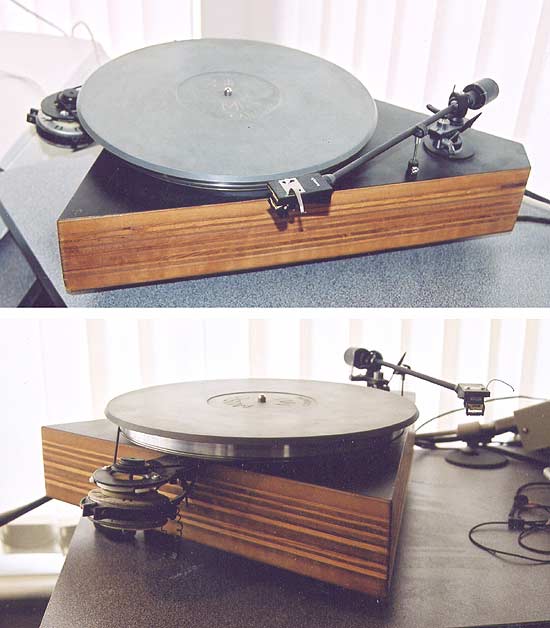

I have the skeleton from one of those awaiting a replinth. I was thinking of something along the lines of what i did to this Connie....

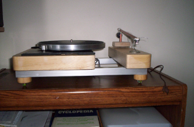

and of course Dave's replinth is very nice.. I made mine to fit my 14" (effective length) DIY tonearm

Thanks for the response guys, and I do have to say Nanook yours does look pretty. I have had some thoughts and am leaning towards sourcing a solid hardwood slab and getting the correct hole cut out of it. I like the look of the metal subframe you use. My biggest issue is that if I went for wood, a finish that matches my speakers would be the best but they are maple and an usually white maple at that. Also, exotic hard woods are not that easy to come by in the UK and I don't know what issues would be involved importing. The subframe would also support use of a circular or triangular plinth (with power dismounted to a separate box) but I would like to stick with square.:)

my slab was a cutting boartd I bought at a discount shop. 1-1/2" thick, and square. it is a hardwood, and unstained. I may finish it with teak oil (one of my favourites)
I paid something like CAD $12 to $15, (I can't rmember but it was cheap), so under 8 quid for you. Check out Ikea or Habitat or similar in the UK.
The aluminium was sourced at a local hardware stor, 1" square tubing. The feet are from the cutting board.
The "split plinth" was required because of my DIY 14" (effective) length tonearm. A nice side effect was a little isolation from the motor assembly.
Dave's table may represent something similar in dimensions to what you may need. Also have you checked out vinyl nirvana ? AR specific stuff there..

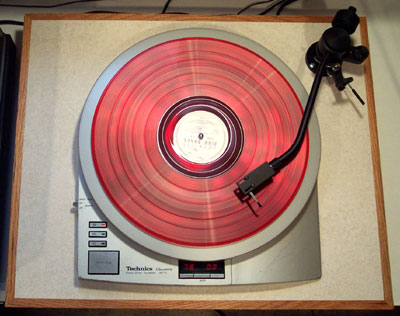

I have a Technics SP-15 that I got free from a local radio station. After making a couple minor repairs, I built a plinth, since the turntable had been mounted into a hole in the radio station countertop. I used two pieces of scrap kitchen countertop MDF material, laminated together and edged with solid oak strips. It's 17 1/2" x 21" x 1 5/8" thick and provides excellent support for the turntable and tonearm. This setup is dedicated to 78 rpm/historical recordings playback. Here's a picture.
