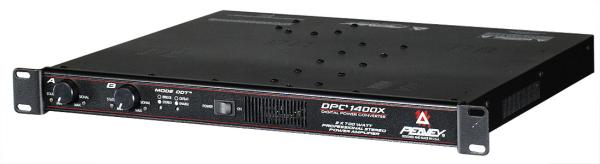

I once saw a proposal in a book (by Ben Duncan ??) that was called ampliverter. This was basically an SMPS capable of positive and negative putput voltages, by using some sort of selectable rectifier on the secondary of the transformer. That way it was possible to use an SMPS transformer of the usually small size.
Keep in mind that if you had to transform the output signal right after an ordinary class-d amp (running at a high voltage) you'd have to use an ordinary sized audio transformer.
Another topology is used by Peavey. They use two SMPS that are running a the same frequency, both at a constant duty-cycle of 50%. One of the "carriers" is modulated in phase, proportionally to the input voltage, and the secondaries of the transformers are summed by synchronous rectification. After the rectification you have a PWM signal which can then be low-pass filtered in the usual way.
http://l2.espacenet.com/espacenet/viewer?PN=US4992751&CY=ch&LG=de&DB=EPD
Regards
Charles
Hi Charles,
your description is not entirely accurate. There is one primary oscillator runing at 50% duty cycle. Secondary is demodulated by bidirectional switches run at 50% duty cycle and phase shifted towards primary. I have extensively simulated topology in 1999 not knowing it has already been patented :bawling: . It has some interesting properties like doubling of filter ripple frequency and zero voltage switching for some of the switches. The only difference with the patented circuit was that i used back to back (source and gate tied together) connected mosfets for bidirectional switches instead of mosfet inside diode bridge as Peavey uses.

I worked together with Brian Attwood for a couple of months during the research phase of a class d project some years ago. We had some interesting luch time discussions. :) He is a very pleasant man of high integrity (although a little bit of a lone wolf). I specifically asked him about that design one day because a friend of mine had done something very similar in order to make a sine wave dc to ac inverter (he used back to back mosfets for the bilateral switches).
My friend could not come up with a simple, passive circuit to recycle the leakage energy dumped when the bilateral switches turned off and ended up using clamping diodes to a couple of caps that were then bled off back to the input by a separate little power converter. After much blood, sweat and tears, my friend got his prototype working reliably, but concluded that it was more expense and trouble than the traditional sine wave inverter approach using an intermediate high voltage dc link. :eek:
So, Jaka, how did your design deal with this problem?
By the way, Brian Attwood said that he thought that perhaps the main advantage of that class d amp topology was that a lot of the non idealities (offsets, delays, etc.) in the two phased carriers tended to cancel each other in the final output. (Never looked into it myself - what did you find?)
Regards -- analog(spiceman)
Jaka Racman said:
Do you know if the patented circuit is actually used in a product?
I guess it is this one: Peavey DPC1400X
