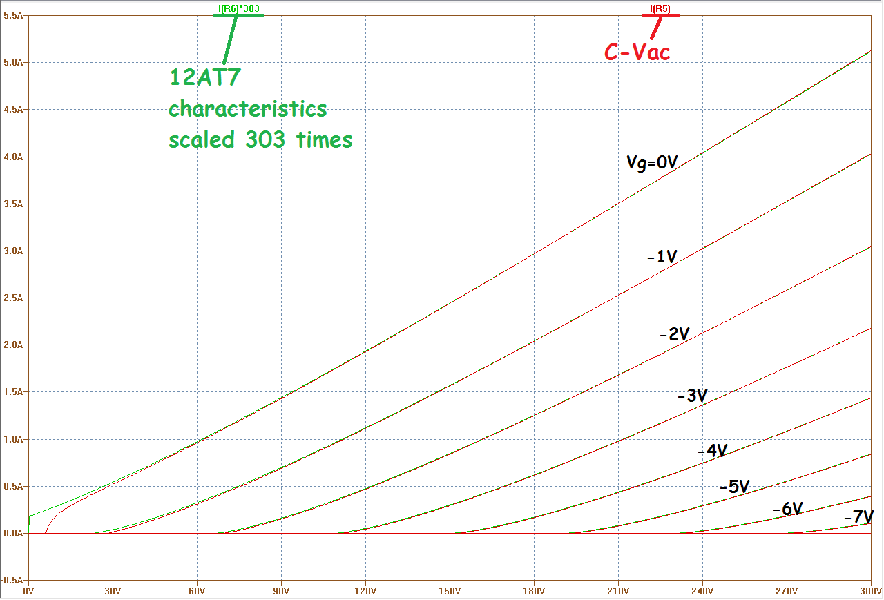

C-Vac is essentially a high precision current multiplier, using a low power tube (or other device) as a model. The virtual tube resulting from the multiplication process is the exact copy of the model, just very much larger: instead of mA's, the anode current becomes amperes, but the curves remain absolutely identical, apart from the scale factor.
The scale factor can range from 1 to many thousands without accuracy loss, and the dynamic performance extends to tens of MHz.

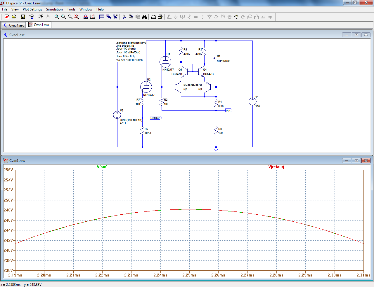

Below is an illustration of the faithfullness of the multiplication: the green curves are the reference scaled by the correct factor to enable comparison, and the red ones belong to the substitute based on the same 12AT7 tube.
The curves are almost perfectly overlaid, except at low voltages where divergences appear.
These divergences are caused by the fact that the substitute uses a enhancement device, requiring a minimum voltage to begin to conduct, and there are no auxiliary bias sources or connections.
But this also means that the substitute can be used in any configuration or topology, without restriction.
Anyway, circuits using tubes in the linear domain normally provide a minimum A-K voltage, and if this low voltage issue really is a problem, there are easy workarounds with auxiliary bias connections.
From the red curves, we can see that this virtual tube is in fact equivalent to 303 paralleled 12AT7 triodes: the C-Vac circuit acts as an exoskeleton boosting the "muscles" of its "pilot":
The resulting composite device is totally dominated by its tube model, the semiconductor part being almost ideally transparent and neutral.
Of course, purists are bound to say that "it cannot possibly sound like a real tube", but all the others will see it as a sensible and realistic approach, combining the best of both worlds.

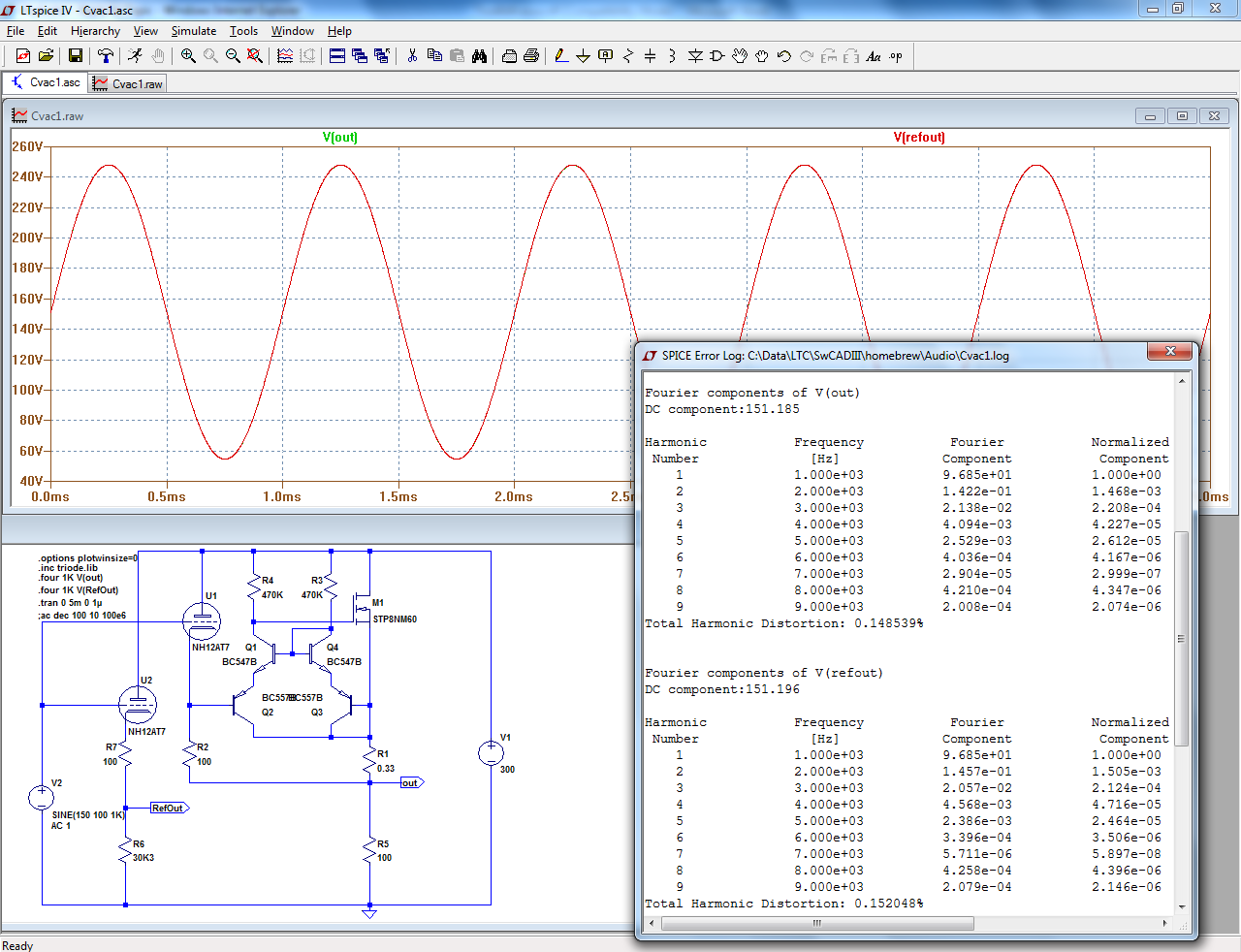

After the appetizers, here is some real meat
Let us begin to examine some circuits.
Many implementations are possible and have been evaluated, I have selected the ones offering the best performance to complexity ratio.

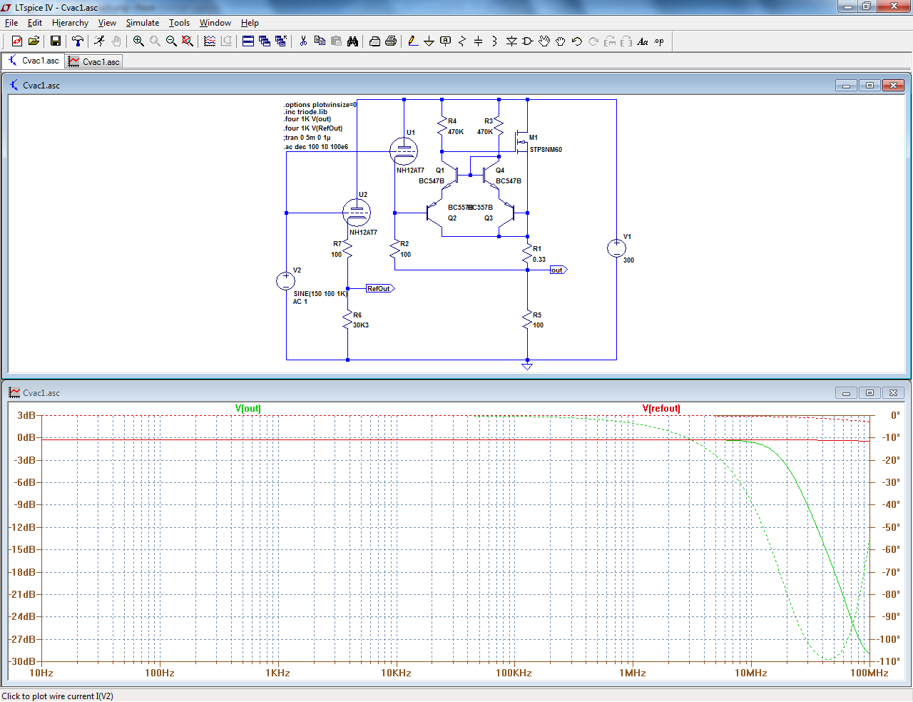

In C-Vac1, the cathode current of the "pilot" is sensed by R2, and compared to the boosted current by a Rush cascode, compensated by Q3 and Q4.
The circuit is used in a follower and a "naked" tube is also shown for reference.
The boosting factor is set by the ratio of R2 to R1, in this case 303x.
The loads are in the same ratio, yielding 30.3K for R3.
For a complete accuracy, the 100Ω sense resistor is also included.
In general, the circuits where the tube has to be virtualized will already use some degeneration, and thus the sense resistor can be made part of it.
If there is no degeneration, the sense resistor can be made smaller, it is a tradeoff between the sensing accuracy and the deviation from a non-degenerated device.
100Ω for a low power triode is relatively insignificant and gives excellent accuracy with discrete transistors.
If the transistors are monolithic matched pairs, even greater accuracy can be achieved, allowing for lower values.
We can see that the two outputs are almost perfectly superposed.
The differences in the THD's are also insignificant, and the spectral signatures are similarly near-identical.
For this simple circuit, the frequency response is limited to only ~10MHz, but we will see later that this can be easily extended if required.
Note that a real circuit should also preferably include a gate stopper and a protection zener, but since their effect is negligible, they do not appear in the sim.

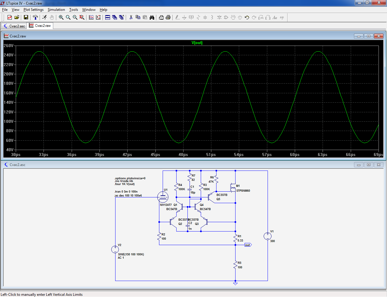

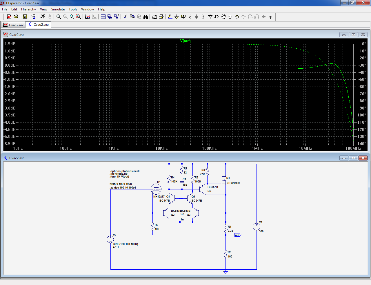

Let us go a bit deeper: the simple C-Vac1 circuit is accurate, has a good low-frequency behavior, but it also has a weakness: its dynamic performances.
The small signal frequency response is perfectible, but that is not where the problem really lies.
The main weakness is the large signal frequency response: it is caused by the large value of R4 and the Cgd capacitance of the MOS. Under large signal conditions, the current provided by R4 becomes insufficient to charge Cgd.
The 470K value just allows for a full swing at 20KHz, which in theory is sufficient for audio, but is a bit short to say the least.
Why not decrease R4 then? A tenfold reduction would mechanically push the full power bandwidth to 200KHz for example.
The reduction of R4 (and R3 which is linked to it) has a number of inconvenients: it increases the quiescent power, and it makes the virtual tube less perfect.
The resistors in themselves do not actually degrade the accuracy, because their current is returned via R1, and is thus taken into account in the tube simulation, but they put a lower limit to the cut-off current of the tube.
With 47K, the current could not go below ~13mA, and the additional quiescent dissipation at 150V would amount to ~1W.
None of that is catastrophic, and has to be put in perspective: the composite tube now has a maximum current of several amperes, and less than 15mA leakage is not going to degrade anything, and the 300V voltage used for the test is not realistic in an OTL context: I have kept the 300V value to allow for easy comparisons in a tube environment, but in the example, it leads to rather obscene power levels, almost 1kW peak in this case, much more with a speaker load.
Under more realistic conditions, the problems would be less severe, but anyway tackling them by brute force only is not the best solution.
Adding a buffer stage will improve the small signal behavior and ~halve the current requirements, because R3 and R4 can remain of a relatively high value.
C-Vac2 shows an example: the small signal bandwidth is increased to ~50MHz, and it now accepts 100KHz at full power for a marginally increased dissipation and cut-off current. Compensation becomes necessary in this case.
More elaborate improvement schemes are possible, but they involve high voltage small signal transistors, an annoyance that has so far been avoided.

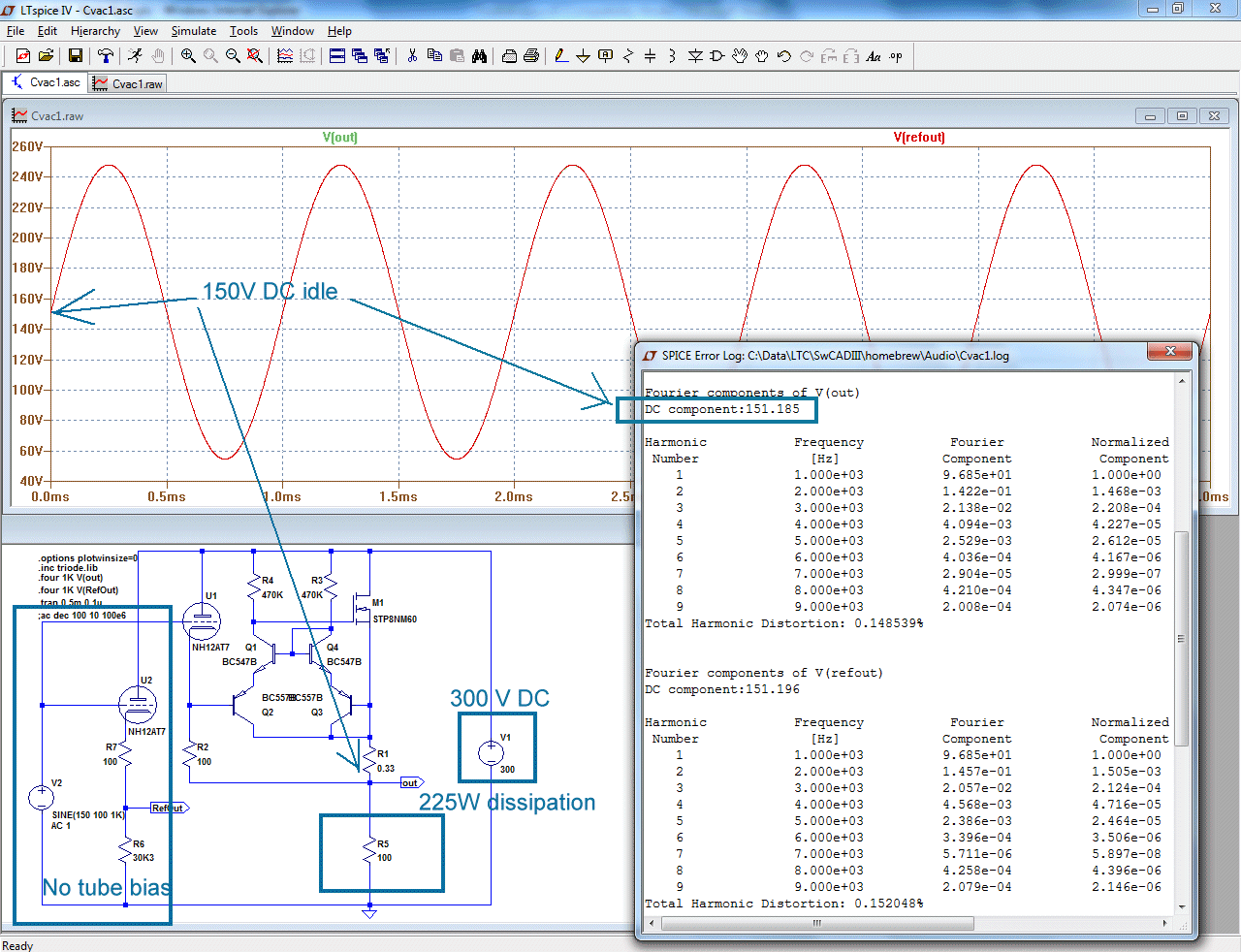

Sorry for being frontal, but what is this crazy schematic? :eek:
1) R5 is 100 ohms and has 150V across it, it dissipates (idle) 225 Watts :eek:
Only possible in "Simulation World"; in any real bench you would be opening all room windows by now to clear the smoke.
2) you did not include or even mention any biasing for the tubes, only show an AC signal, which in the absence of any indication to the contrary, is to be presumed referenced to ground.
Care to elaborate?
Care to elaborate?
..... and the 300V voltage used for the test is not realistic in an OTL context: I have kept the 300V value to allow for easy comparisons in a tube environment, but in the example, it leads to rather obscene power levels, almost 1kW peak in this case, much more with a speaker load..
Tube amps are often linear enough not to require feedback and this changes things too - not leas their response to speaker back emf. Do you plan to try your circuit in an equivalent system, low power with sensitive speakers, no feedback and a choke loaded power supply ???
No, at the moment I have built a test amplifier, an OTL in class B of ~70W.
The benefit of this circuit is precisely to get rid of the current limitations of normal tubes.
One could think oF a SE class A amplifier of the kind you describe, but with muscle enough to drive a standard loudspeaker directly and comfortably. That may be my next project.
Woah, hold on there. Are you sure? Most tube amps I've heard without feedback were far from linear...
The amplifier I have built has almost no feedback, because the open loop gain of the two ECC81 I have used (1 voltage amplifier, 1 phase-splitter and 2 in PP) is barely sufficient to get the full power output with 0.5Vrms in, yet the THD at 70W is under 0.5%. That would be difficult to achieve with semiconductors.

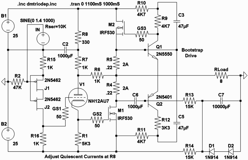

I have used this trick in the SolidGlass example.
Another interesting possibility is to use separate supplies for the tube and the high current section.
This is a logical step in the context of OTL amplifiers, because tubes do not like to be starved of voltage, but high supply voltages generate uncomfortably high levels of power with standard speaker impedance's.
The best way to reconcile these conflicting requirements is to split the two supplies.
I didn't use this option in SolidGlass, and even with a 16Ω load the dissipation is quite daunting....

Smoking, the one transistor, one current sense resistor
(Sziklai pair method) *IS* using triode Mu for feedback.
Runaway of the sand is another matter to consider. With
a SE amp, and passive resistive load, controlled voltage
gain makes runaway of a simple Sziklai pair unlikely.
But you push pull against another boosted triode (Elvee
does this in another thread), you need at least one to set
a limit for current. Gm multiplier works well as any other
scheme. I'm not convinced its the simplest or best way...
If you want to go rail to rail, then you need something
more complicated. As you have to scale the feedback
across the plate-cathode to a lesser swing that keeps
reasonable voltage across the triode at all times. This
feedback cut is gonna boost the simulated Mu by the
same ratio, but should still behave triodishy...
