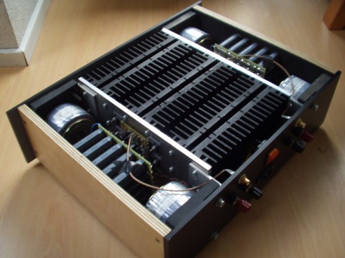

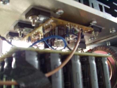

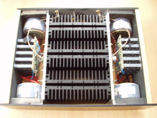

Please see the pics of my newly build A30. Beside a faulty ground resistor all was singing from the first minute:cool:
hi tarasque
clever design with inside heatsink and outside amp and supply
but i hope there is a free big hole underside for airflow
and maybe big stand off foot for airflow would be a good thing
tell me more about your power supply transfo + cap
bye I m sure you will be happy with A30 like me with A3
I'm using parallel windings of 22-0-22V (bigger xformers would not fit in the space I had left on either side of the heatsink.
The caps are 6800/50V Nippons, 24 pieces per channel.
Yes, you are right...There is a tunnel under the heatsinks for the airflow and sufficiently high feet.
The design was actually dicted by the parts I had in my shop. I was determined not to buy expensive parts like xformers, heatsinks and power caps. So I fiddled around with the existing parts and finally came up with this design.

I finally had the time to do some serious listening. I could use Teake's P1.7 as pre-amp and used my Seas Thor's.
If compared to the mini-A's the sound is more complete and less "loud"
The mids are truely wonderfull and the soprano from "La traviata" has no coloration at all.
The most striking thing is way the musical picture is drawn...in rich full strokes, without the least signs of doubt. The increadable dynamics is the biggest step forward.
I used the ground resistors (5,6 ohm) at the input to minimize the effect of a ground loop.
To come back at the power supply: I used the CRC optoin after simulations in Pspice. At 50Hz, the complex component of the coils are less or equal to the resistive part.
Also using as little as 0,4 Ohm will give you about 70mV ripple if you use 2 banks of about 30mF.
Positioning the amplifier PCB close to the high current wires will give more noise than the power supply ripple.
I hope this helps.
