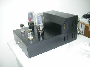

I recently assembled a 2A3 SE amp. When running in the amp, I used the notebook to play MP3 as the signal source, and connected two 8 ohm, 5W resistor to each output. When I adjusted the volume control into the maximum, there is the small noise coming from the chassis, the MP3 music. My questions are the following:
1. Is the music coming from the components, such as resistor or some kinds of inductance load, transformer?
2. Shall I find it out to change the component? Is it necessary?
Thanks for your time in responding this in advance.

My suspicions would go to any largish coupling caps (especially "designer" caps which often are rather loosely wound) and the output transformer. Try isolating the components mechanically from the chassis- rubber grommets will work for the transformer, some soft hot-melt glue may help with the caps.
Pffbt, coupling caps don't have ANY current or voltage through or across them (aside from the DC bias voltage). It's the OPT, especially under clipping when harmonics are more easily heard. Also more easy to hear if the load is disconnected, which is bad mojo at maximum output..

I would think so! Why would you connect resistors to the outputs and crank it all the way up in the first place? The so called "small noise" you are hearing is coming from the OPT's as is to be expected!

Dear all,
Thanks for your response.
I just attached the photo. The two OPT locates at the upper small compartment, and all other component including the Power Transformer locates in the lower chassis. And the noise comes from the lower chassis.
According to your comments, I will add the rubber gasket between the mounting surface and the transformer.
The reason to run the amp this way is because I just placed the amp in my office. Since the amp was being completed not long time ago, I think for the new mechine it would be better to run it as more as possible. And I also want to know whether it's stable for long time operation. So that I connect two resistors for each output(because in the office) to run the mechine whole day long.

Under normal listening conditions, i.e. not listening to resistors cranked all the way up IMO that would be totally unnecessary. I can duplicate the same on my amp or any tube amp at those conditions! Sooo, don't worry about it! It's normal! You won't hear it! Rubber gaskets won't stop the sound you are hearing at THOSE conditions anyway. Plus it's not a good idea, you need that heat transfer (and electrical) from the OPT to chassis.
