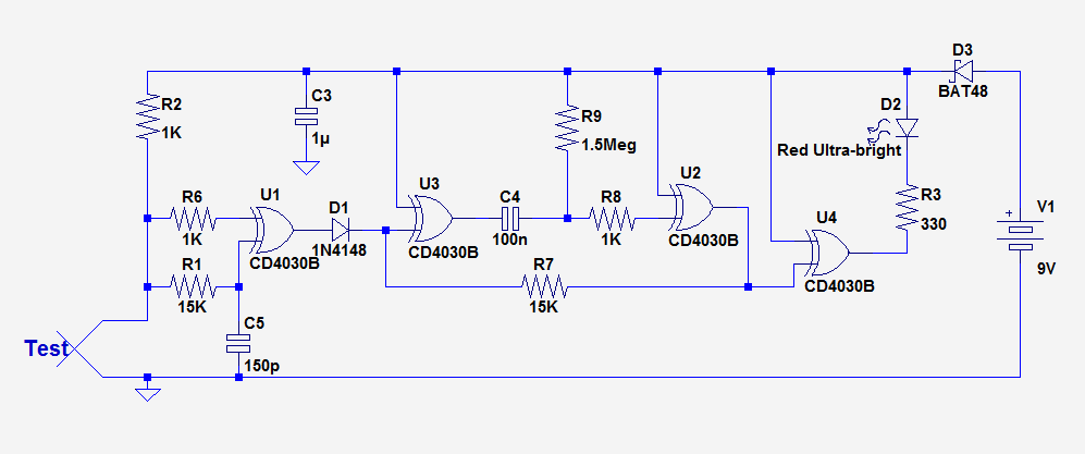

It is simply a positive and negative edge triggered one-shot: as soon as a transition is detected, an ultra-bright LED gives a flash of ~150ms.

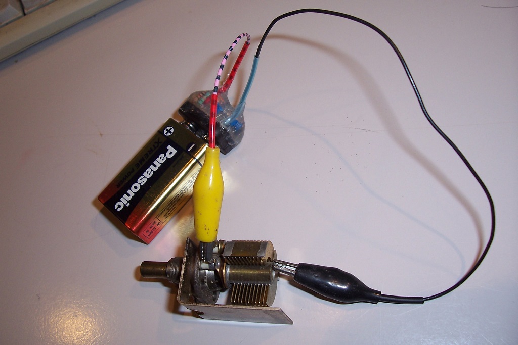

You begin by connecting the tester to the whole contact loop, then you shake, twist, wiggle every part separately, noticing where the flashes are the most numerous.
You then narrow down the test to that particular section, and so on, until you have pinpointed the exact cause of the problem.
Once you think you have fixed the problem, you do once again a test of the full loop, to make sure you didn't miss anything.
The tester will detect intermittent opens and shorts. In practice, opens constitute more than 80% of the actual problems, but shorts do exist too: stray strands of multistrand wires touching something else, loose metallic chips of metal inside a connector, like chromium plating chipping off, or dendrites from certain alloys, etc.
The tester will catch them all: it will test switches, cables, interconnects, plug/jack combinations, sliding or rotary contacts, variable capacitors, break before make action of a selectors, etc, etc.

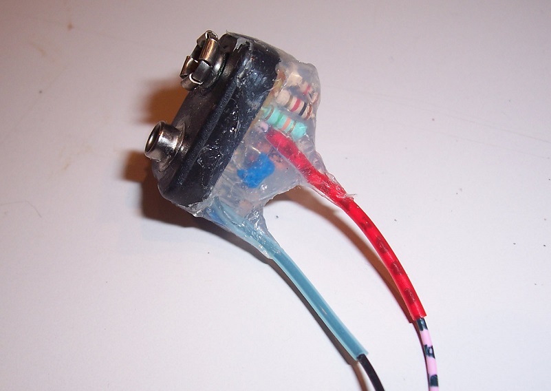

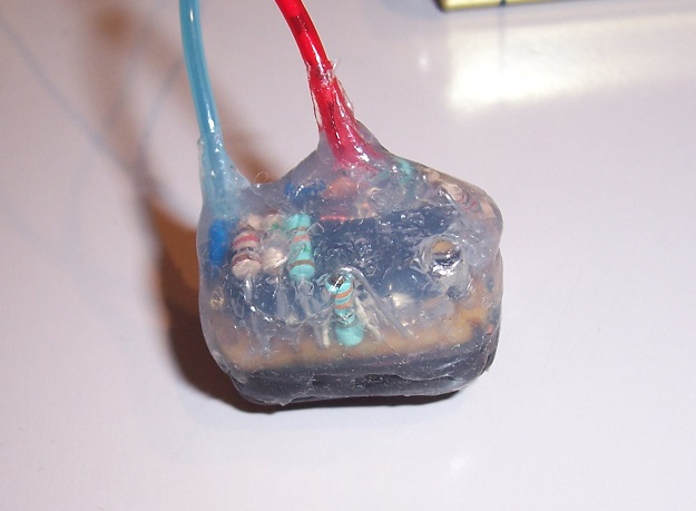

It is also dirt-cheap, compact (I built mine into the top cover of a 9V battery and I didn't use SMD components), robust and reliable.
attachment.php
I have coated mine with RTV silicone (non-acetic obviously) to protect it from shocks, vibration, accidental electrical contacts, humidity, liquids or any other contamination.
attachment.php
attachment.php

Elvee,
Do you have a part number for the x-OR that you used in your
project detector? Was that a PDIP or smaller part?
Nice discreet parts. Was that a solid type 9V battery
board? I assume you mounted on standard type perf
board fitted to mount in the battery board?
Elvee,
It is a CD4030B, as on the schematic; a CD4070B would also be usable.
It is a regular PDIP
It was a moulded plastic piece, and yes, I mounted a bit of perfboard inside
