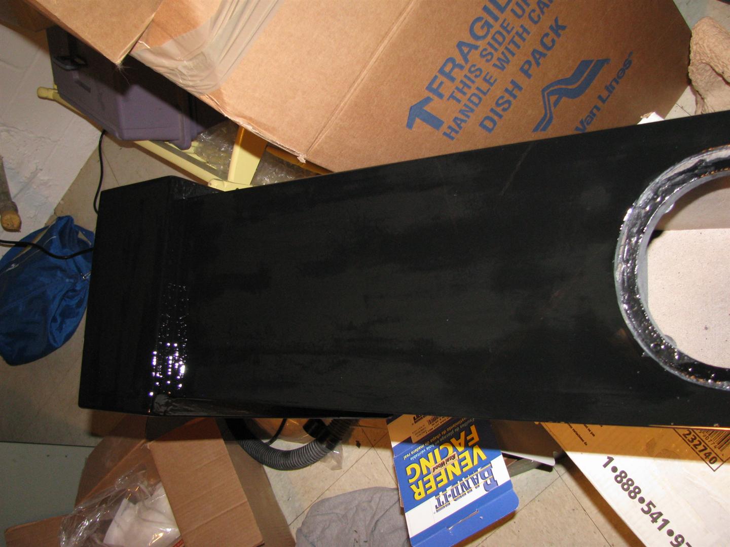

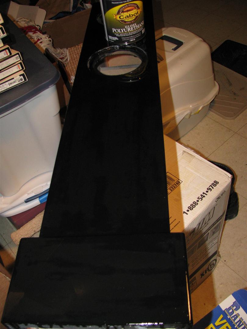

I applied some poly yesterday, and after 24 hours, I'm seeing discoloration of the black!
After all this work, I'll still take it back down to bare wood (again) and start over to get a smooth, clear finish, but can anyone tell me what is causing this?
Looks like a reaction to the epoxy top coat and the sub structure paint.

I've seen paint discolor like that when exposed to water prior to finish coat.
It is, and we have, recommended to stay within product lines for compatibility issues.

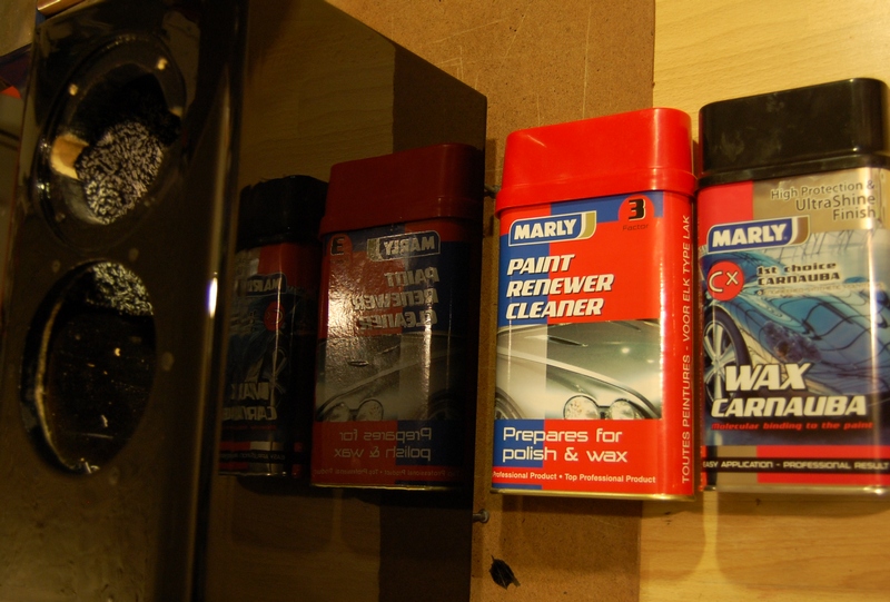

Farecla G3 is a cutting compound if you can find it over there. 3M do some as well. Most of them need to be used with a machine though.

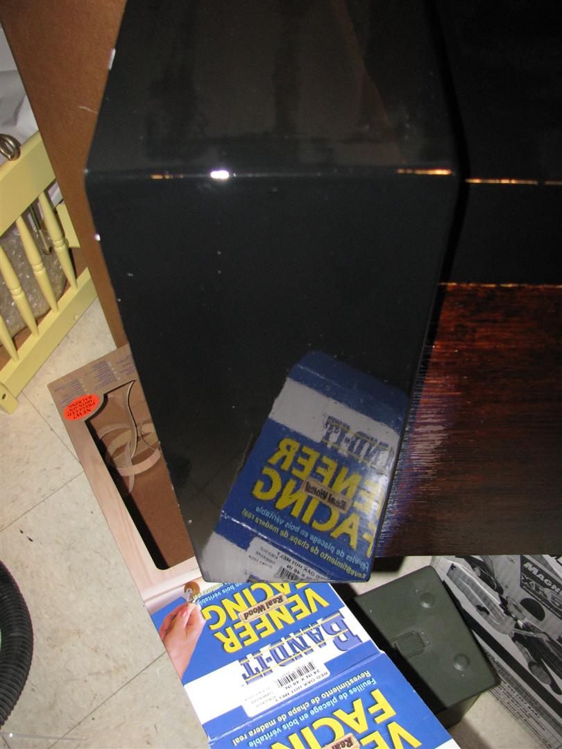

This is what I found, posing together with first brush layer on Hatt MkIII. Looks like it might work. I am not planning to put more than 3 layers, it should be thicker when applied with brush anyway...
