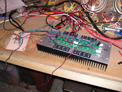

Here is something you guys might be interested in, my current design I am working on. A 2kw into 4 Ohms Grounded Bridge Amp using N-channel laterals Mosfets.
With the current power supply I am using I am getting 1kw into 8 Ohms and about 1800 watts into 4 Ohms.

The Saint said:Here is something you guys might be interested in, my current design I am working on. A 2kw into 4 Ohms Grounded Bridge Amp using N-channel laterals Mosfets.

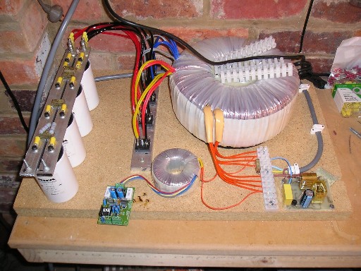

Here is the Power Supply
4KVA Transformer with 4 x 4700uf 250v caps and 4 x Bridges
An overkill I know But O'Well

The Saint said:Here is the Power Supply

4kVA ???? that's about half of Tassie's grid !!!
Cheers
Q
Hi Quasi
I must say when I turn up the wick on this amp it does tax my standard 10A workshop GPO.
The mains supply drops by about 6 Volts AC from 246VAC at full power. Just think what it would do with 2 Channels running...

The sound quality from this amplifier is surprisingly very good.
I have some Samples from NSC of the new LM4562 opamp, I will have to give them a try in this amplifier....
This current design is for a commercial amplifier that my UK partner and I are developing. It will ultimately be matched with one of www.class-d.com SMPS
