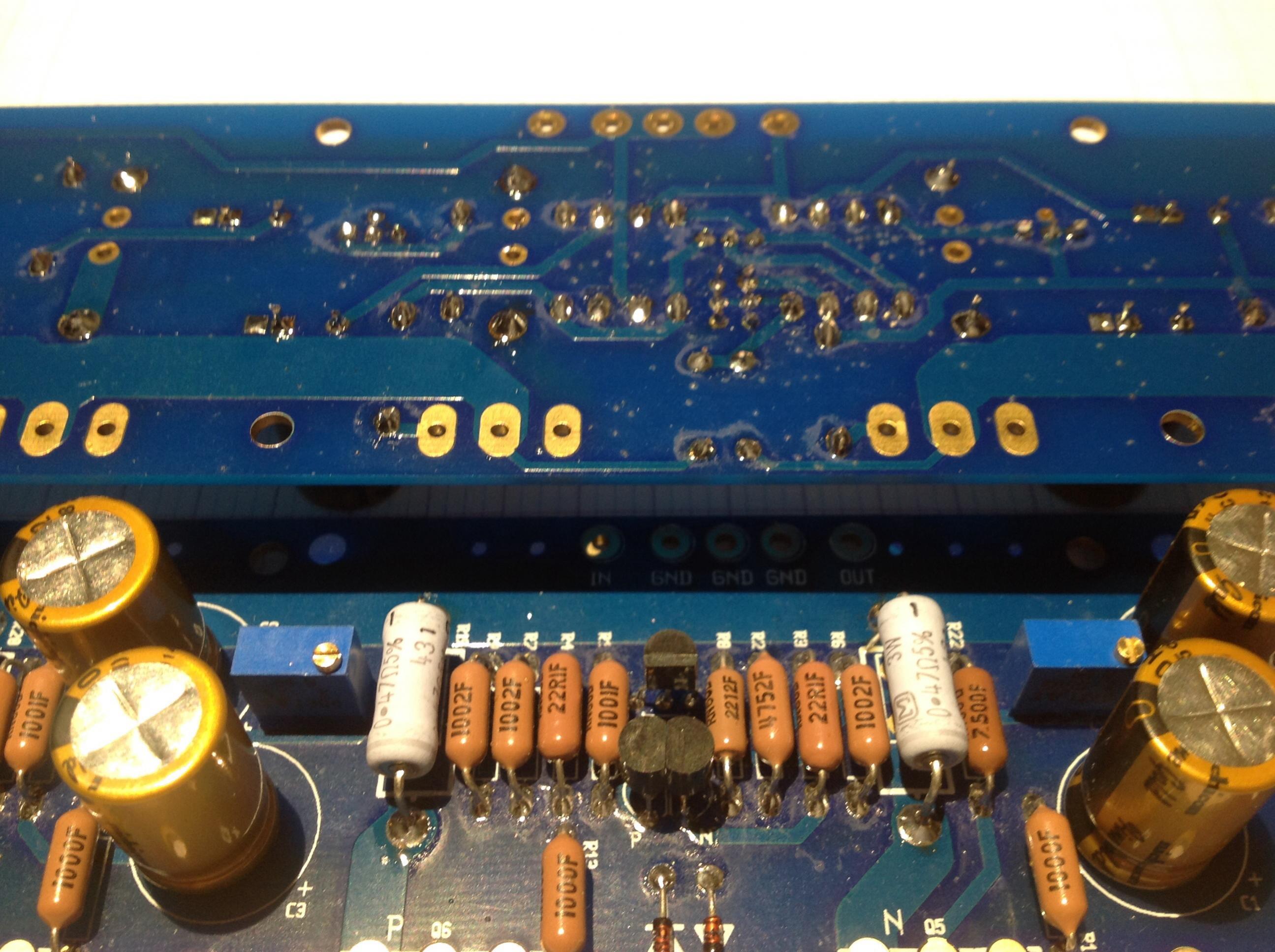

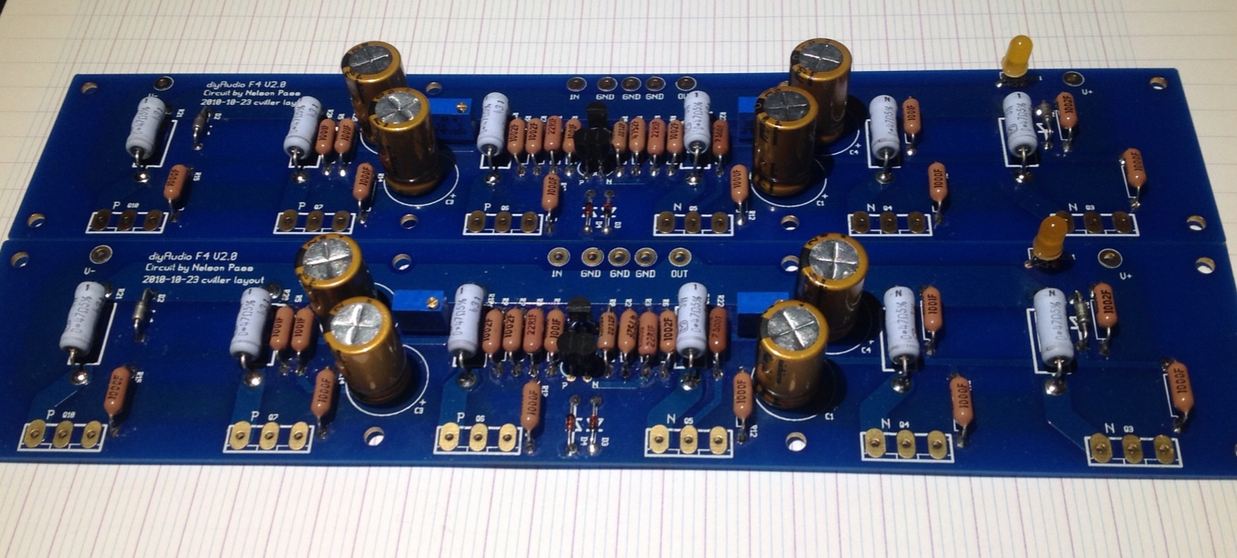

My F4 boards are ready stuffed exception of power transistors.
I always in admiration about yours finished pcb showed in build guides.
What chemicals give such good clean results ?
Greetings

Many here refer to IPA as India pale ale.I use Isopropanol alcohol, IPA for short.

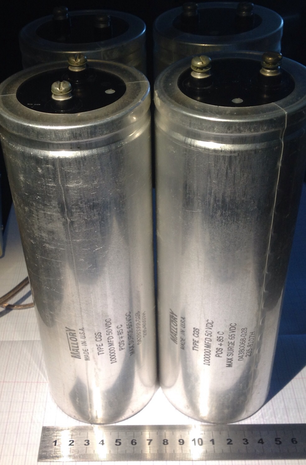

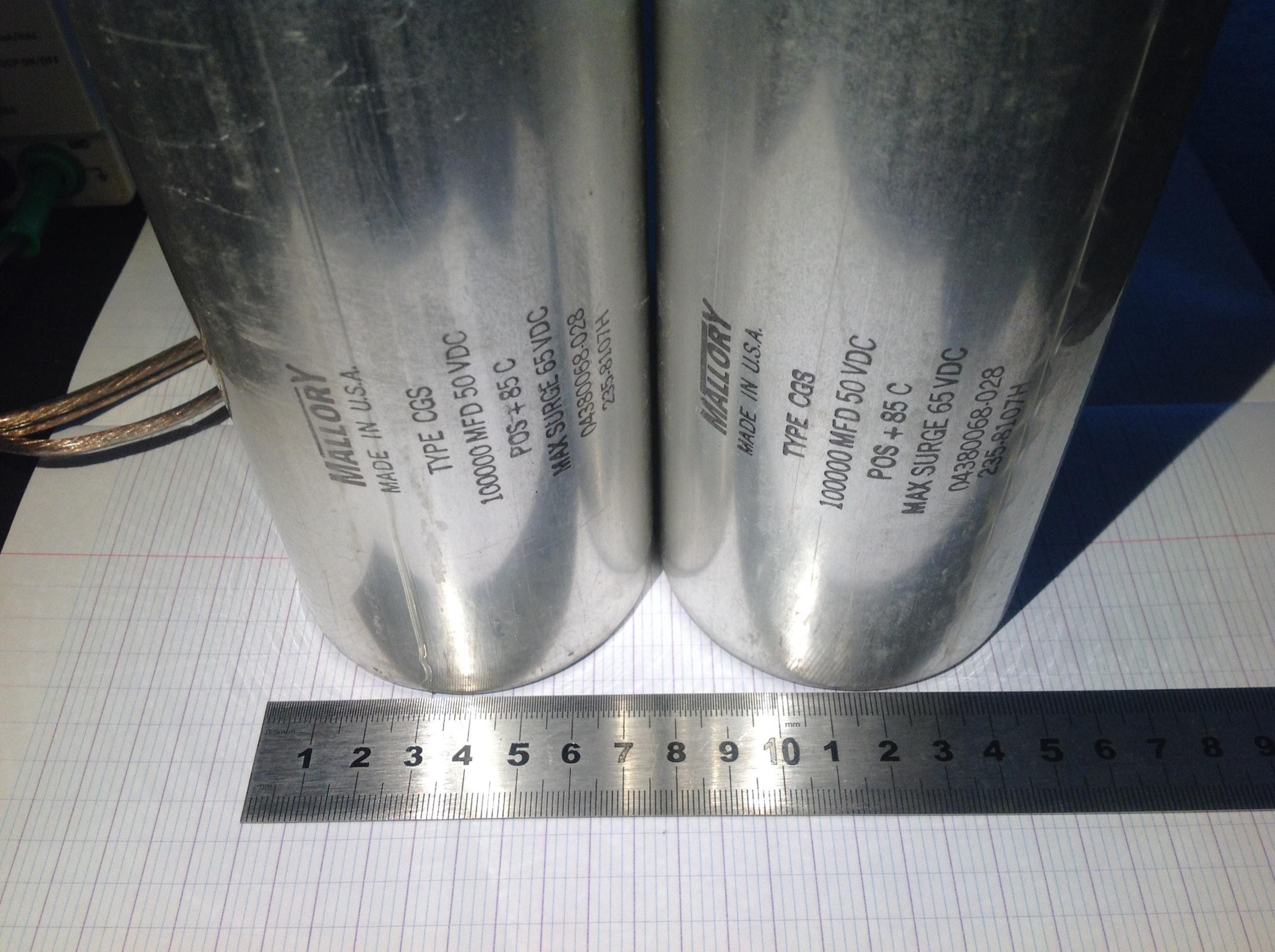

Now components for power supply
i have four huge caps like this but is to much ?
Greetings
Isopropanol is the way to go, together with toothbrush
