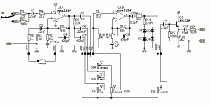

Minion said:[Here is a schematic that is the basis for the preamp I am useing:
Are there are problems that you think I might encounter useing this preamp design simular to this??
Thanx a Lot Guys....
I would not configure the preamp so the tone control is before the distortion circuit. This is fine for clean tones but it will not be as effective or sound as good if it is after the distortion circuit. The distortion comes from the D1-D4 diode clippers after U1B.
