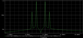

Hi, Janneman,
But what if that mechanism is happening in the differential itself? What would happen? Who will fix the differential?
Ah.. I see now. Thanks But, assume we are talking about the whole amp (assume 3 stages), where is this bottleneck?When I said above that at slew rate limiting the output doesn't change when you change the input, of course the output is moving, it is slewing to the required output level as fast as it can but not fast enough. Now if you (of the fb) double the input level, still the output will continue to slew at the existing rate at not suddenly faster. That is what I mean by saying that there is no longer a causal relation between input and output.
You are right, if the assumption is that the differential is very fast, and the "slow" one is the output stage, for example, then fig D will be the error signal seen at the base of the differential.Your fig D is exactly what you will see at the amp input: it is the missing part between the input and output (but the polarity may be the opposite though).
lumanauw said:[snip]But, assume we are talking about the whole amp (assume 3 stages), where is this bottleneck?[snip]
Depends on the amp topology. If you are talking about a run-of-the-mill amp with diff pair, Vas, EF, generally the cause is the fact that the diff amp cannot charge the comp cap fast enough. The diff amp is limited to the tail current so charging the miller cap (which normally is connected to the diff amp output) takes finite time. But there are many topologies that avoid this kind (or any) slew rate. Slew rate is a non-issue for a competent design.
Some suggestions: higher tail current, lower gain (emitter degeneration in the diff pair) so the comp cap can be smaller, different design topology (see Otala for instance) etc. This can be a course in itself.
Jan Didden
PS to my previous post: what is gain? Gain = delta Vout / delta Vin. With a slew rate limited amp, the delta Vout as a result of a delta Vin = 0, so gain = 0. The fb equation assumes a non zero 'A' (you are not allowed to divide by zero in a mathematical equation). Yet another confirmation that Feedback Actually Works. It doesn't promis anything it cannot deliver
Yes, but the problem is, what else does it deliver than the promised ?
For example: Any change in openloop gain will change the phaseshift...
Mike
Mike
Sure. What I tried to convey, in my limited way, that fb isn't magic which can run wild.
It is all understood and, in principle, calculable. Although if you really want to do the calculation for a closed loop circuit with all the nitty gritty details like harmonics expansion and phaseshift, you quickly get a hurtin' head.
What really gets me is a statement like: "fb around an amp converts the phaseshift to FM modulation, so that must be why a fb amp sounds bad". That is such an exquisite example of bad thinking one wonders whether that person is actually able to figure out how many dollars he has left from 20 after he spends 10.
