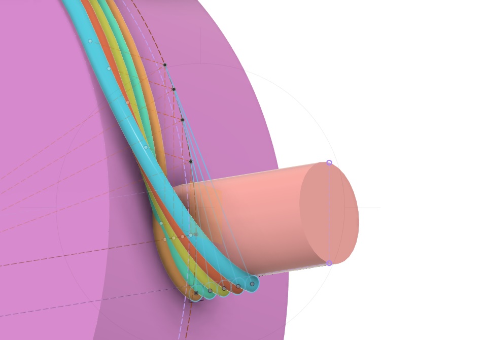

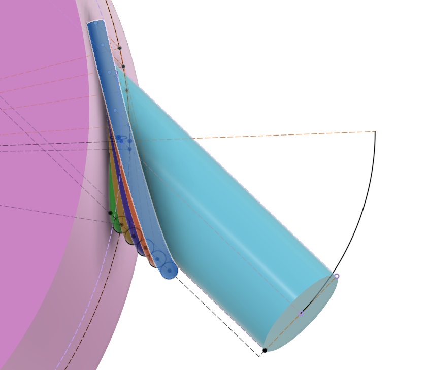

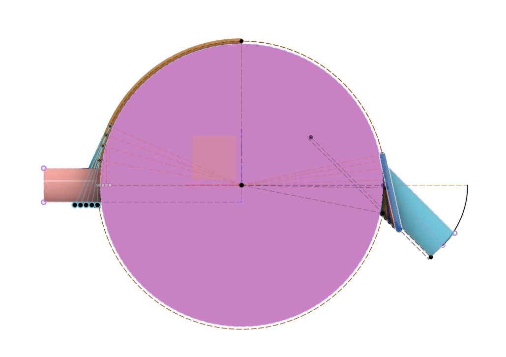

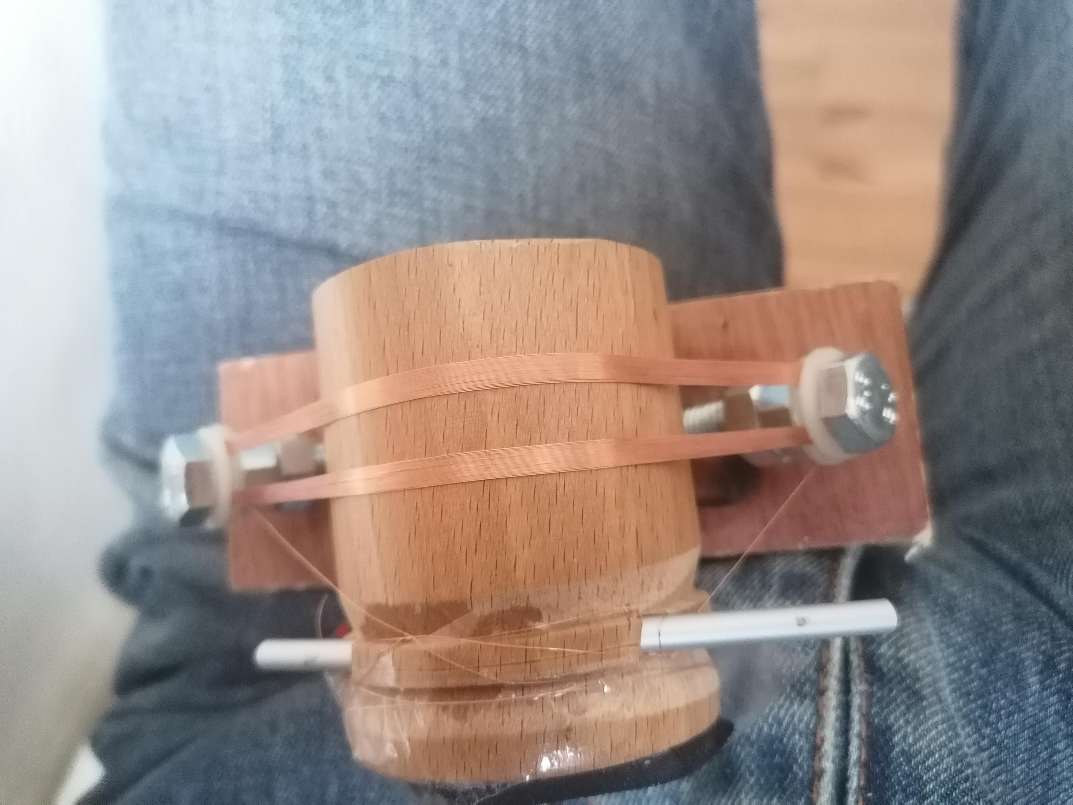

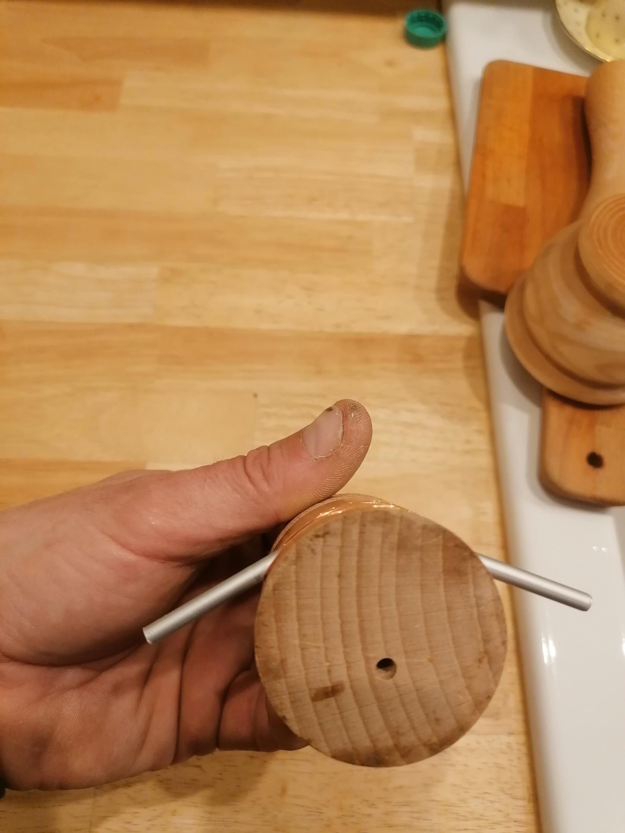

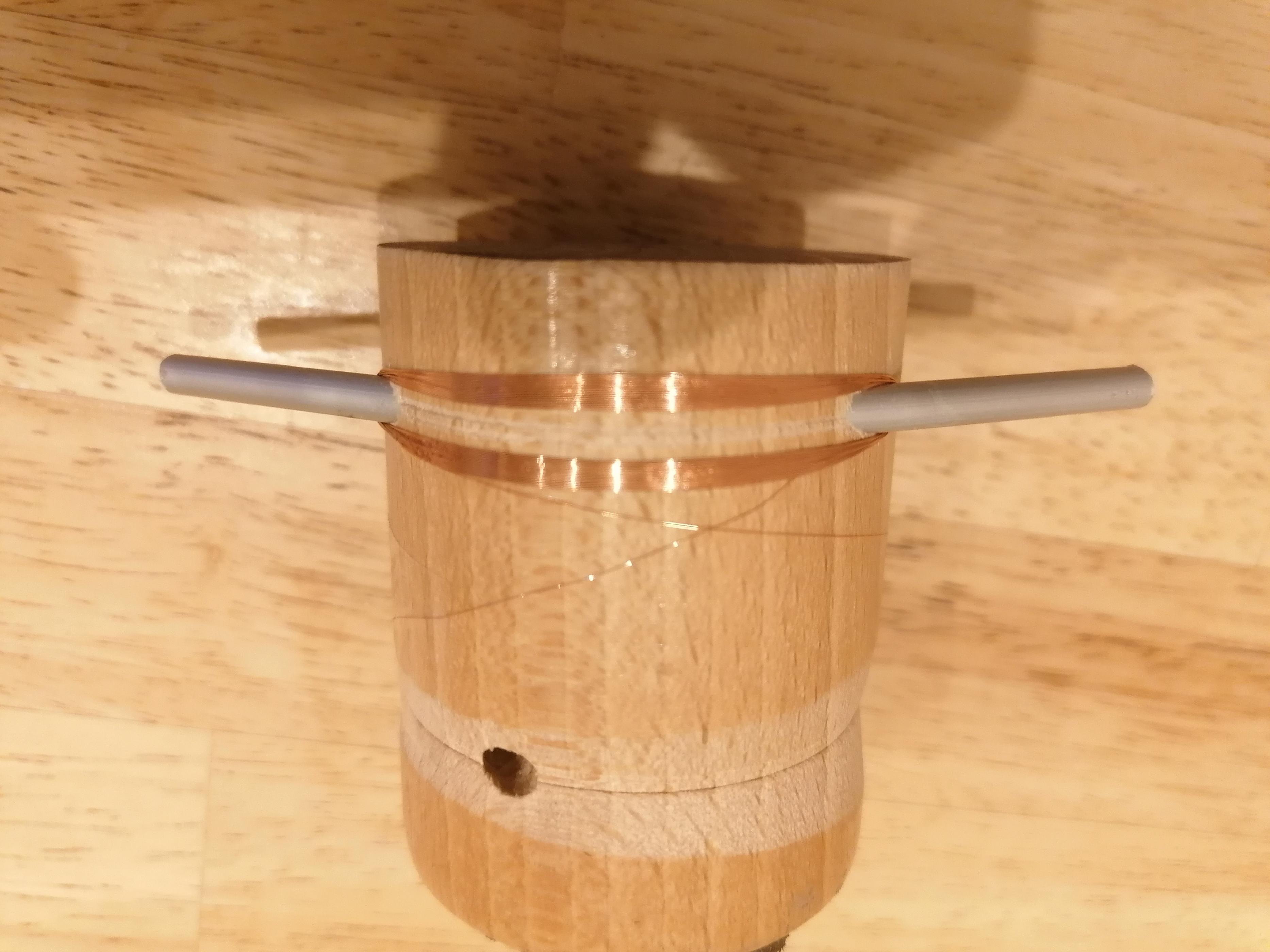

This morning I thought that the best way of laying wire in a slot shape would require tension, so I started to play on Fusion and see what I can come up with.
The issue with using cylinders are, the wires will always clump together at the ends. So I started to think what would happen if you changed the angle of the end cylinders?
If you compare the two angles of the tangent cylinders, you increase the radius of the Nth wire.
What you're trying to replicate is the flat slot shape, which is basically a ratio of Pi.

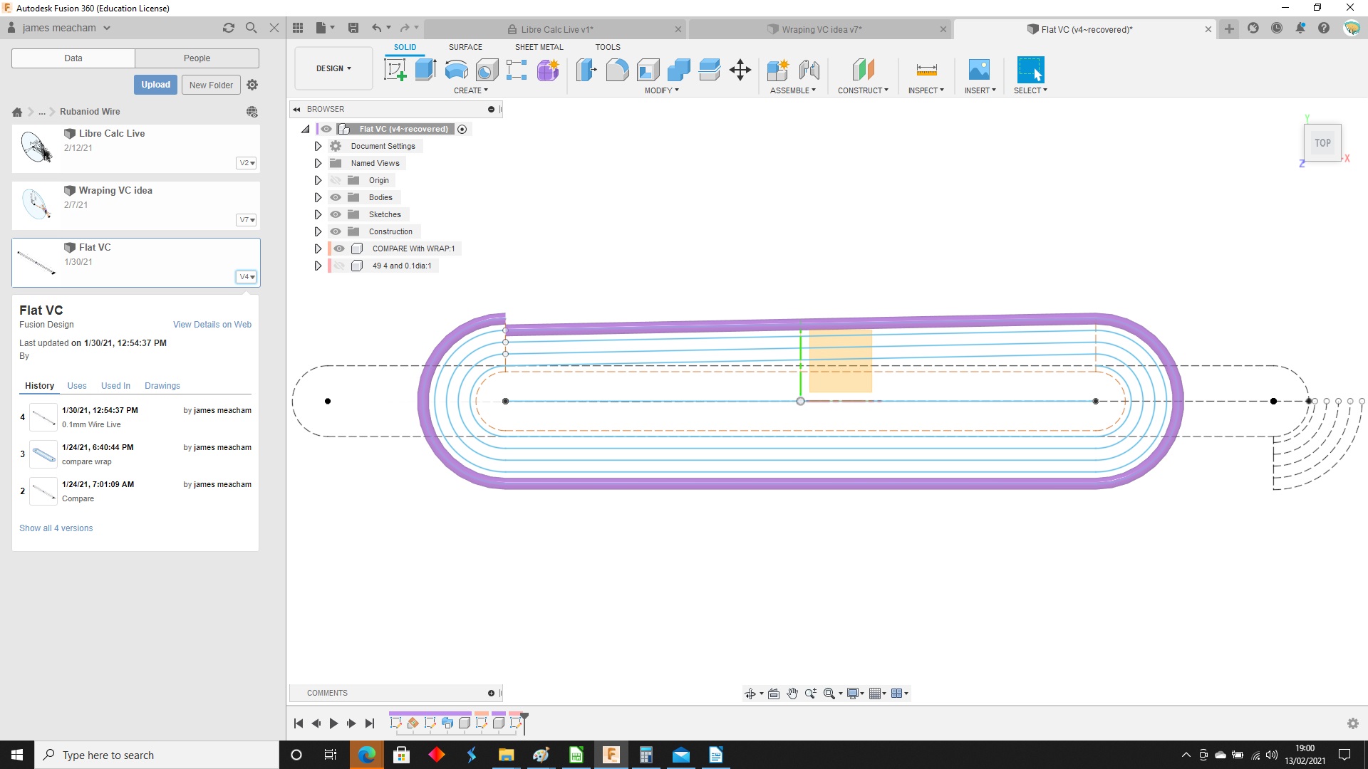

What I ended up creating was a spreadsheet which allowed me to change the gauge of the wire, the radius of the outer cylinders the radius of the master cylinder which determines the overall slot length, the angles of the outer cylinders required, ohms etc etc... however I now have to reverse the equations to speed things up.
For the moment, the cylinder technique works in respect of that is make a perfect tension, though I'm only tried hand winding.
This is how tight the wire was when using AWG40
Though I doubt I'll ever have to time to convert this to a mechanical winding machine, it has dawned on me that this maybe a lot easy than Russ' excellent creation.

not sure if you ever watched the video but in my intro there is such a thing. to lay flat coils and yeah. there is only so much you can do when making a turn, it cant be to small radius while round ones could be done nicely.
CNC Pancake Coil winding (Bifilar coil) - YouTube
after that i made a simple jig , and i cant seeem to find the picture it worked great flat and all. ill look for it.
not as nice as the cnc version i had many ideas for such a thing if i could make tighter turns more coil more output !

yes, I remember seeing that video a while back, it works on the basics of a drag knife.
I've finally finished the excel formulas and realised that my cylinder idea actually would yield a tangent length equal to the Nth radius. So at some point the 3D printer will be re-jigged. The idea of winding AWG 50 with a tight turn would be interesting...

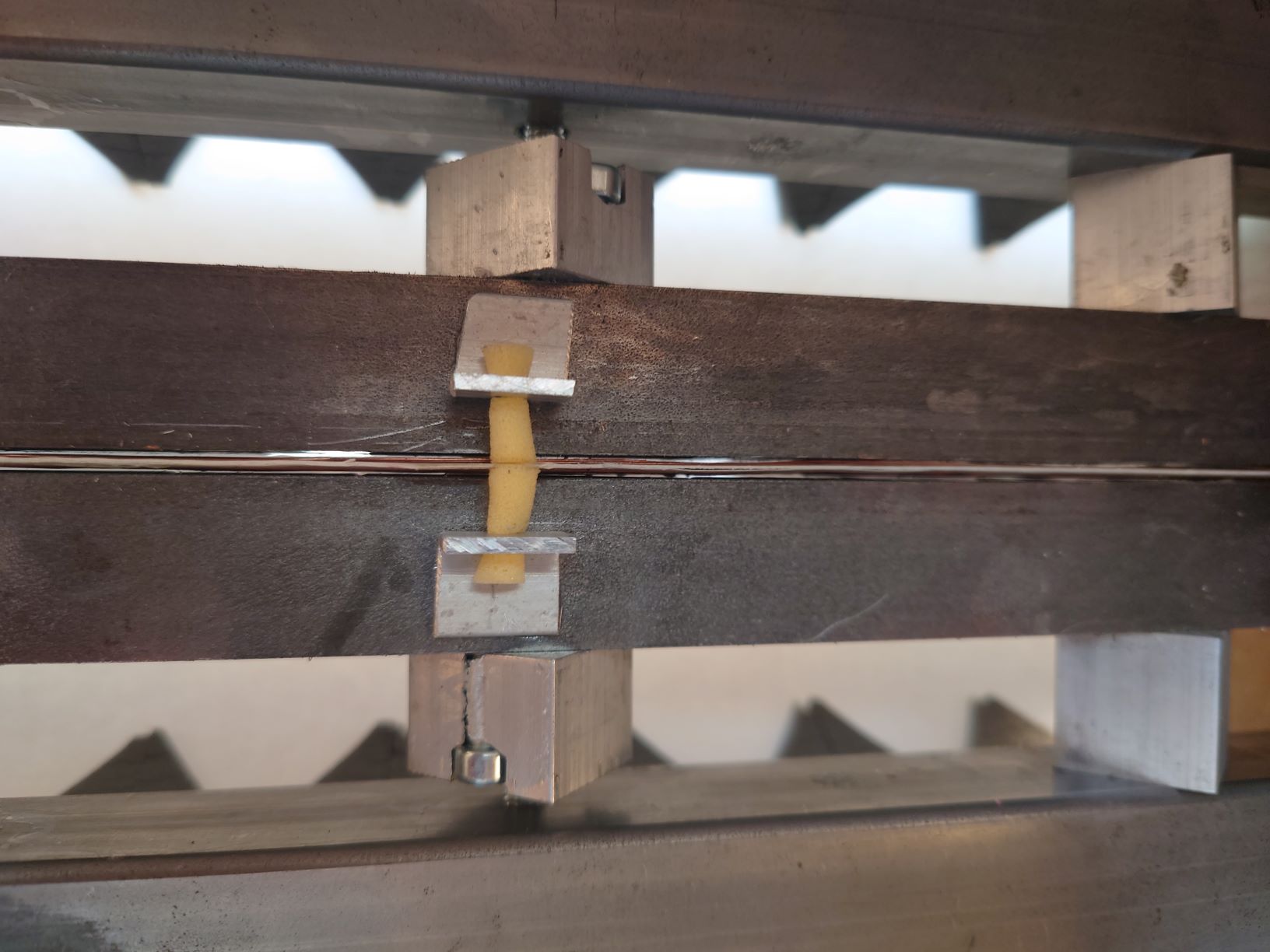

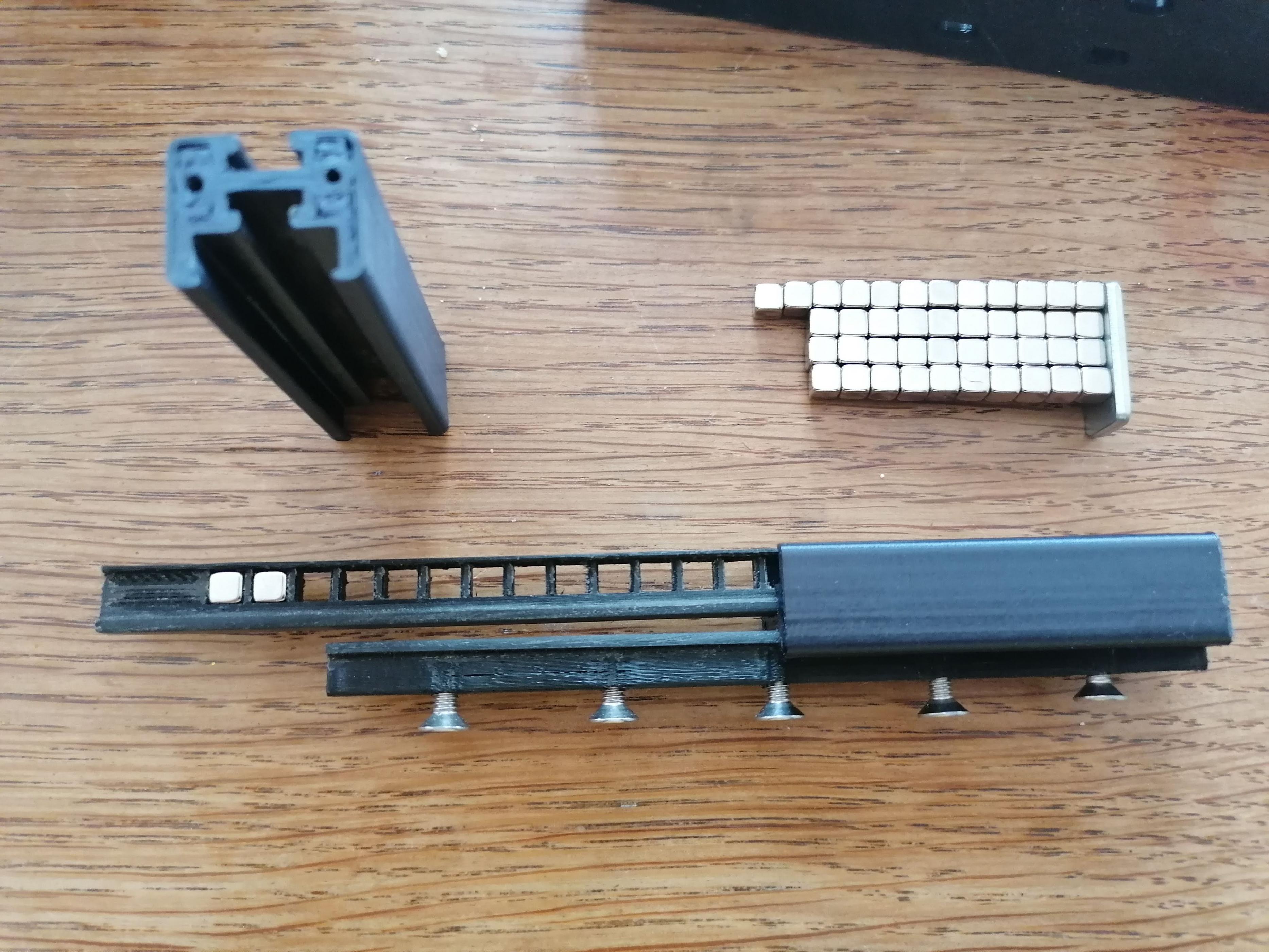

Winding wire flat

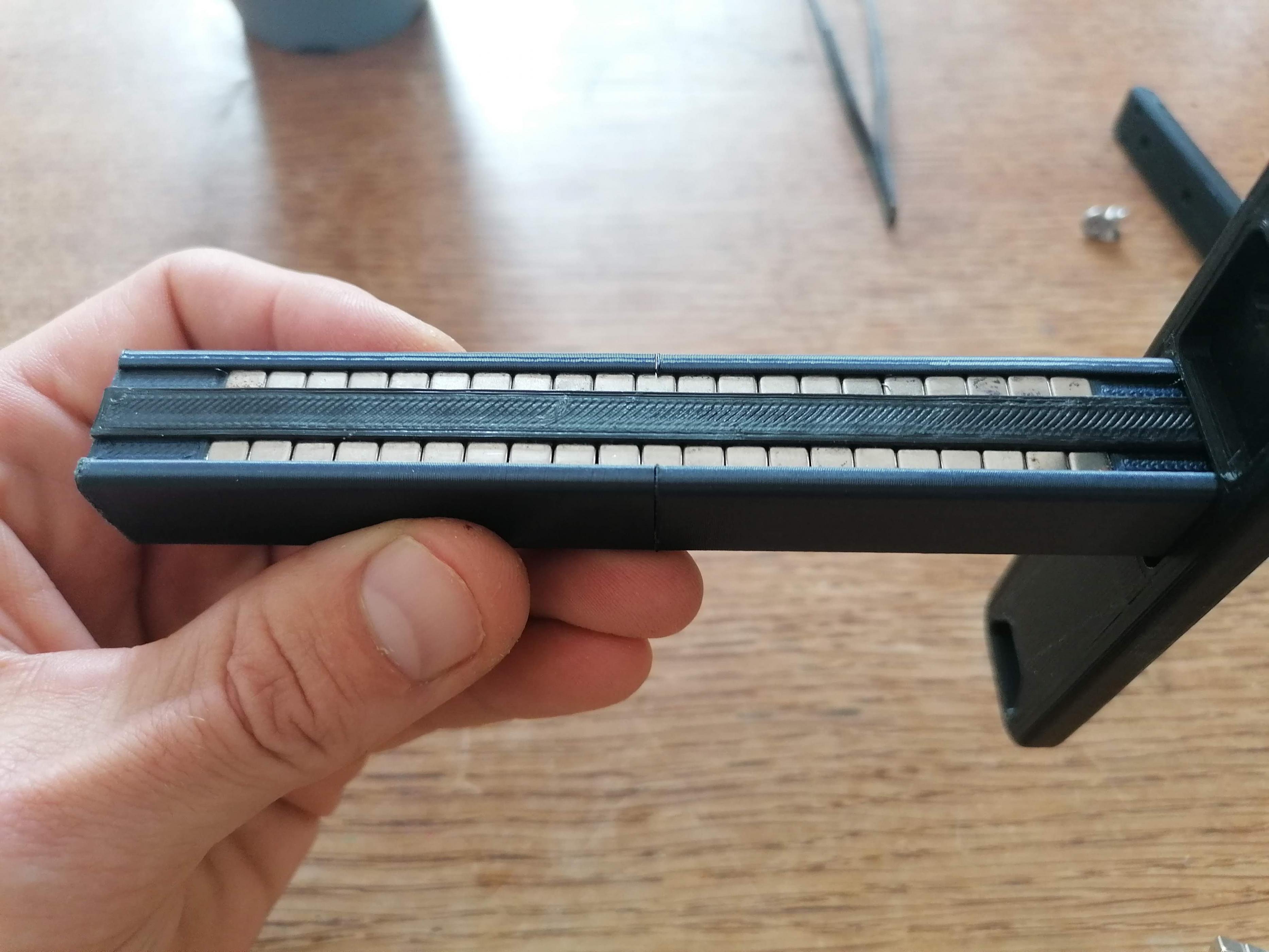

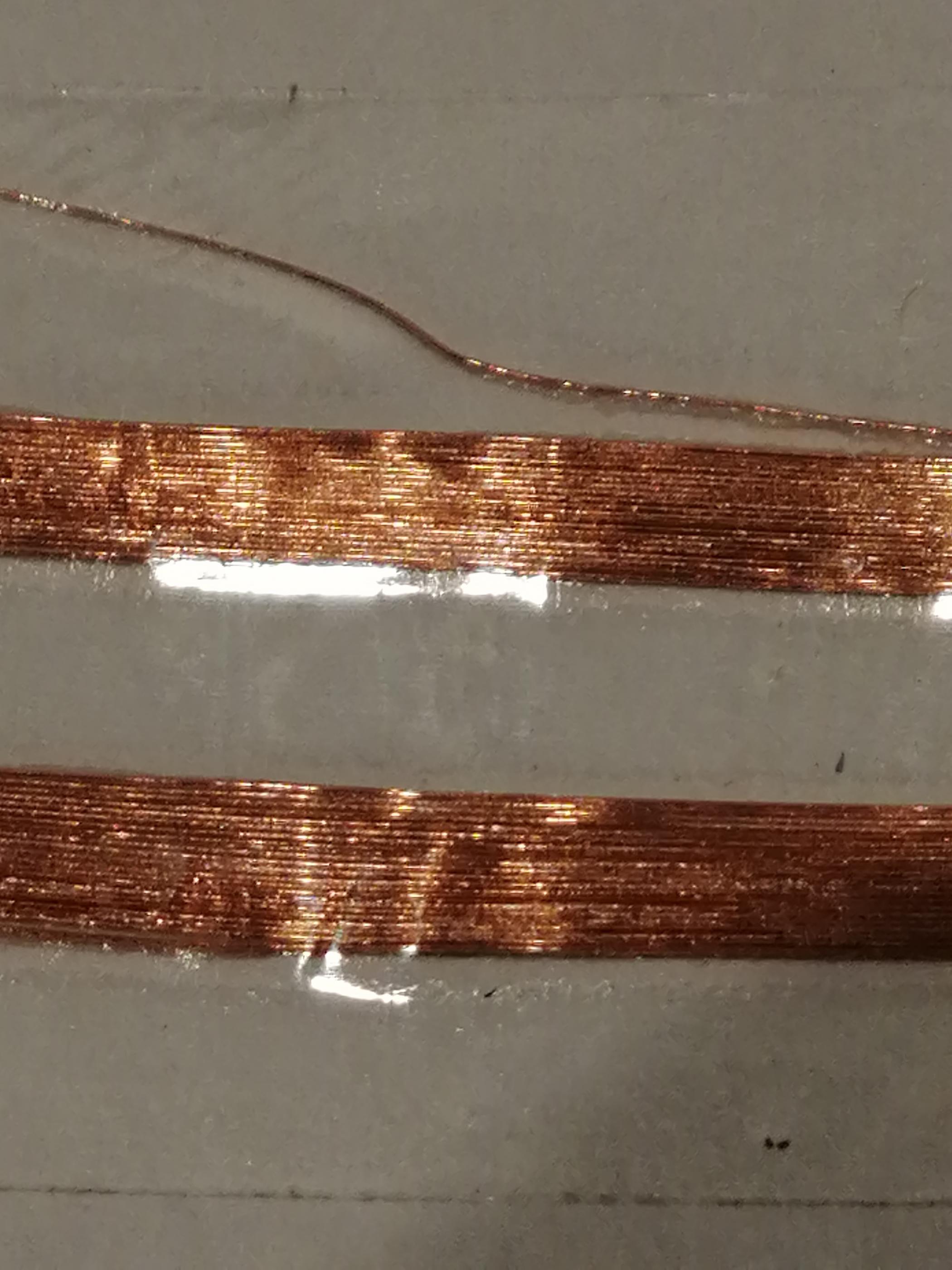

Another foot note continuing from last weeks work on making a flat actuator from AWG40 wire, here is my latest iteration.
So far this has been yielding the best/cleanest winding yet. If you zoom in on the photo, it's still not 100% perfect, but it better that what I've seen on the net, considering it AWG40 which is 0.08mm diameter in new money!
Also, looking back at some old work, I came across an article regarding Quasi Hallbach ironless motors - The voice coil actuator types which are considered: One magnetization... | Download Scientific Diagram
For those who are interested in making one, I designed one which was made and I would be willing to share, (don't expect HiFi quality!) If you have a 3d printer and want to experiment, PM me for this design -

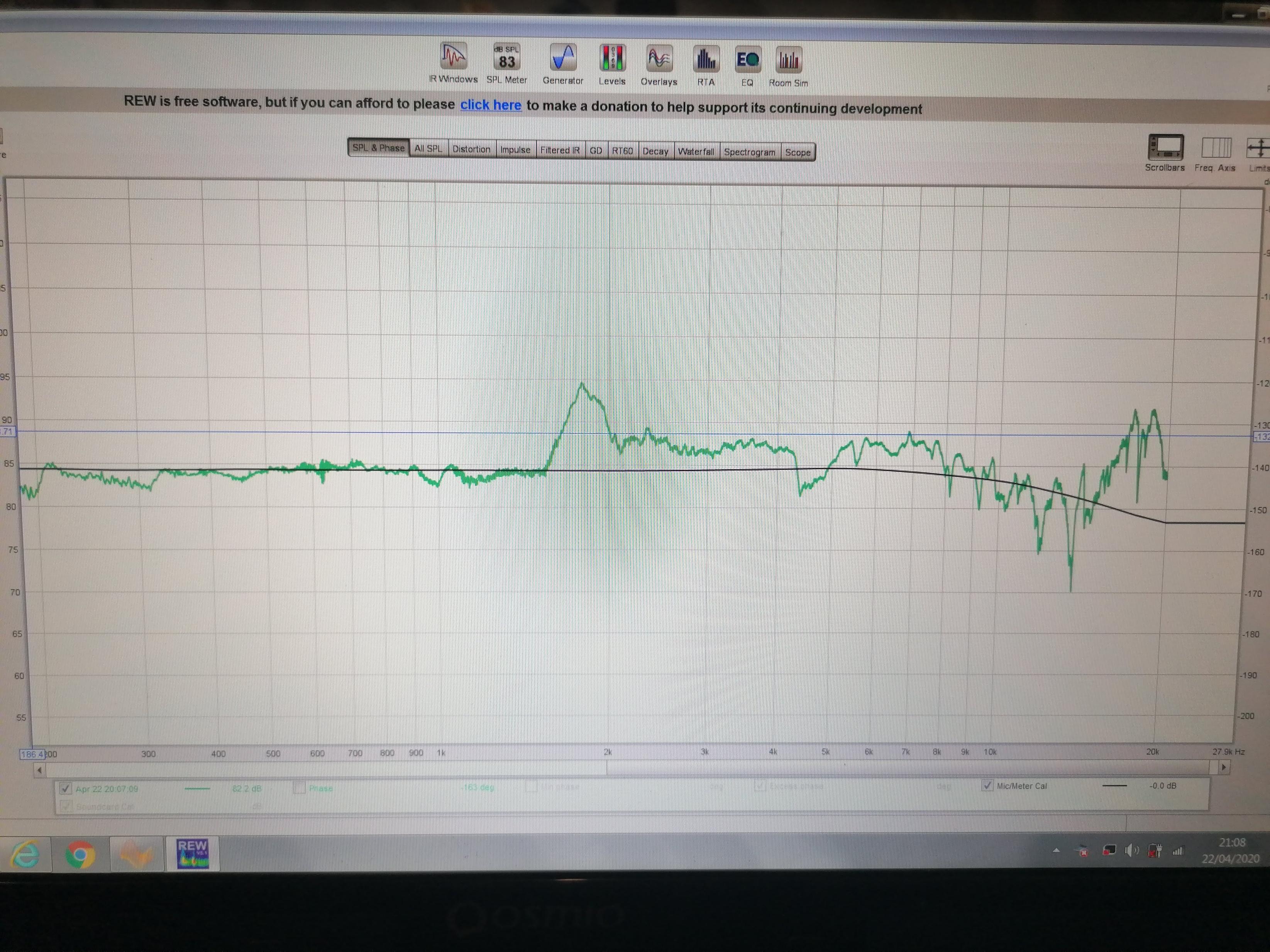

Hello again
I just have to write it because I'm excited again. I have already read through the whole threat, but have not found any clear statements about the stability of the membrane material and its tonal context. Maybe I overlook something?
Once again I built a new membrane. After the theoretical considerations of my posted text, Hiebel's thesis. The paper I use is always 120gsm. Together with the lacquer, about 180g /qm. So far it was a stable printer paper. So I always had a relatively strong increase in the high frequency range. Which can be annoying at times.
Now I use a soft drawing paper with the usual varnish. Actually against my intuitive considerations. The strong increase in the high frequency range is gone and to my surprise the dynamics and the contouring have increased significantly! The fine drawing is phenomenal!
So use the softest paper possible.

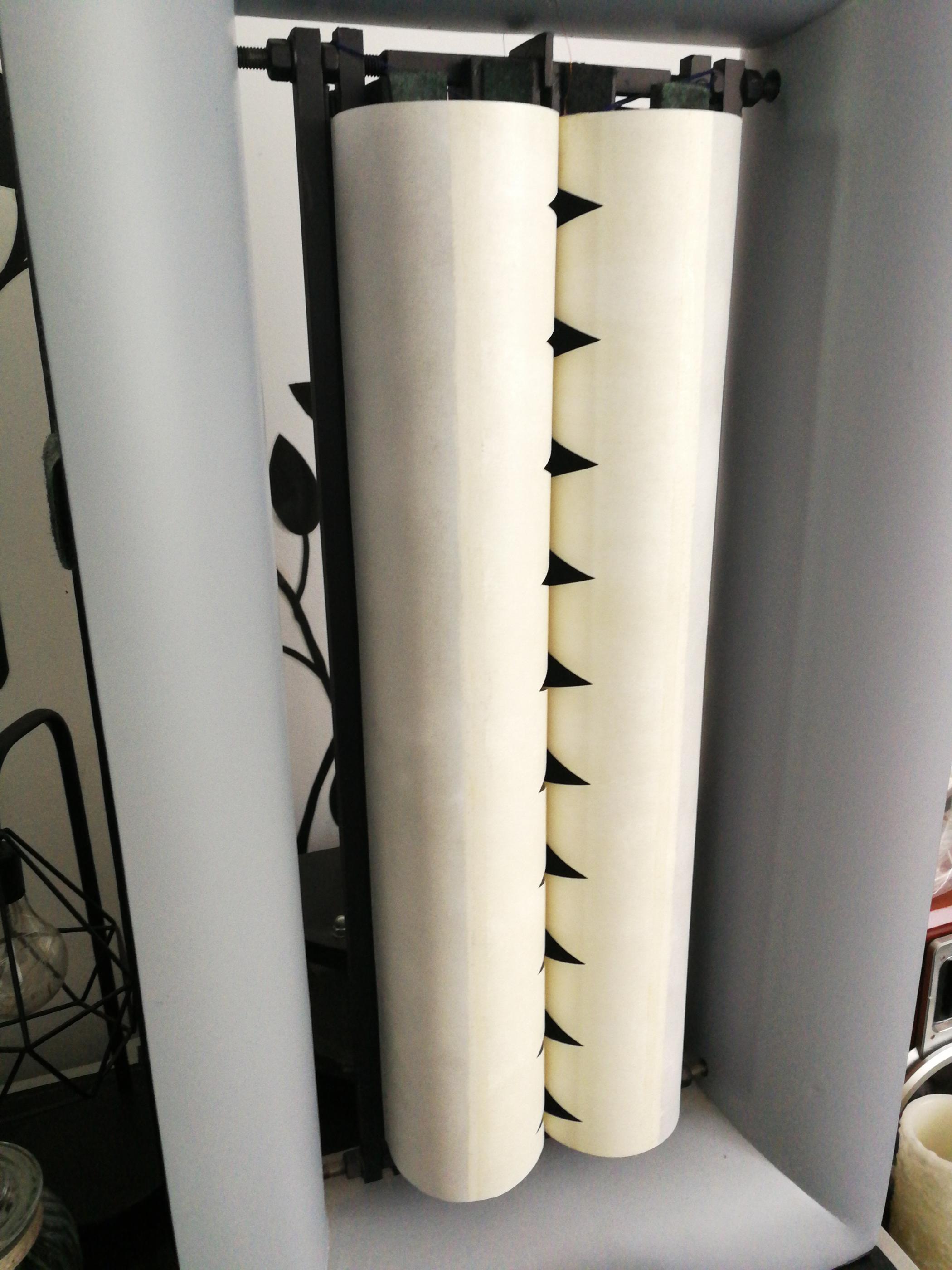

Hello Sergiu Thank you very much for your work, it helped me to move forward very quickly.
At the moment i'm sticking to the new membrane because it sounds very good. It's very cold in my workshop, around 2 degrees Celsius. In spring I will try to build a ruba with only a semicircle, but with a larger radius. The comb filter effects should then get better.
You write about diffusers with a perforated sheet. I also tested this two weeks ago, but was not satisfied with the minor effect. At the moment I am using an acoustic lens, a scattering lens, which is built about 4cm above and 4cm below the height of the ears. So not at the whole height of the 28cm rubas. It'll be better with that. At the back there is also a diverging lens on the whole height.

Your welkome Peril. Acoustic lens i wanted to say but lost it in my brain...
As a colleague of ours tested silk a few pages back and it lowered the distorsions, i wanted to know if someone have tried cottone or rice to see if i should upgrade.
Thanks and keep up the good work.

Hi
I am trying to express myself a little more precisely what I will pay attention to in the future when developing a membrane. As I understand it from Hiebel's thesis. You can limit yourself to pages 108-112. So a summary of three different types of bending wave transducers. Who has the opportunity to read with a translation tool. Difficult to understand and actually against intuition.
If I choose a 120 gram paper, I use paper that is as soft as possible so that there is no excessive increase to high frequencies. Together with the lacquer total weight, 180 grams, I will also choose a particularly soft laquer. If it then sounds too aggressive, an additional layer can be applied laquer. The hardness then no longer increases, but the weight does.
That means you always have to consider the stiffness of the paper with the weight of the paper! If you choose particularly light paper together with laquer, you should expect that the paper will no longer achieve the necessary softness. The lighter the membrane, the softer it has to be. (soft plastic can to be better)
The dimension of the membrane and the cushioning also play a role. You have to experiment. I think that a larger radius makes the membrane as a whole more elastic. The triangles of sergiu make the membrane even more elastic and give further benefits at high frequencies.

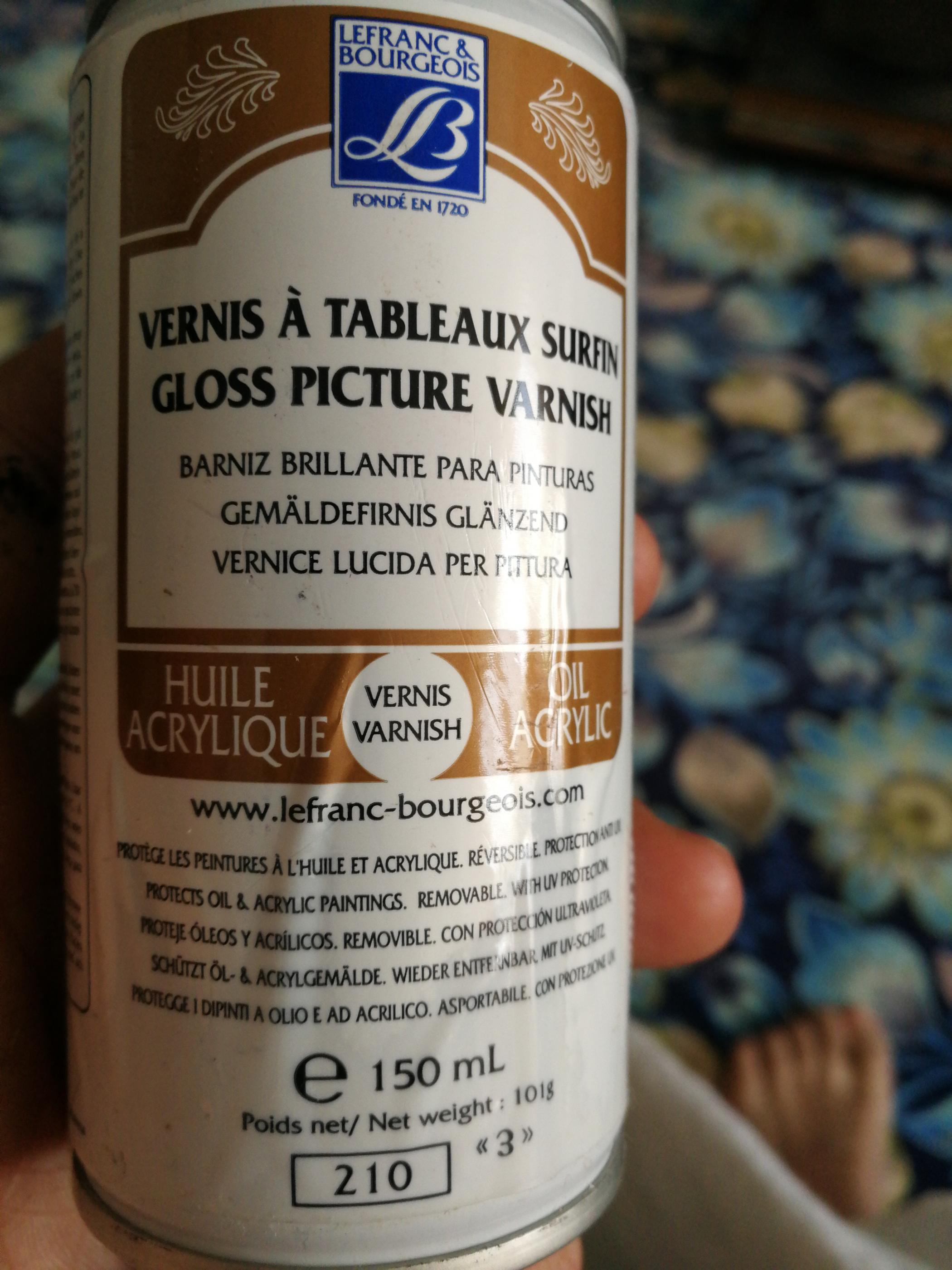

I have tested different types of industriall laq to painting laq and applied it from thin to thick, to small/big/whole area and inpregnated or surface apply only to the surface.
The best to me was laq for winding transformers from a motor winding shop, applied in two thin layers from the center of the coil to 1-2cm further from the axis of the cills for horizontall dispersion, and let the core of the membrane do its job at absorbing peaks and resonances.
Then i use a mix of bees+paraffin wax to stiffen the latteral further as you can see in the pic bellow.
Please show me that sylomer that you use as elastics. I am very curious how they look, as standard elastics tend to brittle and snap.

Thanks for your answer. The Sylomer yellow is one of many possibilities. Diameter approx 5mm. front and back, 6 pieces each. In addition, 2 pieces to pull the membrane up and down. Sylomer is a high tech product and will not show any signs of aging
What could be new for you, at least I don't think anyone did this in the forum, a suspension, beading, surround. the photos are twisted? I've been listening to it for a day. at first you hardly hear a change because it is not so obvious. But it sounds very precise and, above all, it benefits the lower frequencies. Impulses are shorter, possibly a little weaker. Do I have to listen a little longer and change the surround a bit. it may be that the membrane has to be corrected with the laquer.
regards
regards
Dear Peril and sergiu2009, have either of you done a simulation in cad to see the standing waves on the diaphragm? It would be interesting to see/do a comparison between live data and a sim.
Taking it one step further, if you PM the dimensions of your diaphragms, plus the arch dimensions, I can sim them for you?
