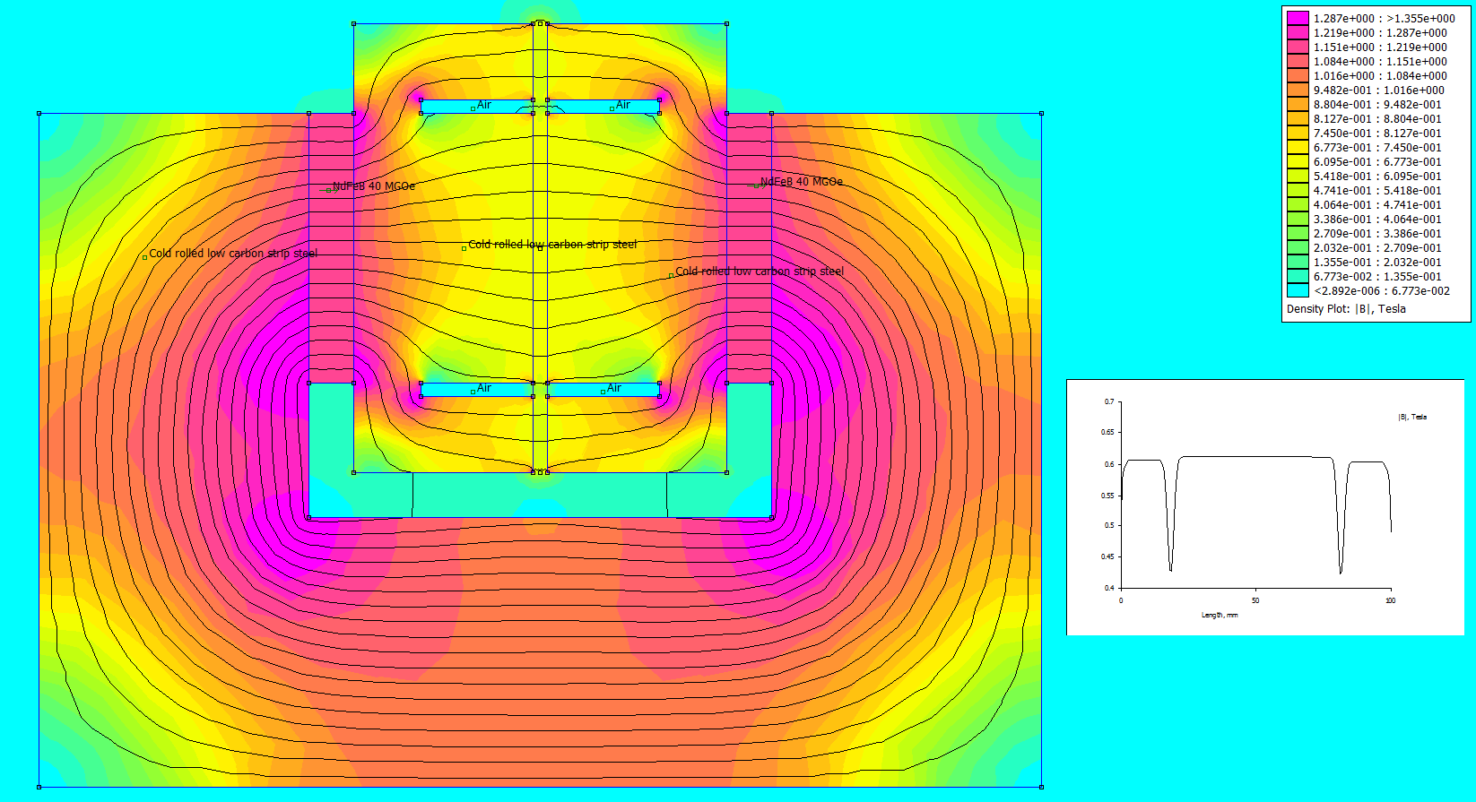

Her my simm. and drawing:
[/url][/IMG]
[/url][/IMG]
2,5 mm gap, and 10x10mm alu 20mm magnet.
App.1T. in gap ,and1,4T in iron.
Bernt

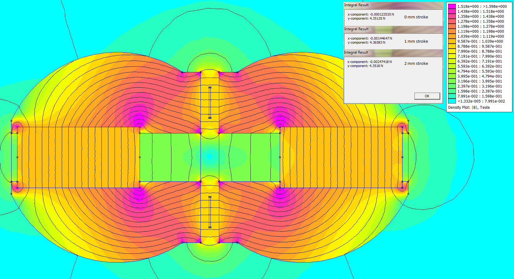

With this kind of configuration:
DMO7GSFoohk1FVCrmSbHrQxZPEL2mm9McHgUrzfSrF0=w639-h415-no
and with N42 and a 3 mm gap I get 1.32 T,
with N52 and a 3 mm gap I get 1.43 T,
R3mcuyq2fvo1seOalYUGEu-DZhlhxFzw2RhxaIVX6hA=w879-h397-no
with N42 and a 2 mm gap I get 1.64 T,
3m77-77ObIH03K429goI8CICnCqi6uxTW-o_Gq-SYMw=w845-h417-no
and with N52 and a 2 mm gap I get 1.76 T.
OKB4nIoNBZM3gxzlzPHxxUoD0nLjx9Rg48SyXGlBnsE=w815-h401-no
Again, easy to simulate but a hell to build: :magnet::magnet::magnet::magnet::magnet:
Also, at these levels, the iron must be more or less carbon free.

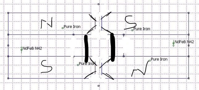

Hi Solhaga,
The design is really interesting. Can you simulate it with steel AISI 1017 please?
The equivallent for this steel in OLC15X. Is steel 1017 good for this aplication?
And how about the modification that i did in the picture bellow so that the gap remains at 3mm but the plates are machined from 10 to 8 mm so that the flux gets increased. I want to try thinner 0.16mm square copper wire (it should ensure only 25w power for the speaker and keep a low mass).
Sorry for my bad talent at painting. :)
I will post this next week from my phone because i'm out of town on a 1week vacation and dont have acces to a pc.
Wrine, my friend, thank you for the sugestion.
Cheers
Sergiu

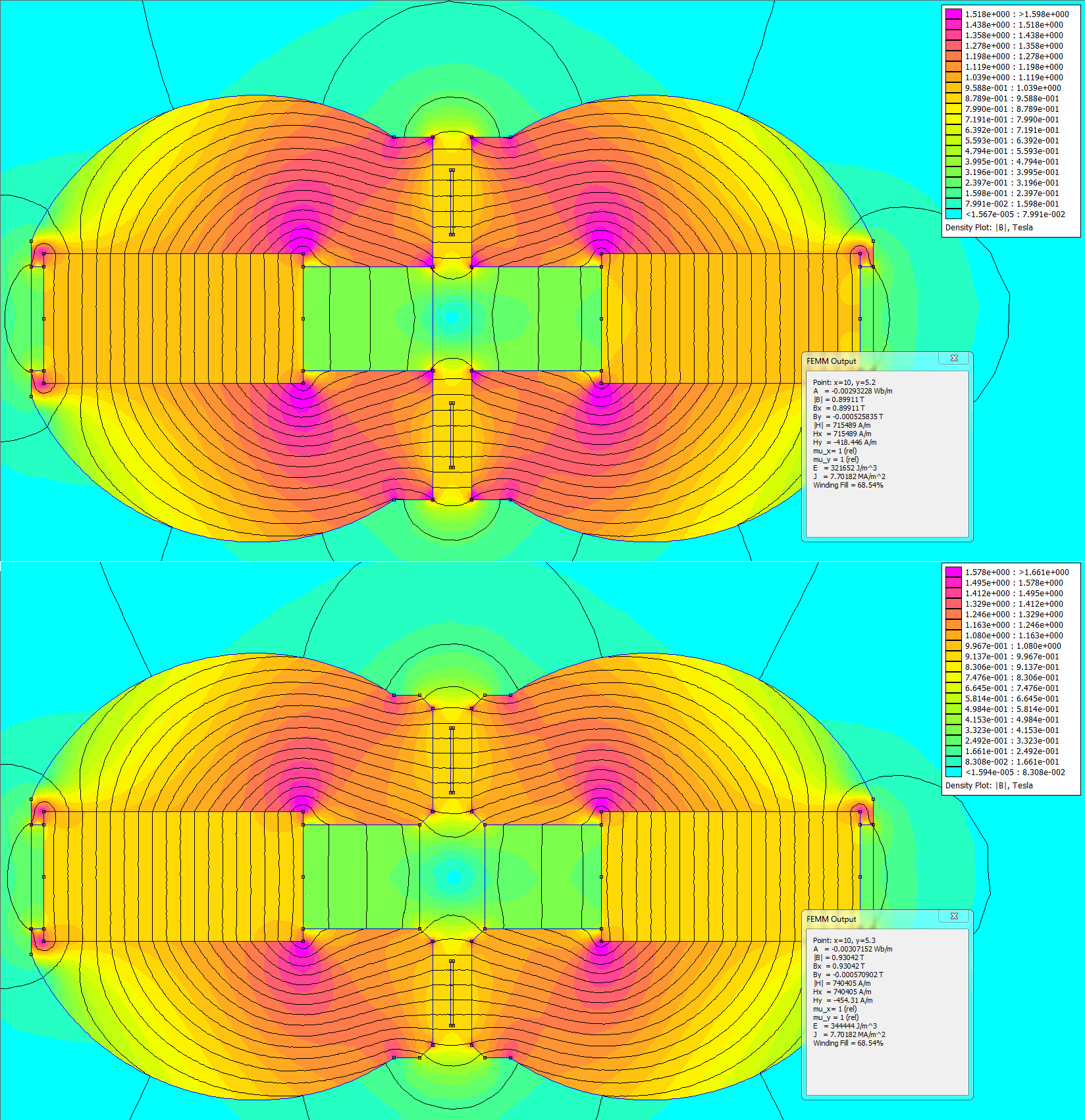

Sorry, I just realized that the Neos only were 30 mm in the simulation.
For the full long side, 40 mm, the configuration will then look like:
OjVFkJSTH3oq2D2CdCl5WE6Jv_wItOho4n0Eiu1W0BE=w691-h399-no
with Pure Iron will have a magnetic flux density of well over 1,6 T
9zMe61v4R1RH8WdZ572pqxUI9_0T6fvx1H_HOjPu72Y=w979-h407-no
and with 1018 Iron it'll still be over 1,6 T.
-N_HczTq-UyOUcKU-tV4r6xnDND8xtYF8608AkEiCGE=w975-h387-no
Didn't have 1017 in my materials library.

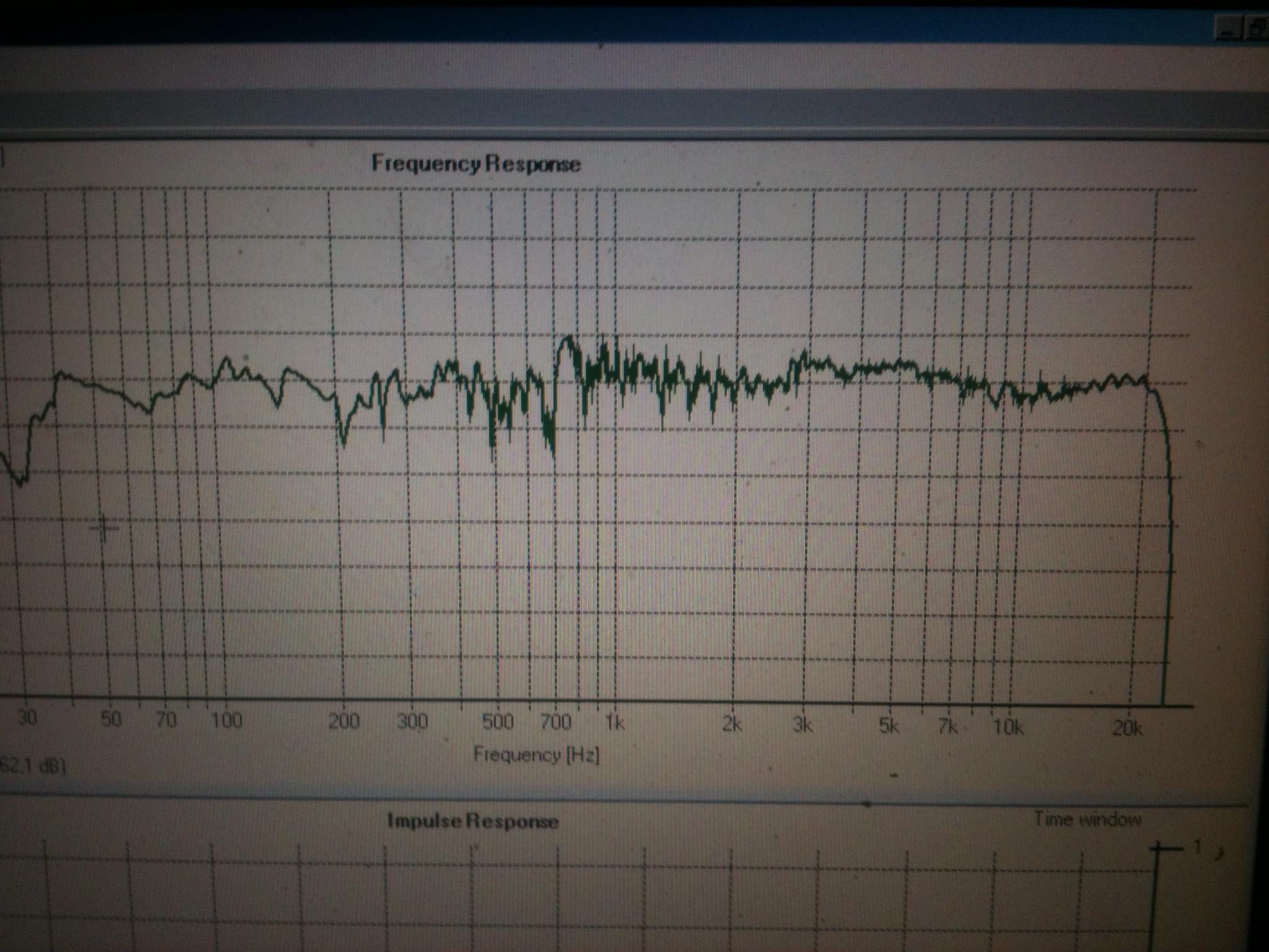

Fast measurement, at 1 meter distrance in my room. its a problem that you cant mic these speakers close since the whole response wil be weird. but its cleary that i get to 20khz :)
and small vid, playing with the woofer beside it crossed at 250hz
http://youtu.be/krOQmN5SY4U
as i recal the company of rubanoide said that the janus did not reach 102 dB and theres reached 100dB. all ok for me :) i can live with 90 or so. wich i dont reach yet. but im close. i think i will go bigger again :) so i can use an a4 size paper standing up. so isntead of 210mm 300mm. it should gain a bit efficiency and should be able to go a bit lower. now it drops at 500hz
If this frequency respons is without filtering, except for the low end, then I will congratulate you with this result!!! :cheers:
According to the specs on the manufacturers websites:
Francois Deminière : 102 dB (janus 50, 70)
Audio Consulting : 103 dB (Dvaijnoy)
AudioNec : 93-96 dB (Diva, Crystal, Response, Reply and Answer)
The last two manufacturers add a supertweeter for the highest end.

Thanks, filtering is a low shelf from 350 hz to boost the low end since i had it crossed at 250.
still looking for improvements in the range around 700 and 3 khz, but what ever i do i cant see to change anything there. normally i hiunt the resonance down, but in this case im a bit clueless.
its to bad that there are no measurements of both the janus and the rubanoide. so its a guessing game
its remarkable how well a totally non flat freq response can sound decent. so i think they keep them for themself

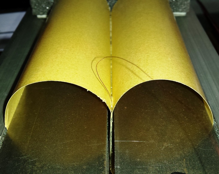

As you see on page 20 of this thread I posted a heavy DSP-ed frequency response. From my experience it sounded more coherent then my unfiltered version.
I am playing now with two models:
1- 300 mm in height with 200 gramms paper
2- 130 mm in height with 60 gramms paper
In the latest model the voice coil is sandwiched between the paper and reinforced with carbon, to keep it all straight in the gap.
The next step is to measure the speed of sound in the paper to cancel out the resonances.

I want to machine the steel on the edges like in the picture bellow so that i reduce the plate from 10 to 8 mm to increase the flux.
How close can i aproach the magnets of the egde of the plates without the aparition of saturation?
Thanks in advance.
Sergiu
Here's your answer:
3% benefit in flux density and 2 mm less lineair excursion.
It's up to you.
Henjo
