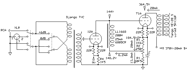

Thanks alot, Sheldon. I really (I mean really really) appreciate your feedback (that goes to all of you).
I think I have all the parts to test the relay setup on the lab at school (including relays), so I can fine tune the circuit before ordering parts. But before I can spend time on the lab, I have 6 exams starting from Monday the 8. of May, and by the time I'm done with that, summer is here. I think chances are I will not make the rewiring to direct coupling before next semester starts in mid August, but by then I should at least have finances for quality PSU iron (lower DCR potted chokes)...
Thanks again so much for all the help, ideas, and suggestions thrown in here. I promise I'll get you updates on the progress, so stay tuned

You're welcome. Just remember I'm a neophyte here too. The test is definitely in order. But maybe you can also entice one of the experienced folk here to comment on the protection circuit. Might be worth posting separately.
Sheldon
