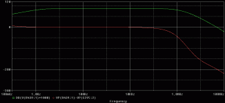

In the attachment is freq response for the rush thing, green is gain in db, red is phasehift. (phasehift minus the phaseshift caused by input filter)

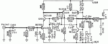

I don't think so, they rather worked hard to get precise riaa correction for phono input.Looking at the design of the NAD3020 circuit I think you can see that the engineers worked hard to get the circuit stable!

That's a clue of big gain stage 😀Looking at the design of the NAD3020 circuit I think you can see that the engineers worked hard to get the circuit stable!

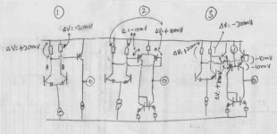

Hi, Christer,
A little miscommunication, you are thinking about Rush Cascode (RC) for input stage, while I'm thinking about RC for VAS stage, but.....
You're right 😀 One thing that I don't realize is that in RC, the dV will be divided for 2 dVBE, because there are 2 BE junctions in series (like in drawing 3, d=20mV will be divided by 2, that is d=10mV for each BE junction in series RC).
It seems the double RC (drawing 3) will have the same gain as drawing 1 (simple CE).
Differential VAS (drawing 2) will have double gain.
PS : Sorry, I'm not EE, I try to understand these things by stone-age iteration. I imagine for full swing, the VAS will have to be driven by dV=20mV. You EE have the simpler way, one word "gm" 😀
So, what is the advantage and disadvantage of Rush Cascode? It don't have current limitation (limited by CCS), bigger transient current capability.
Differential VAS (drawing 2) has good PSRR because it only sense dV, disregarding much of rail ripple.
