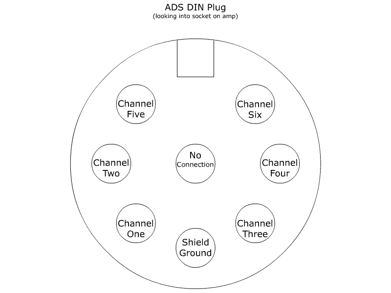

Anyone know where i can get a din to RCA for this amp or any part number so i can make my own?
S S Merlington Member Joined 2012 2013-01-24 1:05 am #1 2013-01-24 1:05 am #1 Anyone know where i can get a din to RCA for this amp or any part number so i can make my own? ••• More options Share P Perry Babin Member Joined 2003 bcae1.com 2013-01-24 7:15 am #2 2013-01-24 7:15 am #2 You'll have to find a DIN plug to fit it. The following diagram is the pin configuration. The 'no connection' pin is used for remote in some plugs but I don't know how many amps use it. Attachments ADS8-pinDIN01.gif 12.9 KB · Views: 64 ••• More options Share Show hidden low quality content Status This old topic is closed. If you want to reopen this topic, contact a moderator using the "Report Post" button.
