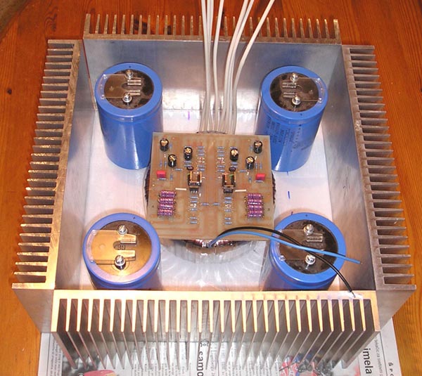

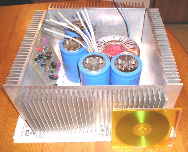

Hmm - tonight I've decided to try figure out with "real" parts ...
First thing was - I've decided to try it out with not so mirrored interior layout as I wanted it till now - and the result is I might squeeze everything into basic a little original A3 look-a-like chassis - so on this picture you can stereo PCB (but I will have to cut it to halfes) and PSU parts ... And a kind of internal layout that would work it out I think:
And view from up - the idea is:
PCB cut to half - so each channel is mounted on one heatsink - in the photo that would be "North" & "West" ones - but transistors would be mounted 3 per heatsink - so I would spread them equally - so there will be some wiring job ...
I have some thought about trannie - probably it would be a good idea to shield it with some "magnetic material" ...
Ofcourse the rear heatsink will have to sacrifice few fins to get place for connectors ...
But for 230V, fuse connector and for power switch I had in mind to place them to bottom - as near as possible to trannie ...
btw - my first plan was to make it with centralized trannie ... But I guess it's better to have capacitors closer than in this case:
