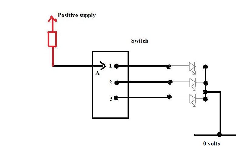

4. LEDs: I was hoping to add input source LEDs up as I have purchase a 4 pole switch. Can you recommend a wiring method for this?
Easy, you wire the spare "wiper" of the switch via a resistor to the positive rail of the amp (choose to give around 10milliamps for starters... depends on the LED's). You can discount the LED volt drop, so the resistor is Vsupply/0.010 in ohms. Each pole of the switch then goes to an LED and the LED cathodes are all tied together and returned to ground. If it's to bright increase the resistor. Many modern LED's are bright at under 1 milliamp so you will have to experiment to see what suits you.
I agree with Mooly, except the LED detail.
I would try starting at 2mA for brightness.
It is far easier to add resistor in parallel than try to snip and add a resistor in series. Just leave the resistor leads on the back side slightly long. These can be used to attach and detach an extra parallel resistor.
The formula becomes LED resistor = [Vsupply - Vled] / 0.002 ohms
eg Vsupply ~10V
Vled ~1.9V
Resistor value = [10-1.9] * 500 = 4050ohms, use a 3k9 or 4k3

For the LED:
Sounds like its fine to draw power from V+. Should I do this as a spice in the wire? Maybe this will become clear when I get all the components in front of me.

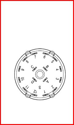

Is the wiper you refer to just another one of the tabs? There are four per selection and I was thinking three would be in, out and ground.
So would I be taking a wire off V+ running it to the spare pin, running a wire from that to a resistor to the LED for that input and then a wire from the LED to the ground.

This is the switch I am using
CK1457 6.35X20.7MM 4PL 3 POS FLAT SHAFT Lorlin Rotary Switches

Switch... use your meter on ohms to identify the connections, a 4 way switch will have A,B,C,D "wipers" as shown and a 3 way, AB and C only.
Your link is to a four pole 3way switch :) is that what you want ? or do you want a 3 way 4 pole ? First will allow you 3 audio inputs, the second 4.
so anyway A and 1 connect and B and 4 and so on.Move the switch round a stop and it's A and 2 and B and 5 and so on. The 3 way will only have A,B, and C the 4 way will add another "D"

Would my wiring diagram work for this? I'm no electrical engineer but it seems like the negative terminal of the LEDs need to connect back into the circut.
Thanks again for your help and patience
Administrator
Joined 2007
The LED's are wired like this using any of the 4 ways available eg A and 1,2,3,4 or D and 9,10,11,12 etc.

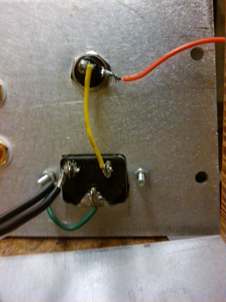

3. One more quicky. I have and IEC plug, fuse holder and switch. Would the order be (from main in). IEC plug, fuse holder, switch, transformer or IEC Plug, Switch, fuse holder, transformer. The switch is 20A rated.

3. The fuse holder first, then the switch. That way you also have protection, if a wire comes off the switch.

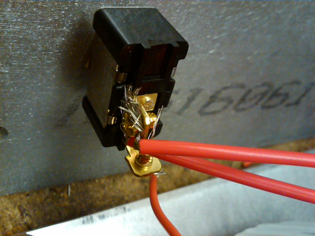

So I've started my construction and finished the case today.
I've put together the amp up to hooking up the power supply board to the transformer. I turned it on and the LED (located on the circuit board) did not light up I began trying to check voltages of V+ and V- when I heard a loud pop. I quickly turned the amp off and found that a diode had broken.
What might have caused this? I feel like I did everything to this point correct but places I was a bit uncertain:
1. Hooking up to the Power Inlet plug. I went hot on the right side connector (looking at it from the side to witch it is soldered).
2. The LED may have been backwards.
I dont know what happened but its a major bummer and a bit frightening.
Administrator
Joined 2007
Think we need to see a picture... can't tell from description other than to say you have made some error somewhere.
Using a bulb in series with the mains saves major explosions and damage like this if you are unsure something is going to work.
If you have the circuit you are using showing the diode and it's location that would help too.

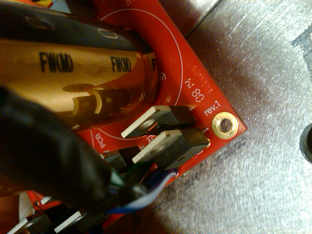

you forgot to take the bulb tester off the shelf.
Use the bulb tester for every new mains powered project and re-use it every time you modify or add anything to a project.
I always start by testing the transformer wiring, before I connect up the rectifier.

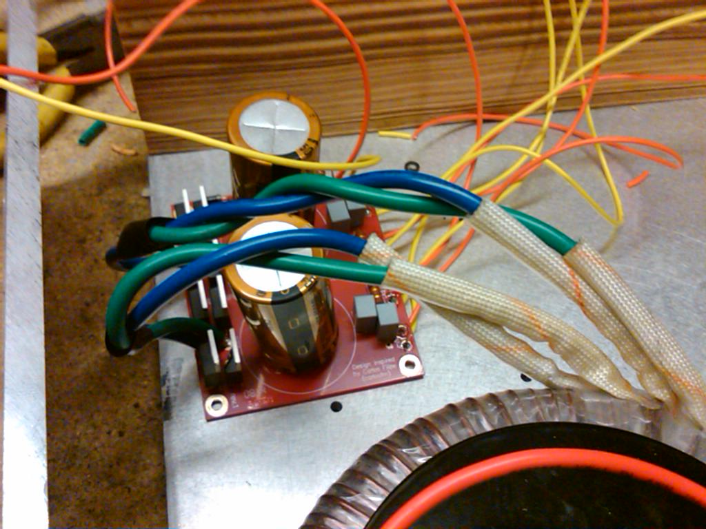

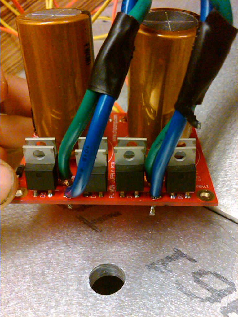

I have attached some pictures hopefully you can make heads or tails of them.
First is a picture of the mains plug area, second the switch in which the orange wire is that coming off the fuse holder in pic 1. Next two show my circut and boards and the last shows the diode. All of the orange and yellow wires were hooked up ahead of time and dont lead anywhere. I was just thinking that since I did have the board on risers yet it might have cause a short with the base.

Administrator
Joined 2007
Is that a bit of burn on the base next to the rectifier (3rd piccy) ? Did it touch ?
Replace the diode/s check them all, then power up with a 60 watt bulb in series with the mains and make sure it's OK.
If so remember to discharge the caps via a resistor afterward (1 to 10 k 1 watt)
That wiring does look a bit scary :eek:
I don't know if this applies but> Rather than wiring up everything and crossing fingers, you have more success by building and testing things in a logical sequence. XFMR > PS AC and DC > AMP DC conditions and offset > amp AC gain and freq response> thermal loading > etc
Firstly a dry run to get everything situated mechanically ie PCBs on standoffs, XFMR mounting. After the dry run, sometimes it makes sense to power things up sequentially separate from the chassis so most problems can be sorted out before permanent tidy wiring is done.
Identify power wiring and signal wiring and use appropriate gauge wires for each.

The wiring is a bit scary becuase I was just attaching it to the switch before mounting it to the panels. It will be fixed once the thing is done.

Finished the amp today. Thanks for all the advice I think I must have caused a short by letting it sit on the base. I still have the light bulb in and it lights up when the amp is turned on briefly and then throughout songs it gets brighter when the song gets louder. Is this normal and is safe to take out?
