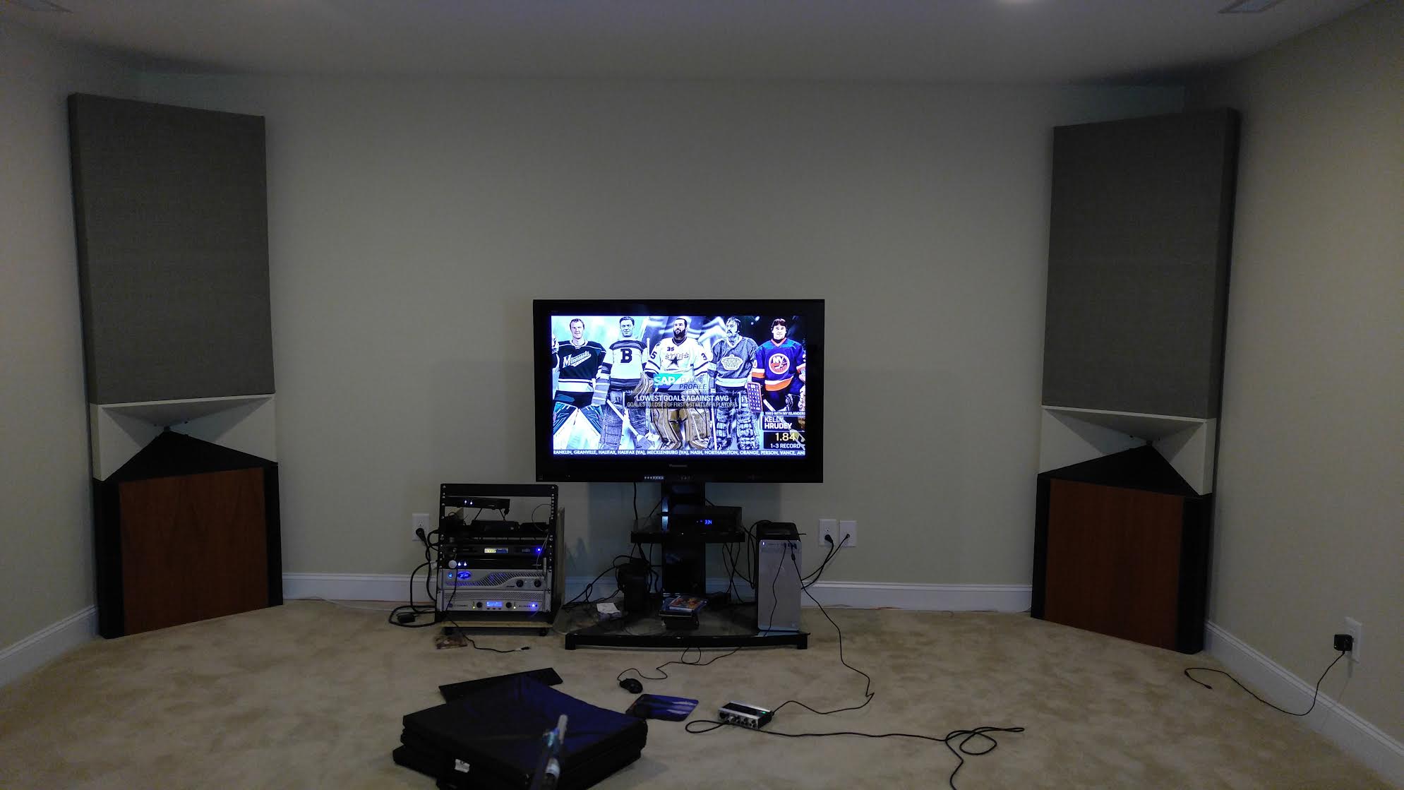

Putting the horn in the corner totally eliminates wall reflections but ceiling and floor have to be dealt with.
I chickened out on a 2nd bass bin sitting on to top of the Synergy so I didn't get to the array bass point. I feared for my back at the thought of putting it in place and then that it might not stay there.
Just having the woofer close to the floor for 300 Hz and down helps enormously. And it turned out I need the space above the horn for bass traps to attenuate longitudinal modes.
I think the should a Murphy's kind of law for room acoustics: there is always one more reflection or mode to be dealt with.
Where have we seen this before ?
nice setup, but did those "bass" traps actually attenuate any bass reflections ?
Not completely but adequately, I think. Of course more absorption would be better. TDA 3D graphs posted here

interesting . thanks for posting. surprisingly it does help a little even at lower frequencies.

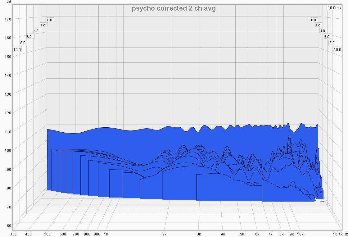

You can't run APL_TDA yet, can you? In that case a waterfall plot with these settings would be interesting, as measured at the listening position:
A spectrogram (and/or wavelet) showing the first 30 ms would help too.
I'd like to see the first ~ 30 to 50 ms of the filtered IR too (in dBFs to see levels of reflections and decay), and an IR up till ~20 ms. Just to compare these two different methods.
The frequency response curve filtered with a FDW of 1/6 oct showing phase would help too. And a left/right FR curve of each method to show the balance.
I could think of more things to look at but these will get us started by looking at possible differences in these plots. We may need to dig deeper.

To get closer to real life sounds I wanted to try this. Not with headphones but with a stereo setup that has good imaging already. I was expecting imaging differences and even improvements. I was wrong there, there weren't much clues where it helped in imaging. However due to the array nature of my speakers I had a phase bend at ~150 Hz, right where the Impedance peak is. Sound was a little slower there. Fixing that gap was a noticeable improvement, more fun with kick drums! Keeps you on your toes kind of sound.
In pictures that sort of looks like this:
An APL plot without any FIR correction at all:
See how the sound is late between 100-200 Hz, not even building up yet? It's "less than" 15 ms.
After the "fix" things start to look different:
The build up on the left side is still smooth, no early sound, lets move the peak right a bit:
Don't mind the slight ridge you see in both corrected plots . This just means I didn't align the microphone perfectly between both speakers. You'll see they are happening at slightly different frequencies as these were two separate Stereo measurements.

The most meaningful difference here for me is the balance differences.
It does not seem like much, but it is happening over a wide area.
The Psycho version could seem more detailed because of the higher high frequency balance.
This can be seen in all graphs in a direct comparison.
I'm still liking the 4 cycle correction but would tweak it, not your goal obviously.
I do expect you could better each one if you look for parameters that fix the 2.7 bump. As can be seen the ERB correction does some of that correction, but dip limiting does not allow to fix it better. I do believe that part to be easily improved/fixed with min phase PEQ. So DRC should be able to do a little better and remove the excess ringing (it's most probably driver related). Even though this is 2 channels average I expect to see something in both single driver graphs indicating a driver issue. If it would not be at the same spot in both measurements the averaging should have averaged it out of the sum.
As said, balance would be the biggest noticeable difference. Room for improvement in both. Not by lengthening the correction, but by optimising settings. I'm only looking at 2K+ in the waterfall plots.

Look at the waterfall plots again. One of them is cleaner, the other is less clean but more balanced. How are we going to know how our brain figures out what's happening?
