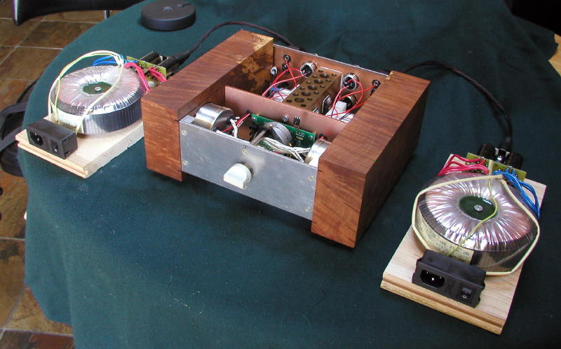

For the interested, here is some photos of the transformer connected to my testbed setup:
The transformer dimensions are 12.5cm diameter x 5cm height.
